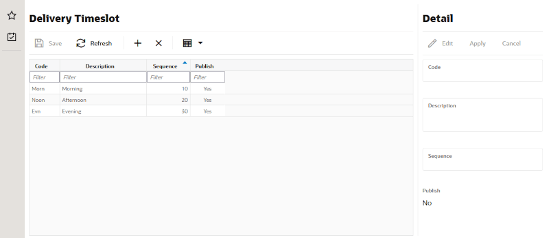

Delivery Timeslot
Figure 4-2 Delivery Timeslots
The Delivery Timeslot screen is an administrative screen for the creating, editing and deleting of delivery timeslots to be used within the system. The timeslots are used within store orders. The screen is accessed from the Admin/ Data Setup menu, the user must have proper permission. Upon initial install, a list of default delivery timeslots will be available. The delivery timeslots defined here need to match that of the merchandising system, they are not integrated between the two systems.
Each delivery timeslot will require the user to give it a unique alphanumeric code. A description is also required to describe the delivery timeslot. A sequence needs to be assigned, which will be used to give an order to the delivery timeslots when populated on the store orders UI. Lastly, there is a publish indicator that will define if the delivery timeslot on the actual store order is published.
Once a delivery timeslot is created it is saved and it can be edited with the exception of the code, which is not editable. Delivery Timeslots can also be deleted, as long as it is not attached to a store order.

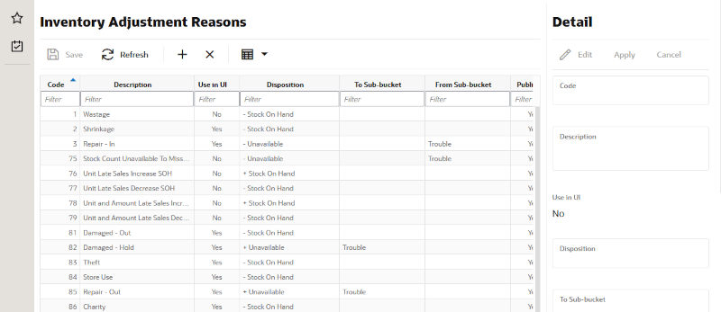

Inventory Adjustment Reasons
Figure 4-3 Inventory Adjust Reasons
The Inventory Adjustment Reason screen is an administrative screen for the creation and maintenance of inventory adjustment reason codes to be used within the system. The reason codes are used within inventory adjustments. Upon initial install, a list of default inventory adjustment reason codes is available. The reason codes defined here need to match that of the merchandising system.
The following table provides the list of Inventory Adjustment reason codes:
Table 4-3 Inventory Adjustment Reason Codes

All reason codes have a disposition associated with them. The disposition is used to define the direction of stock movement for the adjustment. The following table lists the available dispositions:
Table 4-4 Available Dispositions
| Display Value | Stock Movement |
- Stock On Hand |
Decrease Total SOH Decrease Available SOH |
+ Unavailable |
Decrease Available SOH Increase Unavailable SOH |
+ Stock On Hand |
Increase Total SOH Decrease Available SOH |
- Unavailable |
Increase Available SOH Decrease Unavailable SOH |
+ Customer Order Reserve |
Decrease Available SOH Increase Customer Order Reserve |
- Customer Order Reserve |
Increase Available SOH Decrease Customer Order Reserve |
- Stock On Hand and - Unavailable |
Decrease Total SOH Decrease Unavailable SOH |
-Unavailable and + Unavailable |
Decrease Unavailable SOH Increase Unavailable |
Those reason codes that have the Use in UI indicator set to 'Yes' appear as reason codes in the Inventory Adjustment dialog.
System reason codes cannot be removed and can only have the description edited. System reason codes are those used within the system for making stock on hand updates, for example, Stock Count-In which is used within stock counts.
These are not considered inventory adjustments as the stock count itself represents the transaction of the change.
If the system is configured to use sub-buckets, then the sub-buckets are enabled. Sub-buckets are linked with the inventory adjustment reason codes to make it easy for users to move inventory to, from, and between sub-buckets when adjusting unavailable stock. An example is stock reserved for display or demonstration purposes versus stock that is unavailable because it needs to be repaired. A sub-bucket is a pre-populated list which is defined in the database.
If using sub-buckets, all reason codes that have a disposition which is "to unavailable" stock require a "to sub-bucket" to be selected. Those reason codes that have a disposition which are from unavailable stock require a "from sub-bucket" to be selected.
Note that the -Unavailable and + Unavailable is a disposition used for those retailers that are configured to use sub-buckets. It allows movement of inventory from one sub-bucket to another only within the inventory system. The inventory stays within the unavailable bucket. These adjustments are not published.
The Publish indicator is used for integration purposes. If this check box is checked, the adjustments associated with that reason code are published upon completion of the adjustment. This indicator can only be modified for those reason codes which are normally editable (non-system reason codes). All reason codes installed on setup have this indicator checked, meaning they are published.
A common use of the Publish indicator is the support of initial inventory position seeding from the merchandise system during implementation. Inventory adjustments may come to the inventory system (through a web service) and then updates the inventory per the adjustment; the adjustments do not get published out to the external system per the Publish indicator. Also, the Publish indicator can be used to update inventory positions, from the inventory system, in a custom RMFCS or third-party implementation to synchronize both inventory positions with the corporate system.

System Reason codes cannot be edited or removed. System reason codes are required to be available for use in the system. These values are populated upon install and the system check box is only checked during that process. For those non-system reason codes, once the reason code is saved, only the description can be edited.
If the system is configured to use sub-buckets, then the sub-buckets field will be enabled. Sub-buckets are linked with the shipment reason codes to make it easy for users to move inventory to, from, and between sub-buckets when adjusting unavailable stock. Some examples of these are stock reserved for display or demo purposes versus stock that is unavailable because it needs to be repaired. Sub-buckets can be setup and maintained within the Sub-buckets dialog.
If using sub-buckets, all reason codes that have an inventory status of unavailable will require a sub-bucket to be selected.
Before a reason can be accessed, it is important to associate that reason code to a role that you has the privileges to use in that store.

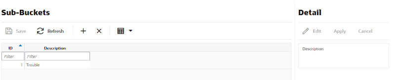

Sub-Buckets
Figure 4-6 Sub-buckets
The Sub-buckets screen is an administrative screen for the creation and maintenance of sub-buckets to be used within the system. They allow for breaking down the unavailable (non-sellable) inventory bucket further into smaller buckets or what we call sub-buckets.
The system is configurable to use sub-buckets. If the system is configured to use sub-buckets, they will be available within Inventory Adjustments, RTVs, and Transfers. Sub-buckets are attached to reason codes that update unavailable inventory. The reason codes would be either inventory adjustment reasons or shipment reasons. When you use the reason code on a transaction, the system updates the proper sub-bucket associated with the reason code.
Sub-buckets can be added, deleted and edited via this dialog. Sub-buckets will have a system generated ID along with a user defined sub-bucket description.
Sub bucket id for 'Trouble' is predefined in the system when the system is deployed.

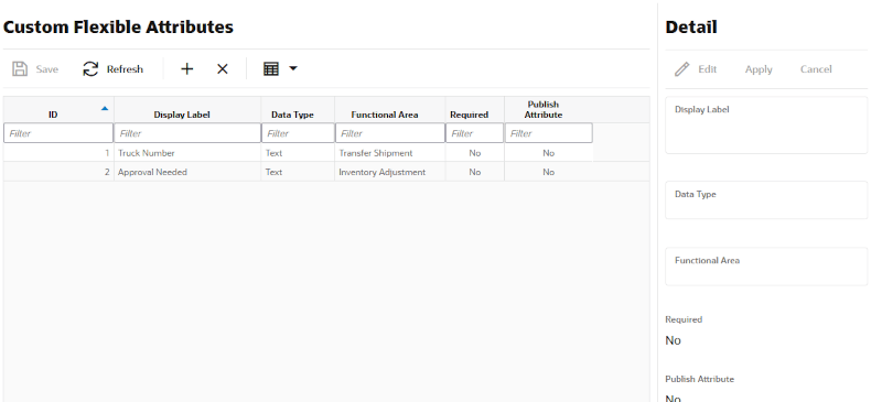

Custom Flexible Attribute
Figure 4-7 Custom Flexible Attribute
The Custom Flexible Attributes screen is an administrative screen used to set up and maintain transaction-level flexible attributes. The Functional Area drop-down menu determines the mobile application area in which each Custom Flexible Attribute will be available. The available functional areas include:
Customer Orders
Customer Order Picking
Customer Order Reverse Picking
Customer Order Delivery
Transfer Document
Transfer Shipment
Transfer Shipment Container
Transfer Receive
Transfer Receive Container
RTV Request Approve
RTV Shipment
RTV Shipment Container
Stock Count
Stock Count - Recount
DSD - PO, DSD - PO & ASN, DSD - On the fly
DSD Container
Replenishment Pick List, Scan List, Shelf Adjustment
Item Basket
Item ISN
Store Order
The flexible attributes set up here will be available on the Information screens in the mobile application for the respective transactions, where users can enter values for these attributes. To access a Custom Flexible Attribute (CFA) in a specific functional area of the mobile application, the user must have the appropriate data permission for that CFA functional area. Appropriate permissions are also required to access, edit, and delete flexible attributes in the setup screens in the desktop application.
Flexible attributes can be configured using the following data types: Text, Date, Decimal, Long, and Drop Down.
The Text, Decimal, and Long data types also allow users to set minimum and maximum values for these flexible attributes that can be entered in transactions in the mobile application.
The Drop Down data type has an additional screen, Drop Down Values, where the selectable values displayed in the drop-down list are defined. See the details below.
The retailer also has the flexibility to set up certain flexible attributes as editable. The Editable indicator must be set to Yes for the attribute to be editable in the functional area; otherwise, it will be read-only. In addition, an attribute can be defined as mandatory. This requires the user to specify a value for the attribute before confirming the transaction in the mobile application.
Lastly, the retailer can also configure certain flexible attributes to be published to external systems upon completion of a transaction in the functional area. This is defined using the Publish Attributes indicator. If this indicator is set to Yes, the system will publish the attributes and the Publish Value. The Publish Value is an optional six-character code or value.
The Publish Value and Editable indicators are both editable for existing attributes. All other fields are editable when creating a new attribute.
It is possible by design to set up a CFA that is required but not editable. This may result in scenarios where the user is unable to enter the CFA in the UI of the functional area and is therefore unable to complete the transaction. In this case, the CFA must be populated via a REST API in order for the transaction to be completed.

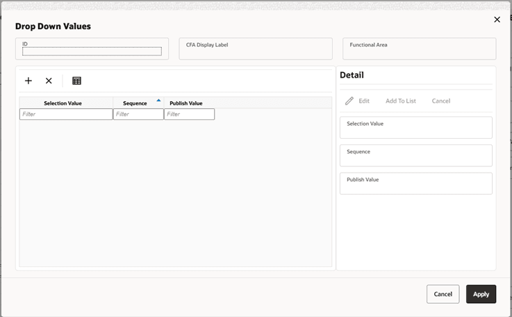

Figure 4-8 Drop Down Values (Drop Down Data type)
The Drop Down Values screen is accessed via the Drop Down Values button on the Custom Flexible Attributes screen for attributes with the Drop Down data type. It is used to define the selectable values for the attribute drop-down list. For each value displayed in the list, the user defines the Selection Value, Sequence, and Publish Value.
The Selection Value is the text displayed in the list. Sequence is used to define the order in which the value is displayed. The Publish Value is an optional six-character code or value. It is published when the attribute’s Publish Attribute indicator is set to Yes and that selection value is selected in the drop-down attribute within the functional area.
Drop Down data types are currently available for the following functional areas:
- Transfer Document
- Transfer Shipment
- Transfer Shipment Container
- Transfer Receive
- Transfer Receive Container
- RTV Shipment
- RTV Shipment Container
- DSD – PO
- DSD - PO & ASN
- DSD - On the fly
- DSD DEX/NEX
- DSD Container
- Customer Order Delivery

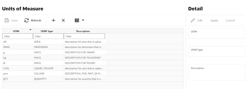

Unit of Measure
Figure 4-9 Unit of Measure
The Units of Measure screen is an administrative screen for the creating, editing and deleting of Units of Measure to be used within the system. The screen is accessed from the Admin / Data Setup menu, the user must have proper permission. Upon initial install, a list of units of measure will be available.
Each Unit of Measure record will require a UOM, which is the alphanumeric code to identify the unit of measure. The code is what is displayed on the UI. It does not need to be unique. Next a UOM type is assigned to the Unit of Measure, this is selected from a list which is hard coded in the system, that is, 'VOL' or 'MASS'. Lastly, the unit of measure needs to have a description to describe the UOM.
Once a unit of measure is created it is saved and can be edited with the exception of the UOM code, which is not editable. Unit of Measures can also be deleted, as long as it is not being used by an item or a transaction in the system.
UOM codes need to match those in external systems to ensure correct processing.
The following UOMs will NOT allow for decimal values when being used in the system: EA, DOZ, DPC, DPR, HND, HUN, JR, K, NO, PC, PCS, PRS, THS.

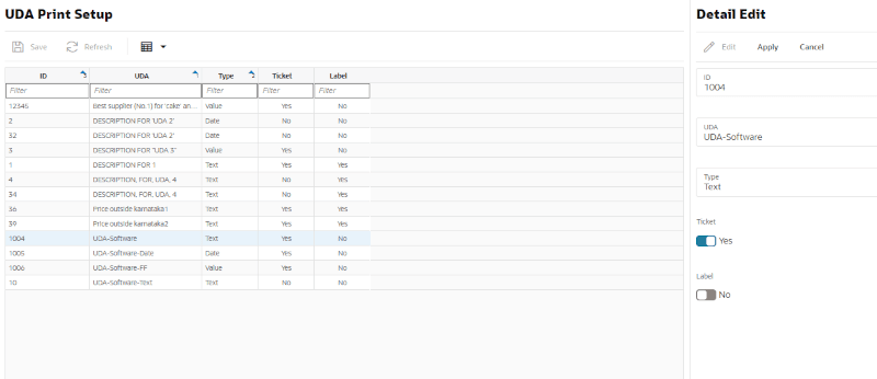

UDA Print Setup
Figure 4-10 UDA Print Setup
The system can automatically generate tickets and labels for items when user-defined attribute (UDA) values change. The UDA Print Setup function allows you to define whether new tickets or labels, or both, should be printed automatically when a particular UDA values change.
User can access the dialog from the desktop application by selecting the menu Admin/Data Setup/UDA Print Setup. These print settings affect all stores because user-defined attributes are not specific to stores. This function is only available to users with the required permissions
To control whether tickets or labels are printed automatically when a UDA changes, select the UDA and edit to switch on/off the printing Tickets and Labels. When an item has a changed UDA, the system will generate ticket or label or both for that item based upon the setup on this screen.

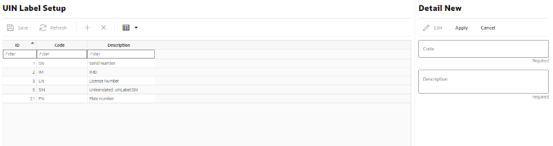

UIN Label Setup
Figure 4-11 UDA Label Setup
The UIN Label Setup screen allows the user to set customized name for the UIN. The UIN Label is used for displaying on various screens and report in the application, this may include Serial Number, IMEI, SIN, License Number, Part Number, and so on. It is accessed by Admin / Data Setup / UIN Label.
On this screen, the user can add the new Labels for the UIN and provide the description. The code entered here must match the one that is coming from the external system for correct processing.
Once the new UIN label is created and saved, the system identifies the label based on the code and uses it in the application.
