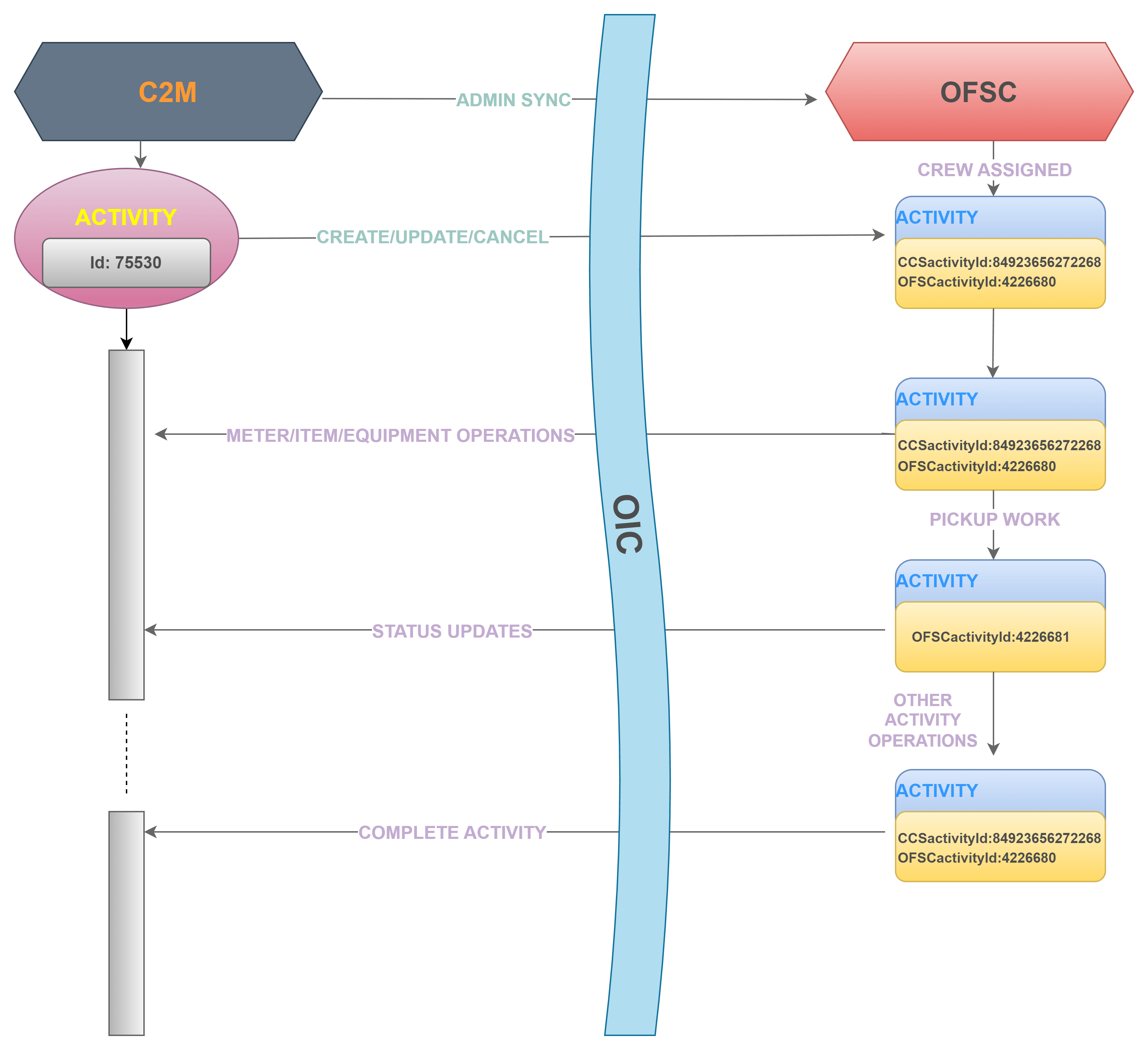

Assigning the Activity to Crew

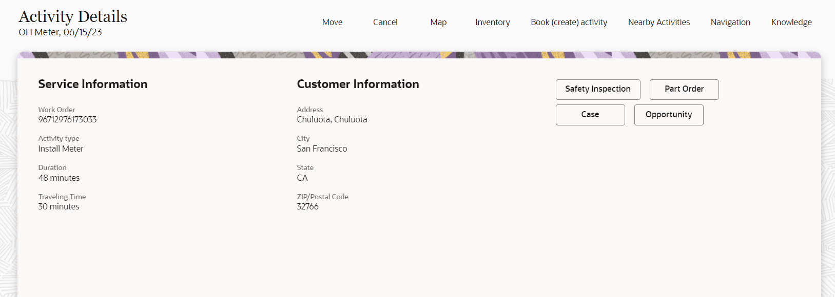

For further processing, the work activity created in Oracle Utilities Customer Cloud Service is sent to the default bucket configured in Oracle Field Service. In return, Oracle Field Service sends a success or failure acknowledgement to Oracle Utilities Customer Cloud Service. Through Oracle Utilities Customer Cloud Service ActivityID we can identify the activity in the Oracle Field Service dispatch console. The dispatch console is used to monitor the field and assign activities to technicians/crew based on their work skills.
In the dispatch console, click the activity to view the Activity Details screen. It displays activity information, including service information such as activity type, activity duration, and customer information.

After assigning an activity to the crew, it is presented to the mobile user in read only mode in Oracle Field Service mobile. To enter service histories, crew needs to activate the route and start the activity. However, crew can add service point details, perform device verification, and upload attachments without starting the activity. But then, only these details are sent to Oracle Utilities Customer Cloud Service after starting and completing the activity successfully.

Crew can create an unrelated pickup work which invokes the Create Activity flow from Oracle Field Service. To create a new activity, crew needs to identify on top of which service point the activity has to be created. When crew enters the service point details, a Service Point Query flow is invoked that verifies and fetches the service point details from Oracle Utilities Customer to Meter/Oracle Utilities Customer Cloud Service. In addition, crew can create a new activity on top of the selected service point.

After completing the activity, the following details are sent to Oracle Utilities Customer Cloud Service to trigger complete the event in Oracle Utilities Customer Cloud Service:
• Service history details added at all levels
• Attachment details
• Customer signature as an attachment
• Completion status
• Time taken to process the activity (activity duration)
Completion events are used to capture closeout information against activities received from an external application. To confirm if an activity process is successful or not, check the completion event status in Oracle Utilities Customer Cloud Service.Shows the completion event status in Oracle Utilities Customer Cloud Service.
