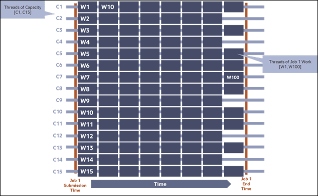

It is common practice today for jobs to be submitted with the expectation that immediately after submission each thread of work is matched to a free thread of capacity, the threads run for some time and then after the last thread completes then the job is completed. Consider the diagram below which illustrates the coarse-grained submission of two jobs ("Job 1" and "Job 2") followed by descriptions of common difficulties associated with this type of submission.
Figure 3-1 Coarse-Grained Submission - Two Jobs
Diagram illustrating the coarse-grained submission of two jobs
Difficulty #1: Delayed Job Completion from Thread Throughput Imbalances
In this example, Job 1 is submitted with a thread count of 10. Notably, thread #6 of Job 1 contains a unit of work labeled "State U" representing some unit of work requiring far more time to complete than other units. The name is chosen in reference to accounts often related to universities which can be particularly complex. Correspondingly, this complex unit of work causes thread #6 to finish at a time much later than the other threads and hence the completion time of the overall job is delayed while waiting for that single thread. Any jobs depending on the completion of Job 1 are likewise delayed.
Similar difficulties although usually of a lower typical impact arise because a particular thread of capacity runs on a computer suffering greater resource contention (such as network, CPU) than other computers and therefore the thread of work finishes later than others which causes the overall job to finish later.
The root of the difficulty is that each thread of work has committed itself to run on a single thread of capacity throughout the duration of the job. Hence no rebalancing of the workload is possible once the job starts.

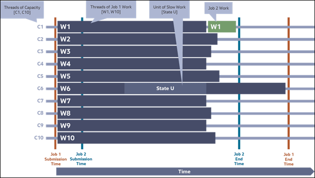

Difficulty #2: Resource Starvation
Consider Job 2 in the diagram which was submitted a short time after Job 1 was submitted. Despite Job 2 having only one thread of work and running comparatively quickly, Job 2 is blocked from running for a long time. Only when a thread of Job 1 completes can Job 2 run at all. This is an example of the well-known challenge in task processing systems, the problem of "resource starvation."

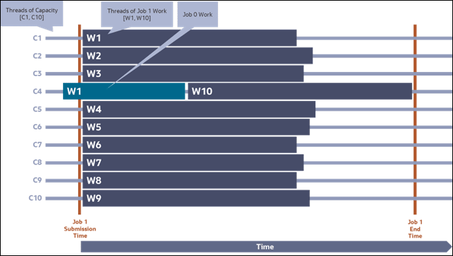

Difficulty #3: Delayed Job Completion from Thread Capacity Shortfall
Consider Figure 3-2 in which an already running job (Job 0) is utilizing one thread of capacity when the parallel job (Job 1) is submitted. Because the single thread (W1) of Job 0 makes one thread of capacity unavailable the result is that the overall completion of job 1 is delayed for the full duration of this capacity shortfall. Coarse-grained job submissions are often incapable of handling thread capacity shortfalls without delays to job completion time.

Diagram illustrating an already running job (Job 0) utilizing one thread of capacity when the parallel job (Job 1) is submitted.

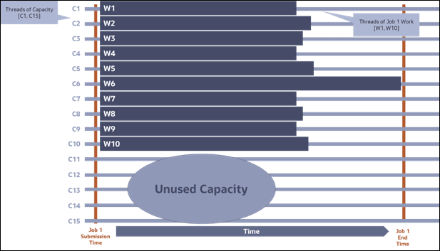

Difficulty #4: Unused Capacity
To avoid difficulties #2 and #3 and to make possible the scheduling of other types of jobs along with parallel jobs like Job 1 it is common to lower the thread count of jobs like Job 1 such that spare capacity is maintained. However, as Figure 3-3 below demonstrates this leads to unused capacity which might otherwise be used to lower the completion time of Job 1.

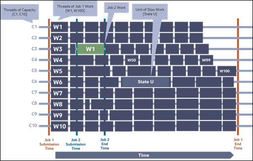

Let us get started by reimagining Job 1 being submitted with 10x more threads of work than described in the coarse-grained submission discussion. Instead of Figure 3-1 we would expect the following scheduling behavior:
Figure 3-4 Fine-Grained Submission
Diagram illustrating the fine-grained submission of two jobs
Solution #1: Delayed Job Completion from Thread Throughput Imbalances-Solved by Queue-based Load Leveling
Note in Figure 3-4 that Job 1's overall completion time is considerably shorter than in Figure 1. While the "State U" slow unit of work is still slow, its effect on overall completion time is mitigated by the fact that the thread of capacity ("C6") on which the slow work is scheduled performs fewer threads of work than other threads. For example, while thread of capacity C6 completes 6 threads of work, thread of capacity C7 performs 11 threads of work. In essence, the well-behaved workflows around the poorly behaving work. Threads of capacity capable of performing more work receive more work to do while threads of capacity unable to complete work quickly are assigned less work. This behavior is the essence of what is known as "queue-based load leveling".
Note that is possible to construct scenarios where problematic work like "State U" happens to fall among the last threads of work scheduled (such as W100). However, it can be shown via statistical means that under most situations the queue-based load leveling shown here has far superior results than displayed by the coarse-grained thread scheduling.
Solution #2: Resource Starvation-Solved by Queue-based Load Leveling and Fair Task Scheduling
Note in Figure 3-4 that Job 2 starts processing and completes much sooner than in Figure 3-1. That is, we do not see Job 2 exhibiting resource starvation. This owes to two reasons:
  1. Because of queue-based load leveling a thread of capacity becomes available to schedule Job 2 much earlier than in Figure 3-1. In figure 3-4 thread of capacity C3 completes two threads of work for Job 1 and then is available to schedule a thread of work from Job 2.
  2. Because of fair task scheduling job 2 is guaranteed to receive some service (that is, have some threads of work scheduled onto threads of capacity) based on a fairness policy implemented in the batch processing framework. The fairness policy balances highly served jobs like Job 1 against minimally served jobs like Job 2. These policies are both powerful and configurable and will be discussed more in more detail later.

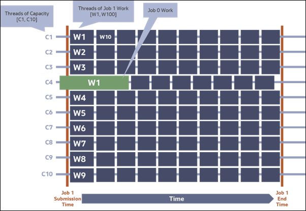

Solution #3: Delayed Job Completion from Thread Capacity Shortfall-Solved by Queue-based Load Leveling
Please consider Figure 3-5 and note that unlike Figure 3-2 that a thread of work from another job (Job 0) does not unreasonably extend the completion time for the newly scheduled Job 1. Rather, queue-based load leveling causes the impacted thread of capacity (C4) to preform less work (6 threads of work) relative to the other threads of capacity which process as many as 13 threads of work.

Diagram illustrating an impacted thread of capacity caused to preform less work relative to the other threads of capacity

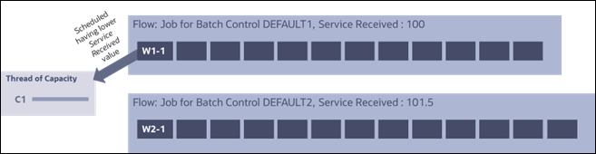

Consider Figure 3-7 below which shows that among two flows, batch jobs running batch controls DEFAULT1 and DEFAULT2, that a free thread of capacity is scheduled work from the flow having the lowest value of service received (100 vs. 101.5).

Diagram illustrating two flows, and that a free thread of capacity is scheduled work from the flow having the lowest value of service received

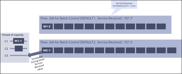

After some time, another thread of capacity becomes available to execute a thread of work. However, since work W1-1 from flow DEFAULT1 has been executing for some time, now flow DEFAULT2 has a lower value of service received. Therefore, work from flow DEFAULT2 is scheduled. Over time, each flow will receive approximately the same service because scheduling is performed from the flow having the lowest value of service received.

Diagram illustrating two flows when more capacity becomes available

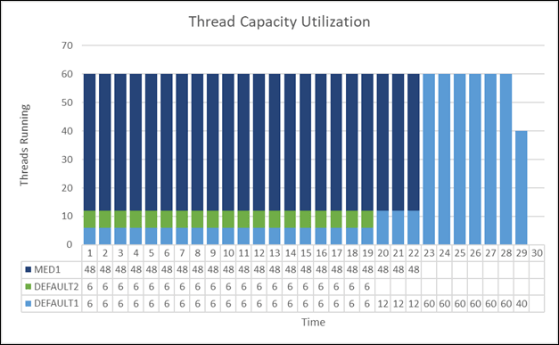

The following figure (3-10) conveys how the three jobs might receive service over time assuming that the environment is entitled to 60 threads of capacity.
  • While running, the MED1 job receives four time the service as the two other jobs combined (jobs DEFAULT1 and DEFAULT2) since the latter jobs are part of the default resource group but the former job (MED1) is part of the "Priority 20 (Medium)" resource group having four times greater weight.
  • Within the default resource group, the DEFAULT1 and DEFAULT2 jobs receive equal service while they both run.
  • When job DEFAULT2 finishes then the remaining job in the default resource group (DEFAULT1) receives all the service for the resource group which continues to be four times less that the "Priority 20 (Medium)" resource group job MED1.
  • When MED1 completes then the remaining backlogged work for job DEFAULT1 utilizes all threads of capacity until completion.
