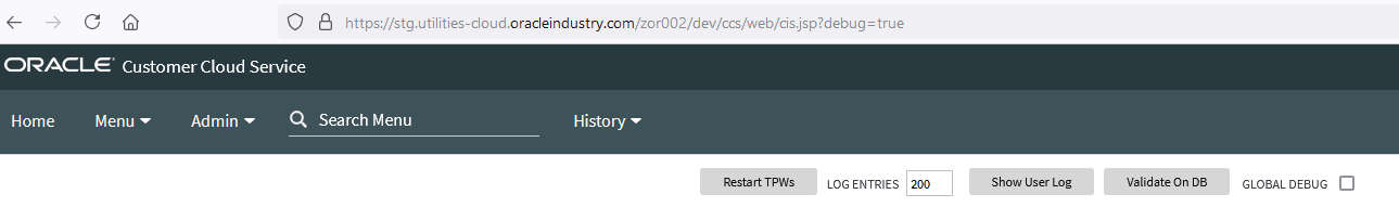

Q4) I have submitted batch online and the batch job submission still shows batch status in Pending?
There could be several reasons for this situation:
  • All available threads in the TPW are currently busy with another job. To check for this, go to the Batch Queues page and verify if any running jobs.
  • The TPW may have been (or need to be) restarted because of a previous problem. If already Restarted, your job should start within minutes. Note that the Restart action takes a bit of time because it may need to interrupt running jobs, cleanly shut the batch server pods down, then start them up again. In order to restart, please run the application in debug mode where TPW restart option is available (as seen below).
    Figure 10-7 Debug Mode
    Screen capture showing application in Debug Mode
  • Check the desired execution date/time, it should not be in future.

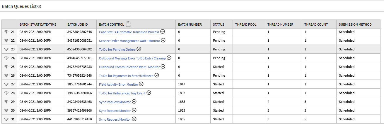

Q6) I want to submit a batch, but I don't know what batches are currently running?
To check this, go to the Admin → B → Batch Queue Portal page and verify if any running jobs. If you see batch jobs already showing in pending status that means you have consumed all the available threads allocated and no capacity available to submit any more batches.

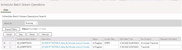

Q7) How do I cancel jobs submitted by SaaS Batch Scheduler?
A Scheduler Batch Stream executes the batch controls in defined chronological order, and it creates batch job submissions with the submission method "Scheduled". Batch job submission with this status can not be canceled through the cancel option on batch job submission page. In order to cancel the Scheduler Batch Stream, you have to go to Scheduler Batch Stream Operations portal page, then select the running stream and perform cancel operation. This will result in canceling the overall stream including current running batches.

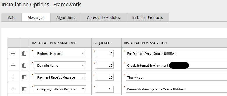

Q9) I am getting batch completion emails from multiple environments, Can i get environment name inside the email contents?
Yes, implementations can add a "Domain Name" Installation Message type (on the Messages tab of the Installation Options-Framework portal) and provide the description that identifies the environment. That description will be part of the email received as part of batch completion as well as on the application interface.
Figure 10-10 Installation Options - Framework portal
Screen capture showing the Installation Options - Framework portal
Above is the Installation Options - Framework list of Messages - add a unique value for "Domain Name" in each environment where batch is running.

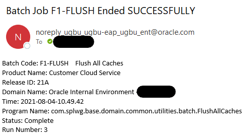

Figure 10-11 F1-FLUSH Batch Job
Screen shot showing successfully completed F1-FLUSH batch job
Above is a sample batch notification email showing the Domain Name ("Oracle Internal Environment").

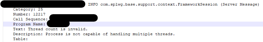

Q10) Can I run any job with many threads?
No, not all jobs support multi-threading. Most Batch Controls will indicate if they support it or not. If the work to be done can be cleanly divided, then multi-threading is available. There are some jobs that take a 'set-based' approach which need to run with a single thread.
If the batch control does not support multi-thread and related to upload / download and you submit the batch with more than one thread, only one thread will process, rest of the threads will start and complete immediately without process any record.
If the batch control does not support multi-thread and not related upload / download, you may see the following error in the log:
