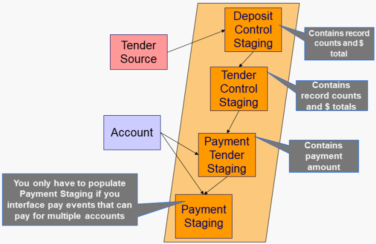

Process X - Populate Payment Upload Staging
Process X refers to the mechanism used by your organization to populate the various staging tables (shown in the orange section of the following ERD).
Deposit Control Staging
You must create a deposit control staging record for each batch of payments to be uploaded into the system. The name of this table is CI_DEP_CTL_ST. The following table describes each column on this table.

You must create one or more Tender Control Staging for this deposit control staging record.
You must create at least one tender control staging record for each batch of payments to be uploaded into the system. The name of this table is CI_TNDR_CTL_ST. The following table describes each column on this table.

You must create one or more Payment Tender Staging records for this tender control staging record.
You must create at least one payment tender staging record for each payment associated with the tender control staging record. The name of this table is CI_PAY_TNDR_ST. The following table describes each column on this table.

Payment Staging
You need only populate rows on this table if any of the following conditions apply:
- If you need to distribute a payment tender to an account other than that defined with the CUST_ID on the payment tender staging record, you must create a payment staging record. You may distribute a tender to multiple accounts by creating multiple payment staging records. Note, if you want to distribute the payment tender to the same account, you do NOT need a payment staging record.
- If you want to restrict a payment to a specific service agreement, you must insert a row on this table to indicate the specific the service agreement in question. You do this by populating MATCH_TYPE_CD with a value that indicates that you are paying for a specific service agreement and MATCH_VALUE with the unique ID of the service agreement.
- If you practice open-item accounting, you must insert a row on this table for each to indicate the open-item to which the payment should be matched. Note, because open-item customer typically match payments to bills, you would populate MATCH_TYPE_CD with a value to indicate that you are matching by bill ID and MATCH_VALUE with the unique ID of the bill.
The name of this table is CI_PAY_ST. The following table describes each column on this table.
