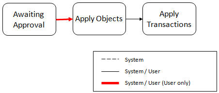

Migration Data Set Apply Lifecycle
A monitor algorithm (executed by the data set monitor batch process) on the Apply Objects state checks to see if all migration objects are no longer Approved or the count of records in Error Applying does not exceed a configured limit. If so, it automatically transitions the record to the Apply Transactions state.
If the number of objects in Error Applying exceeds a configured limit, the monitor algorithm does not automatically transition the record. In that case, a user must determine if the large number of errors can be resolved or manually transition to Apply Transactions (despite the large number of errors). The Resolving Errors section below describes alternative steps that the user may take if there are errors.
