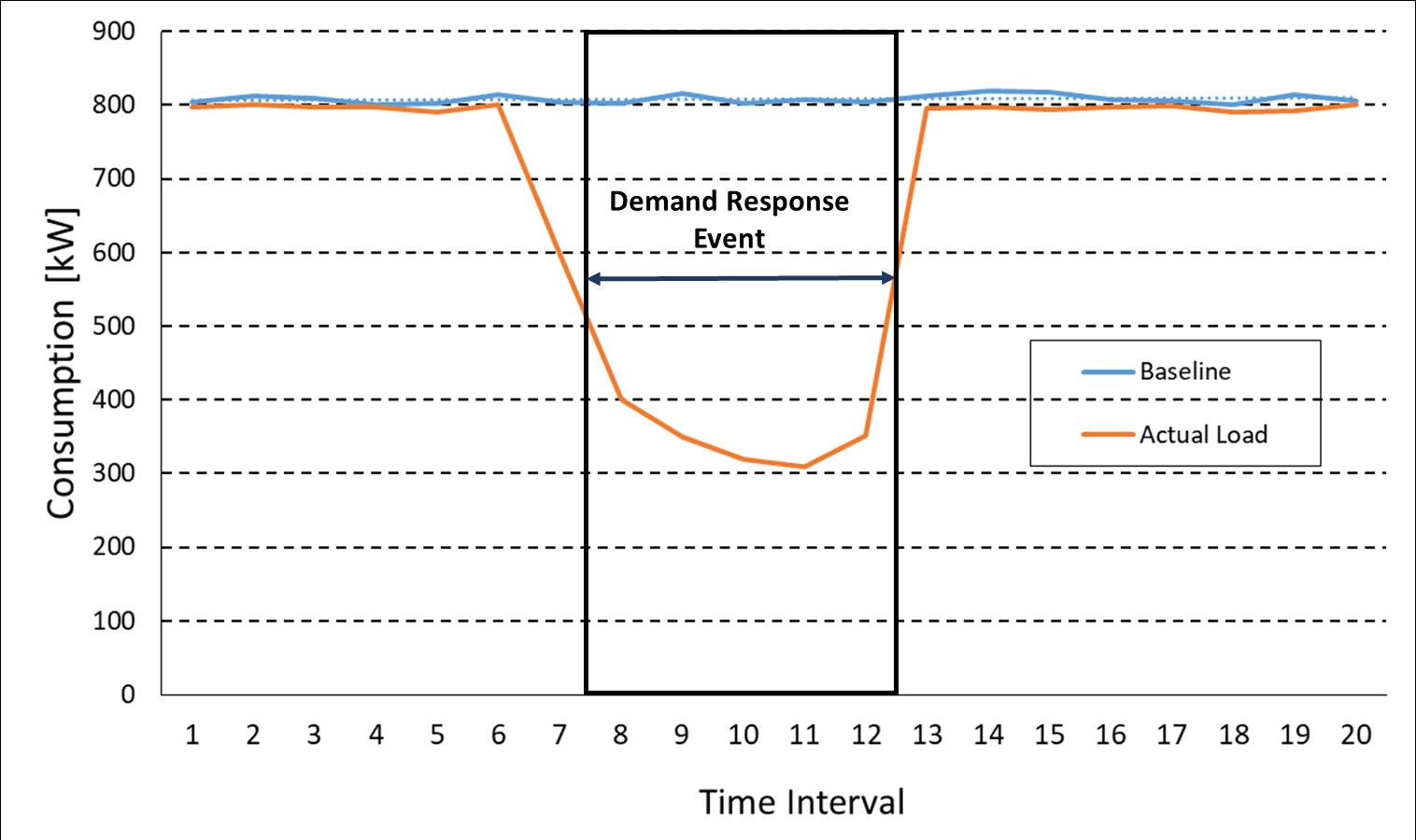

This rule is used to estimate the electric consumption a customer would have used had they not participated in a program event, which is used to calculate reductions in consumption or demand for use in program event settlement transactions that represent credits or changes that will be applied to a customer's bill based on participation in an individual event. This done by calculating a "Demand Response Customer Baseline" or baseline that represents this estimated consumption. The figure below shows a baseline compared to actual meter data and depicts how they can be compared during an event to calculate the reduction.
Graph depicting comparison of baseline consumption to event consumption
