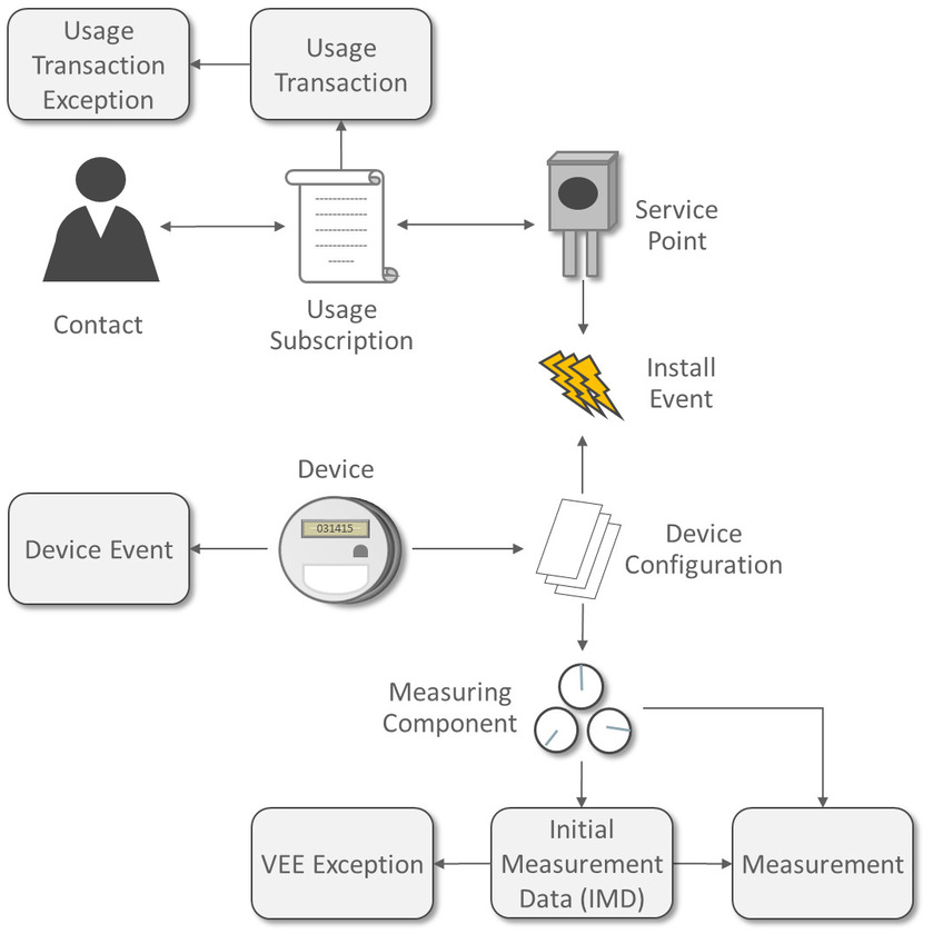

Measurement, VEE, and Usage Calculation for Billing
Diagram that illustrates the relationships between entities in the system, incuding Contact, Usage Subscription, Service Poiint, Install Event, Device Configuration, Device, Device Event, Measuring Compoint, Initial Measurement Data, VEE Exception, and Measurement.
A Device represents a physical meter, communication module, or some other device in the field. A Service Point is the point where service is delivered to a customer and a device can be installed. The Install Event is a record of a specific device that is installed at a Service Point. A Contact is the customer that is associated with the Usage Subscription.
In order to properly track the way that a device is configured, the Device Configuration keeps a record of which types of data should be measured for the device. A Measuring Component represents a single channel of data for a device; for example, a device may have multiple measuring components: one that represents kWh interval data, another that represents kWh scalar readings, and a third that registers Voltage interval data.
Energy data received from meters is initially stored as Initial Measurement Data (IMD). Once the VEE process is executed, if the data passes then Measurements are created. If the data fails, however, then VEE Exceptions are created.
A Usage Subscription tracks a set of usage calculations that should be performed for a single or multiple Points. In order to perform calculation of usage (often referred to as bill determinants), a Usage Transaction is created through a request from the billing system. If any issues are encountered in the usage calculation process, or from a usage transaction validation, then Usage Transaction Exceptions are created.

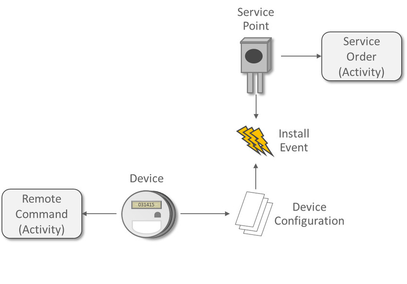

Service Orders and Remote Commands
Diagram that illustrates the relationships between service order and remote command entities in the system, incuding Service Poiint, Service Order (Activity), Install Event, Device Configuration, Device, and Remote Command (Activity).
An Activity in Oracle Utilities Meter Data Management is a very flexible object that is used for various processes. Two of the key processes handled by Activities are:
  • Remote Commands involve communicating with a Head End system to perform actions or retrieve data from a meter; for example, remote connects, remote disconnects, and on-demand reading.
  • Service Orders are methods where work can be performed at a Service Point; for example, enabling service, disabling service, and meter exchanges.
