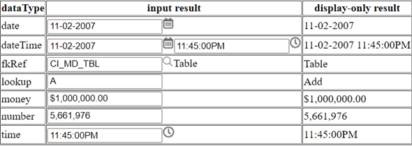

Format Input and Output Fields
The following attributes are designed to apply data type formatting for input and output fields.
Automatic Formatting
Syntax
oraSchemaDataTypes="false"
This attribute is used to trigger automatic formatting in the rendered HTML document. The automated formatting will occur according to the data type attributes defined in the UI map's schema. For details on specific data type formatting, please refer to the oraType attribute descriptions below.
WARNING:
The attribute oraSchemaDataTypes="true" will be automatically injected into the UI map's HTML! If you do not wish to apply the schema's data types to the rendered HTML then you must specify this attribute in the body node with a value of false. The attribute <body oraSchemaDataTypes="false"> is required to avoid automatic formatting!
  • UI Map schema:
    <schema>
        <schemaDate dataType="date"/>
        <schemaDateTime dataType="dateTime"/>
        <schemaFkRef fkRef="F1-MOTBL"/>
        <schemaLookup dataType="lookup" lookup="ACCESS_MODE"/>
        <schemaMoney dataType="money"/>
        <schemaNumber dataType="number"/>
        <schemaTime dataType="time"/>
    </schema>
  • UI Map HTML:
    <html>
    <body oraSchemaDataTypes="true">
    <table border="1" cellpadding="1" cellspacing="1">
       <tr><th>dataType</th><th>input result</th><th> display-only result</th></tr>
       <tr>
          <td>date</td>
          <td><input oraField="schemaDate"/></td>
          <td><span oraField="schemaDate"></span></td>
       </tr>
       <tr>
          <td>dateTime</td>
          <td><input oraField="schemaDateTime"/></td>
          <td><span oraField="schemaDateTime"></span></td>
       </tr>
       <tr>
          <td>fkRef</td>
          <td><input oraField="schemaFkRef"/></td>
          <td><span oraField="schemaFkRef"></span></td>
       </tr>
       <tr>
          <td>lookup</td>
          <td><input oraField="schemaLookup"/></td>
          <td><span oraField="schemaLookup"></span></td>
       </tr>
       <tr>
          <td>money</td>
          <td><input oraField="schemaMoney"/></td>
          <td><span oraField="schemaMoney"></span></td>
       </tr>
       <tr>
          <td>number</td>
          <td><input oraField="schemaNumber"/></td>
          <td><span oraField="schemaNumber"></span></td>
       </tr>
       <tr>
          <td>time</td>
          <td><input oraField="schemaTime"/></td>
          <td><span oraField="schemaTime"></span></td>
       </tr>
    </table>
    </body>
    <xml>
    <root>
       <schemaDate>2007-11-02</schemaDate>
       <schemaDateTime>2007-11-02-23.45.00</schemaDateTime>
       <schemaFkRef>CI_MD_TBL</schemaFkRef>
       <schemaLookup>A</schemaLookup>
       <schemaMoney>1000000</schemaMoney>
       <schemaNumber>5661976.11548</schemaNumber>
       <schemaTime>23.45.00</schemaTime>
    </root>
    </xml>
    </html>
    HTML rendered.
    HTML rendered for oraSchemaDataTypes="yes"

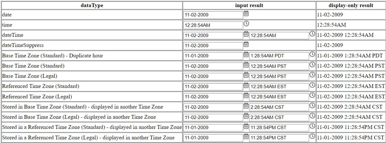

Date and Time Formatting
Syntax Valid Values Description
oraType="date"
  This function is used to display a date according to the user's display profile. For input fields, the setting formats the data when the user tabs out of the field.
oraType="time"
  This function is used to display a time according to the user's display profile. For input fields, the setting formats the data when the user tabs out of the field.
oraType="dateTime; time:suppress"
  This function is used to display a timestamp according to the user's display profile. If this function is used for an input element, it is broken into two pieces, one for date and one for time. Optionally, the time portion of the date time element can be suppressed using the attribute value 'time:suppress'.
oraType="dateTime; stdTime:true;"
  This function is used to render a date / time element that is stored in standard time according to the daylight savings time schedule of the 'base' time zone. The 'base' time zone is specified on the Installation table and represents the database time zone.
For input elements with this setting, all time entered is assumed to correspond with the daylight savings time schedule of the base time zone. If a time is entered that cannot be unambiguously translated to standard time, then the user will be required to provide a time zone label to indicate whether daylight savings time, or standard time, has been entered.
oraType="dateTime; stdTimeRef: ;"
Reference an XPath after the colon. This function is used to render a date / time element according to the daylight savings time schedule of a time zone whose XPath is referenced. Note that the time processed is assumed to have been stored in the standard time of the referenced time zone - so only daylight savings time shifting will execute - not time zone shifting.
oraType="dateTime; legalTime:true;"
  This function is used to render a date / time element that is stored in legal time of the 'base' time zone. The 'base' time zone is specified on the Installation table and represents the database time zone.
oraType="dateTime; legalTimeRef: ;"
Reference an XPath after the colon. This function is used to render a date / time element according to the daylight savings time schedule of a time zone whose XPath is referenced. Note that the time processed is assumed to have been stored in the legal time of the referenced time zone.
oraType="dateTime; … ; displayRef: ;"
Reference an XPath after the colon. This function is used to display a date/time element that is explicitly defined as stored in standard or legal time (using either stdTime | stdRef | legalTime | legalRef) from its storage time zone to the referenced time zone in legal time before display and vice versa, from the display time zone to the storage time zone on save.
<html>
   <tr>
      <td>date</td>
      <td><input oraField="schemaDate" oraType="date;"/></td>
      <td><span oraField="schemaDate" oraType="date;"></span></td>
   </tr>
   <tr>
      <td>time</td>
      <td><input oraField="schemaTime" oraType="time;"/></td>
      <td><span oraField="schemaTime" oraType="time;"></span></td>
   </tr>
   <tr>
      <td>dateTime</td>
      <td><input oraField="schemaDateTime" oraType="dateTime;"/></td>
      <td><span oraField="schemaDateTime" oraType="dateTime;"></span></td>
   </tr>
   <tr>
      <td>dateTimeSuppress</td>
      <td><input oraField="schemaDateTimeSup" oraType="dateTime; time:suppress"/></td>
      <td><span oraField="schemaDateTimeSup" oraType="dateTime; time:suppress"></span></td>
   </tr>
   <tr>
     <td>Base Time Zone (Standard)</td>
     <td><input oraField="schemaDateTimeStd" oraType="dateTime; stdTime:true;"/></td>
     <td><span oraField="schemaDateTimeStd" oraType="dateTime; stdTime:true;"></span></td>
   </tr>
   <tr>
     <td>Base Time Zone (Legal)</td>
     <td><input oraField="schemaDateTimeLgl" oraType="dateTime; legalTime:true;"/></td>
     <td><span oraField="schemaDateTimeLgl" oraType="dateTime; legalTime:true;"></span></td>
   </tr>
   <tr>
     <td>Referenced Time Zone (Standard)</td>
     <td><input oraField="schemaDateTimeStdRef" oraType="dateTime; stdTimeRef:timeZone;"/></td>
     <td><span oraField="schemaDateTimeStdRef" oraType="dateTime; stdTimeRef:timeZone;"></span></td>
   </tr>
   <tr>
     <td>Referenced Time Zone (Legal)</td>
     <td><input oraField="schemaDateTimeLglRef" oraType="dateTime; legalTimeRef:timeZone;"/></td>
     <td><span oraField="schemaDateTimeLglRef" oraType="dateTime; legalTimeRef:timeZone;"></span></td>
   </tr>
   <tr>
     <td>Stored in Base Time Zone (Standard) - displayed in another Time Zone</td>
     <td><input oraField="schemaDateTimeStdDisp" oraType="dateTime; stdTime:true; displayRef:timeZoneDisp;"/></td>
     <td><span oraField="schemaDateTimeStdDisp" oraType="dateTime; stdTime:true; displayRef:timeZoneDisp;"></span></td>
   </tr>
   <tr>
     <td>Stored in Base Time Zone (Legal) - displayed in another Time Zone</td>
     <td><input oraField="schemaDateTimeLglDisp" oraType="dateTime; legalTime:true; displayRef:timeZoneDisp"/></td>
     <td><span oraField="schemaDateTimeLglDisp" oraType="dateTime; legalTime:true; displayRef:timeZoneDisp"></span></td>
   </tr>
   <tr>
     <td>Stored in a Referenced Time Zone (Standard) - displayed in another Time Zone</td>
     <td><input oraField="schemaDateTimeStdRefDisp" oraType="dateTime; stdTimeRef:timeZone; displayRef:timeZoneDisp"/></td>
     <td><span oraField="schemaDateTimeStdRefDisp" oraType="dateTime; stdTimeRef:timeZone; displayRef:timeZoneDisp"></span></td>
   </tr>
   <tr>
     <td>Stored in a Referenced Time Zone (Legal) - displayed in another Time Zone</td>
     <td><input oraField="schemaDateTimeLglRefDisp" oraType="dateTime; legalTimeRef:timeZone; displayRef:timeZoneDisp"/></td>
     <td><span oraField="schemaDateTimeLglRefDisp" oraType="dateTime; legalTimeRef:timeZone; displayRef:timeZoneDisp"></span></td>
   </tr>
  </table>
</body>
<xml>
<root>
   <timeZone>US-EASTERN</timeZone>
   <timeZoneDisp>US-CENTRAL</timeZoneDisp>
   <schemaDateTimeSup>2007-11-02-23.45.00</schemaDateTimeSup>
   <schemaDateTimeStd>2007-11-02-23.45.00</schemaDateTimeStd>
   <schemaDateTimeStdRef>2007-11-02-23.45.00</schemaDateTimeStdRef>
   <schemaDateTimeLgl>2007-11-02-23.45.00</schemaDateTimeLgl>
   <schemaDateTimeLglRef>2007-11-02-23.45.00</schemaDateTimeLglRef>
   <schemaDateTimeStdDisp>2007-11-02-23.45.00</schemaDateTimeStdDisp>
   <schemaDateTimeStdRefDisp>2007-11-02-23.45.00</schemaDateTimeStdRefDisp>
   <schemaDateTimeLglDisp>2007-11-02-23.45.00</schemaDateTimeLglDisp>
   <schemaDateTimeLglRefDisp>2007-11-02-23.45.00</schemaDateTimeLglRefDisp>
</root>
</xml>
</html>
HTML rendered.
HTML rendered for various oraType="dateTime" options
When an element is associated with a time zone the corresponding time zone name is displayed along with the value. This is specifically useful in the example referenced as "Base Time Zone (Standard) - Duplicate hour". The time 1:28 is ambiguous without a time zone label. Legally, November 1, 2009 1:28 AM occurs twice because daylight savings time (DST) is removed at 2:00 AM. The time zone name indicates whether the first or second hour is specified for the time zone.

FK Reference Formatting
By default, when an element with an fkRef oraType is displayed, an info string, context menu, navigation, and search are enabled (if the FK reference has been configured accordingly). Syntax is provided to allow you to selectively turn off any of these features.
Note that you can enable the foreign key hyperlink separately as well, refer to Embed Framework Navigation for more information. The various attributes used to control foreign key reference functionality are as follows. Note that in every case, the default value is true. A value of false should be used to disable the feature.
Syntax
oraType="fkRef:true|false; info:true|false; context:true|false; navigation:true|false; search:true|false"
  • fkRef. A value of 'true' enables all of the following foreign key reference processing. Use a value of 'false' to disable automatic FK Reference processing.
  • info. A value of 'true' renders an information string on the UI map, if applicable.
  • context. A value of 'true' renders a context menu to appear before the foreign key reference element, if applicable.
  • navigation. A value of 'true' causes the information string to be rendered as a hyperlink, if applicable. Clicking the hyperlink navigates to the appropriate page.
  • search. A value of 'true' displays a search icon that launches the search zone if applicable.
Foreign key navigation and context menu functionality is only available for UI maps presented in a portal zone. UI Maps presented during BPA script processing cannot support navigation options. Search functionality is only available for input HTML elements.
  • UI Map schema:
    <schema>
      <bo fkRef="F1-BOMO"/>
    </schema>
  • UI Map HTML:
    <html>
    <body>
    <table summary="" border="1" cellpadding="1" cellspacing="1">
       <tr>
          <td>Business Object</td>
          <td><span oraField="bo" oraType="fkRef:true; info:true; context:true; navigation:true;"></span></td>
       </tr>
    </table>
    </body>
    <xml>
    <root>
       <bo>F1-COUNTRY</bo>
    </root>
    </xml>
    </html>
  • HTML rendered.
    HTML rendered oraType="fkRef:true; info:true; context:true; navigation:true"
