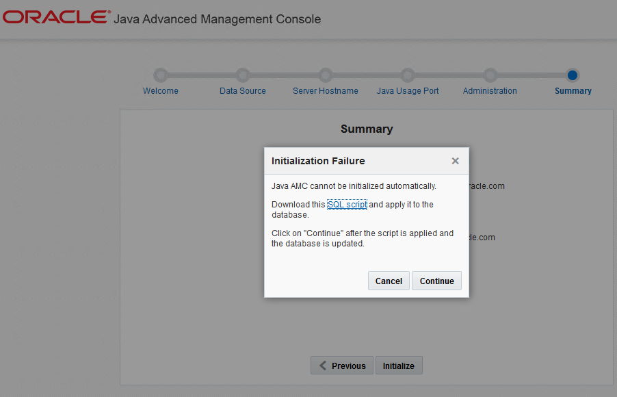

If the automatic database initialization fails, you see the Initialization Failure window shown in Figure 6-2. You can manually initialize the MySQL or Oracle database from this window:
Figure 6-2 Advanced Management Console Initialization — Database Initialization
Description of "Figure 6-2 Advanced Management Console Initialization — Database Initialization"-
Click the SQL script link to download a SQL script. The SQL script is saved as follows:
amc_mysql_update.sqlfor MySQL database oramc_oracledb_initialization.sqlfor Oracle database. Connect to your Advanced Management Console database to apply it. -
Click Continue after applying the SQL script on your database. Or, click Cancel to cancel the manual database update.
