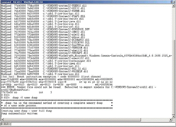

command can be used to force a crash dump. Figure D-1 is an example crash dump created in a file named crash.dump
Figure D-1 Example of a Crash Dump Created by windbg
Description of "Figure D-1 Example of a Crash Dump Created by windbg"
