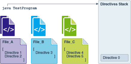

Starting an Application With or Without Directives
TestProgram without specifying the directive files.
To start
TestProgramwithout adding any directives, at the command line, enter the following command:java TestProgram -
TestProgramstarts without any directives file specified. -
The default directive is always the bottom-most directive in the directives stack. Figure 2-1 shows the default directive as
Directive 0. When you don’t specify a directives file, the default directive is also the top-most directive and it receives priority.
Figure 2-1 Starting a Program Without Directives
Description of "Figure 2-1 Starting a Program Without Directives"

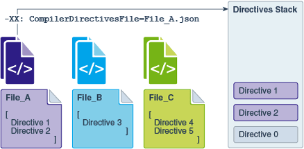

To start the
TestProgramapplication and add the directives fromFile_A.jsonto the directives stack, at the command line, enter the following command:java -XX:+UnlockDiagnosticVMOptions -XX:CompilerDirectivesFile=File_A.json TestProgram -
TestProgramstarts and the directives inFile_Aare added to the stack. The top-most directive in the directives file becomes the top-most directive in the directives stack. -
Figure 2-2 shows that the order of directives in the stack, from top to bottom, becomes is [1, 2, 0].
Figure 2-2 Starting a Program with Directives
Description of "Figure 2-2 Starting a Program with Directives"

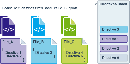

Adding Directives to a Running Application
To to add all directives from
File_Bto the directives stack, enter the following command:jcmd 11084 Compiler.directives_add File_B.jsonThe directive in
File_Bis added to the top of the stack. -
Figure 2-3 shows that the order of directives in the stack becomes is [3, 1, 2, 0].
Figure 2-3 Adding a Directive to a Running Program
Description of "Figure 2-3 Adding a Directive to a Running Program"

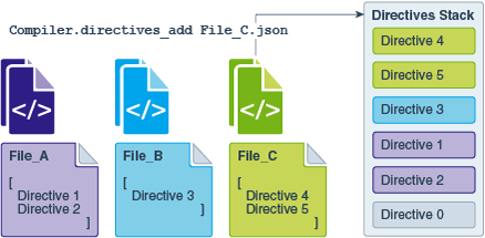

TestProgram while it is running:
To add all directives from
File_Cto the directives stack, enter the following command.jcmd 11084 Compiler.directives_add File_C.json -
Figure 2-4 shows that the order of directives in the stack becomes is [4, 5, 3, 1, 2, 0].
Figure 2-4 Adding multiple Directives to a Running Program
Description of "Figure 2-4 Adding multiple Directives to a Running Program"

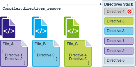

Removing Directives from the Directives Stack
To remove
Directive 4from the stack, enter the following command:jcmd 11084 Compiler.directives_remove -
To remove more, repeat this diagnostic command until only the default directive remains. You can’t remove the default directive.
Figure 2-5 shows that the order of directives in the stack becomes is [5, 3, 1, 2, 0].
Figure 2-5 Removing One Directive from the Stack
Description of "Figure 2-5 Removing One Directive from the Stack"

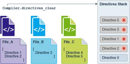

To clear the directives stack, enter the following command:
jcmd 11084 Compiler.directives_clear -
All directives are removed except the default directive. You can’t remove the default directive.
Figure 2-6 shows that only
Directive 0remains in the stack.
Figure 2-6 Removing All Directives from the Stack
Description of "Figure 2-6 Removing All Directives from the Stack"
