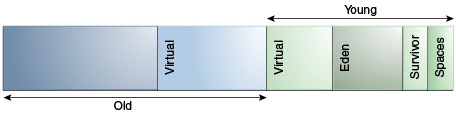

Arrangement of Generations in Parallel Collectors
The arrangement of the generations is different in the parallel collector.
That arrangement is shown in Figure 6-1:
Figure 6-1 Arrangement of Generations in the Parallel Collector
Description of Figure 6-1 follows
Description of "Figure 6-1 Arrangement of Generations in the Parallel Collector"
