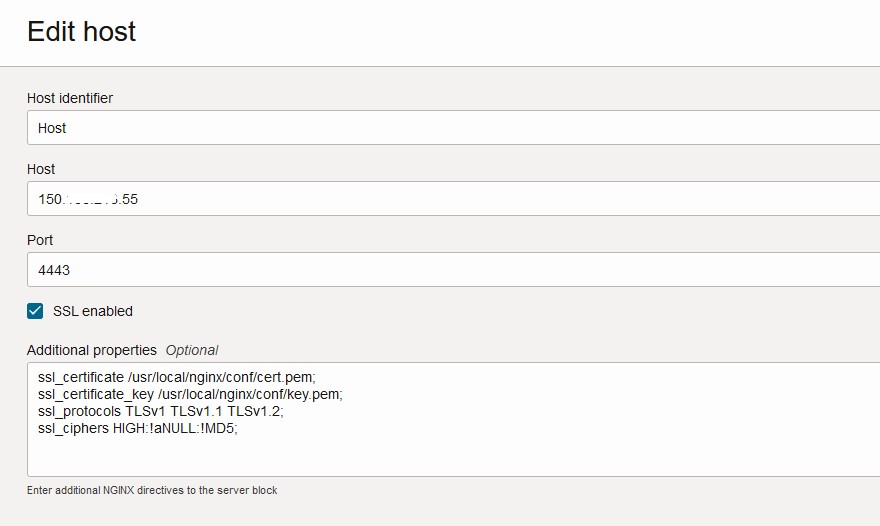

    Create the App Gateway on the IAM Domain under Security tab. Provide the necessary details to complete the configuration. Details needed to register the App Gateway are Name of the App Gateway and Host, which is the Public IP of the machine where you want to deploy the App Gateway image. Select the SSL enabled check box and add the certificate in the Additional Properties section that you are going to use for App Gateway in below format. Add correct path of the certificate on the App Gateway. ssl_certificate /usr/local/nginx/conf/server.crt; ssl_certificate_key /usr/local/nginx/conf/server.key; ssl_protocols TLSv1 TLSv1.1 TLSv1.2; ssl_ciphers HIGH:!aNULL:!MD5; Note: You can use the public SSL certificate for above step and if you do not have any public certificate then you can use the self signed certificate as well. You can generate the self signed certificate with the following openSSL command. openssl req -x509 -newkey rsa:4096 -keyout /home/opc/certs/key.pem -out /home/opc/certs/cert.pem -sha256 -days 3650 -nodes -subj "/C=US/ST=Florida/L=Miami/O=Oracle/OU=Cloud/CN=oracle"

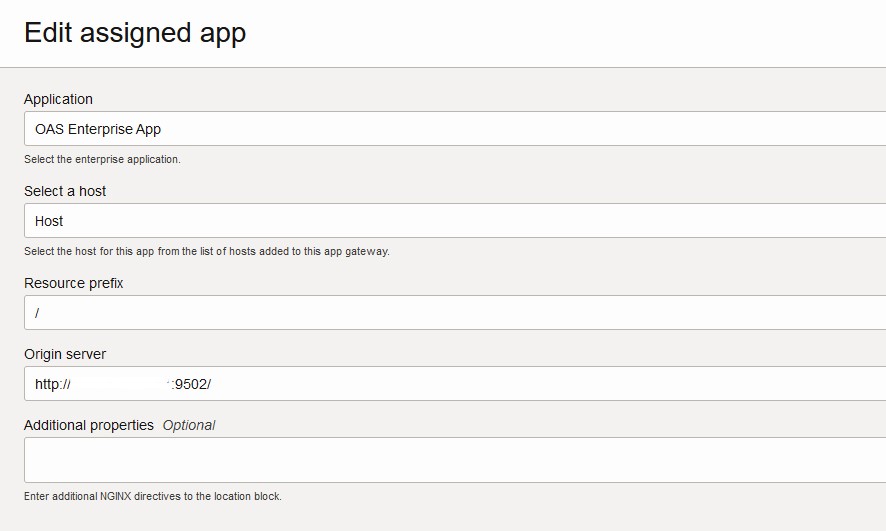

    Add the Enterprise application on the App Gateway we have registered in the first step as Apps. Choose the Enterprise app you created under Application, select Host under the Select a Host. Provide the Resource Prefix as / and under Origin Server provide the URL for your Oracle Analytics Server and Save the changes.

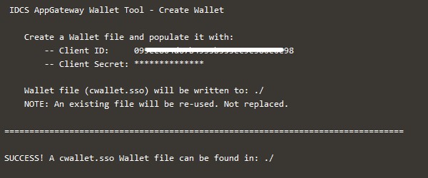

    Create a wallet file containing the Client ID and Client Secret of the App Gateway that was created in the IAM Domain. Use the following steps to create the wallet file. env LD_LIBRARY_PATH=./lib ./cgwallettool --create -i **ClientID of AppGateway in IAM Domain**.Note: Upon executing the above, it will ask for Client Secret of App Gateway. These steps will create the cwallet.ssofile for App Gateway.

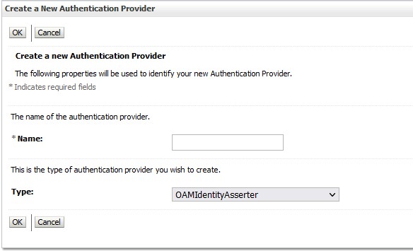

    Navigate to to the myrealm and to Providers. Create the OAMIdentityAsserter as a provider.

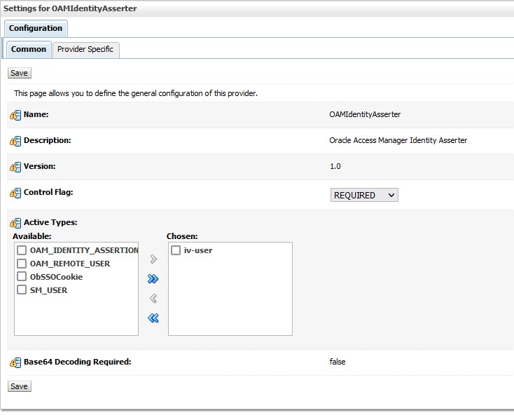

    After creating the Provider, edit the same to change the Control Flag to Required and then choose the Active types as iv-user.
    Set the iv-user in Provider Specific properties under SSOHeader Name and click Save.
