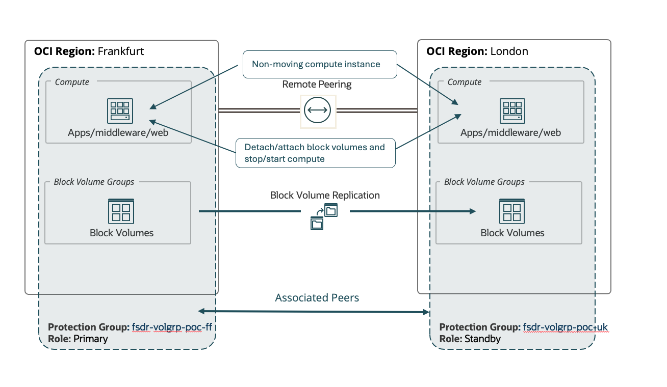

Deployment Architecture
In this tutorial, primary region is Frankfurt and standby region is London.

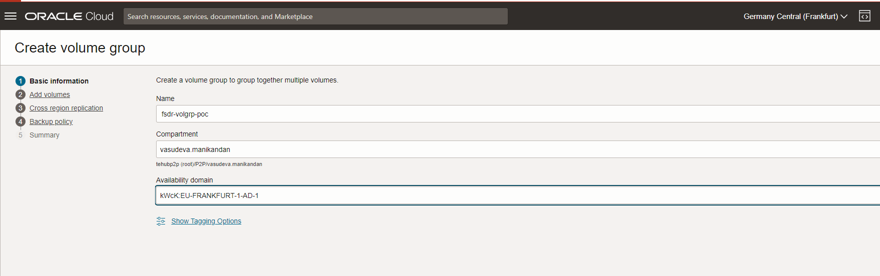

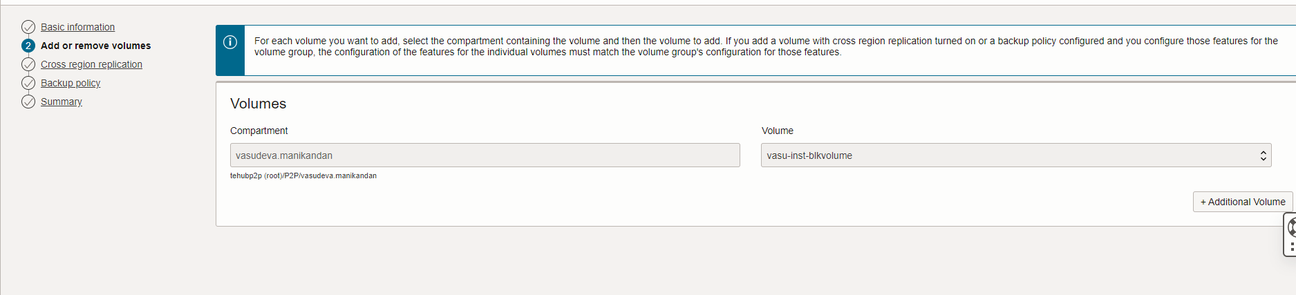

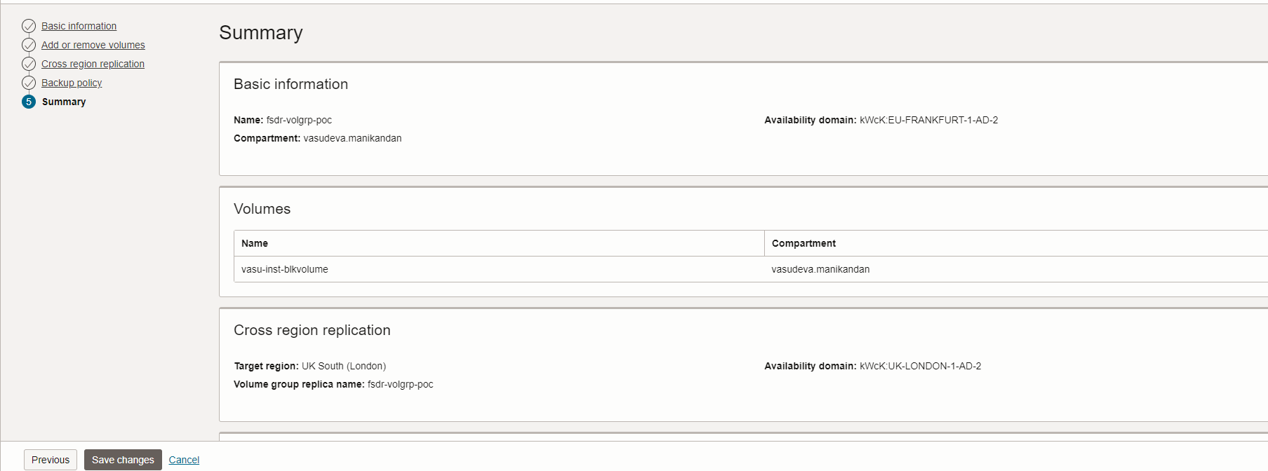

Task 1: Create Volume Groups with Cross Region Replication for the Block Volume in Primary Region
Log in to the OCI Console using the OCI Full Stack DR administrator user or user with required privileges.

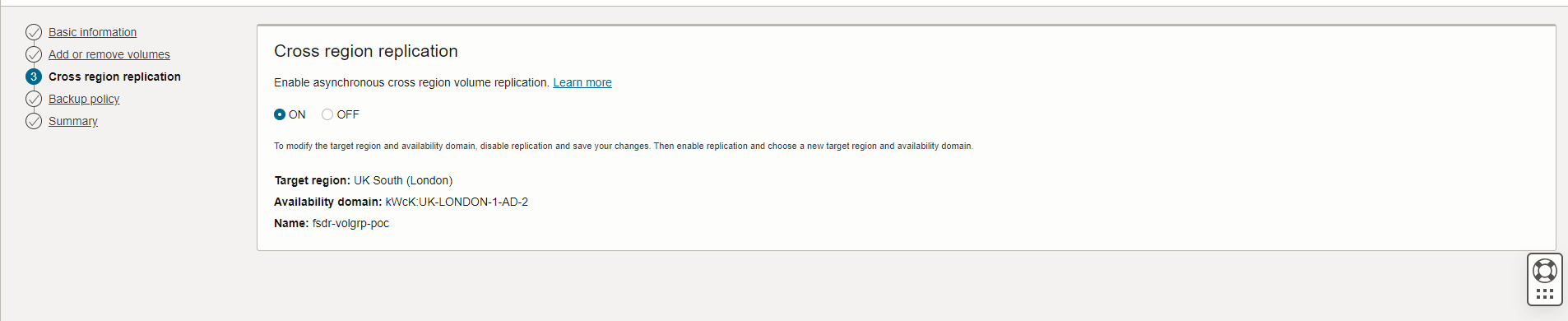

In the primary region (Frankfurt), click the Hamburger menu and go to Storage, Disaster Recovery, Volume Groups, and then click Create volume group.
Add block volume of the compute
vasu-pub-inst.
Enable cross region replication from Frankfurt to London.
Leave Backup policy as None, click Next and review the summary.

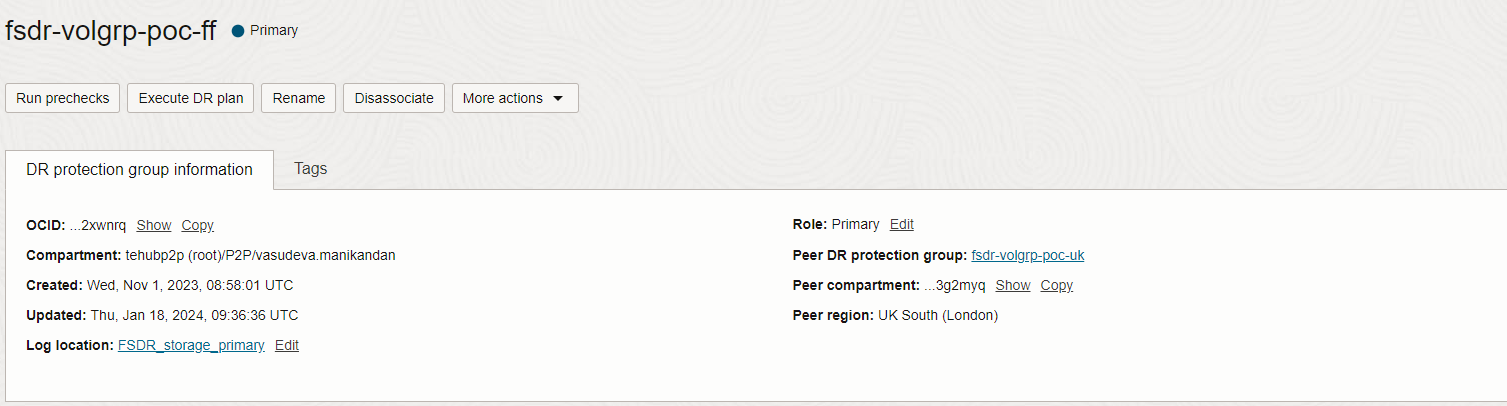

Task 2: Create and Associate DR Protection Groups in Primary and Standby Regions

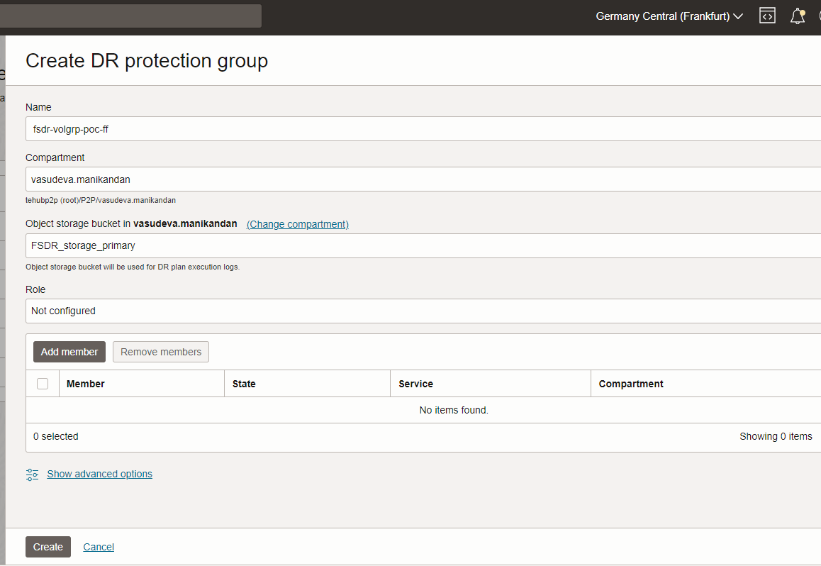

Go to the OCI Console, in the primary region (Frankfurt) from the Hamburger menu and navigate to Migration & Disaster Recovery, Disaster Recovery, Disaster Recovery Protection Groups, and then click Create Disaster Recovery Protection Group.

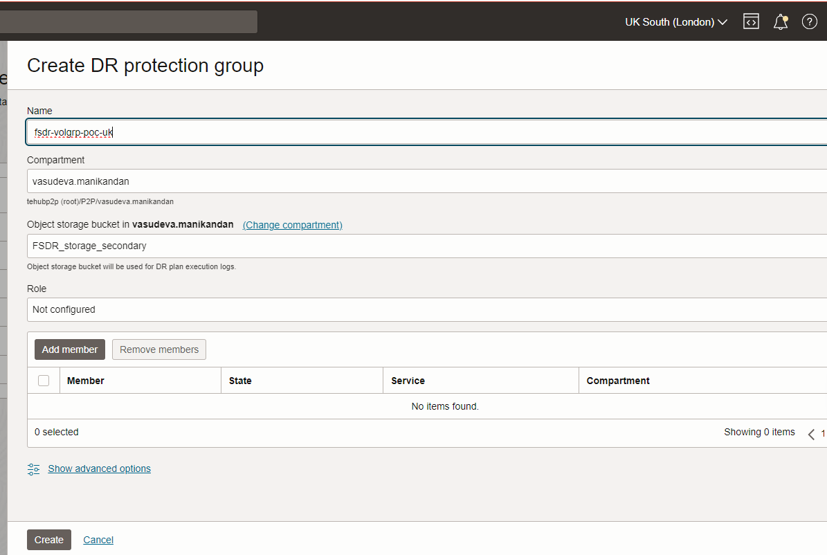

In the standby region (London) from the Hamburger menu, go to Migration & Disaster Recovery, Disaster Recovery, Disaster Recovery Protection Groups and click Create Disaster Recovery Protection Group.
In the primary region (Frankfurt), enter the following information and click Associate.
- Name of the DR Protection Group (DRPG):
fsdr-volgrp-poc-ff. - Role:
Primary. - Peer Region:
London. - Peer Disaster Recovery Protection Group:
fsdr-volgrp-poc-uk.
Note: Verify the role of the
fsdr-volgrp-poc-ffas primary andfsdr-volgrp-poc-ukas standby.

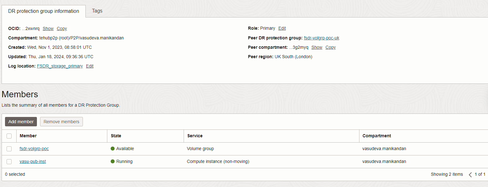

Task 3: Add and Update members in Primary DR Protection Group

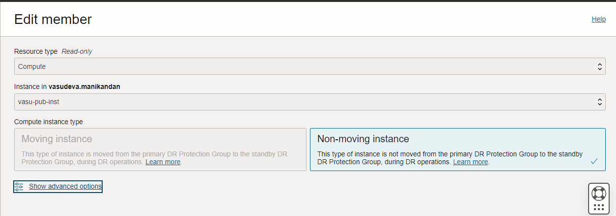

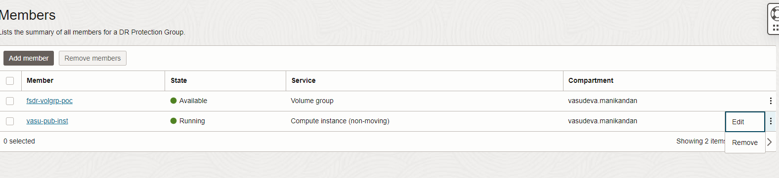

In primary region (Frankfurt), select the
fsdr-volgrp-poc-ffDRPG and click Members and Add Members to add volume group and non-moving virtual machine (VM).
Note: Ensure you choose compute instance type as non-moving instance while adding VM as a member.

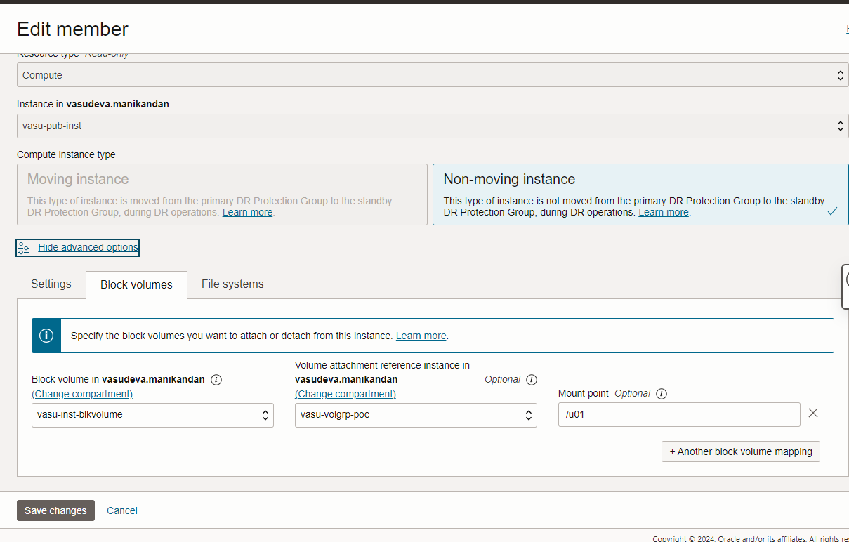

Under Members, click the ellipsis icon for the compute instances and click Edit.
Click Show advanced options, select Block volumes, enter the following information, and then click Save changes.
- Source block volume:
vasu-inst-blkvolume. - Volume attachment reference instance: Volume attachment reference as block volume group that created in Task 1. In this tutorial, it is
vasu-volgrp-poc. - Mount point: Mount point that you have created and attached to the source VM in primary. In this tutorial, it is
/u01.
Note: If you do not mention the mount point, during drill or switchover, OCI Full Stack DR will attach the block volume to the target standby VM in OCI Console. You need to manually run the mount commands in the VM to make it available.

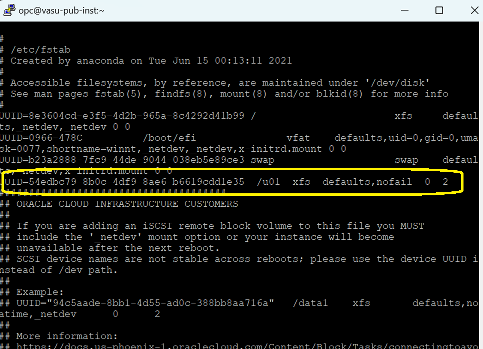

Login to the primary region VM vasu-pub-inst and ensure
/etc/fstabentries are updated with block volume and mount point details as shown in the following image.

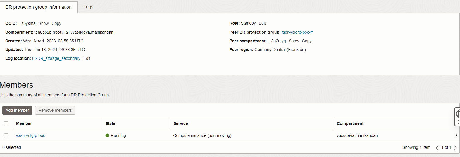

In standby region (London), select the
fsdr-volgrp-poc-ukDRPG and click Members and Add Members to add non-moving VM.

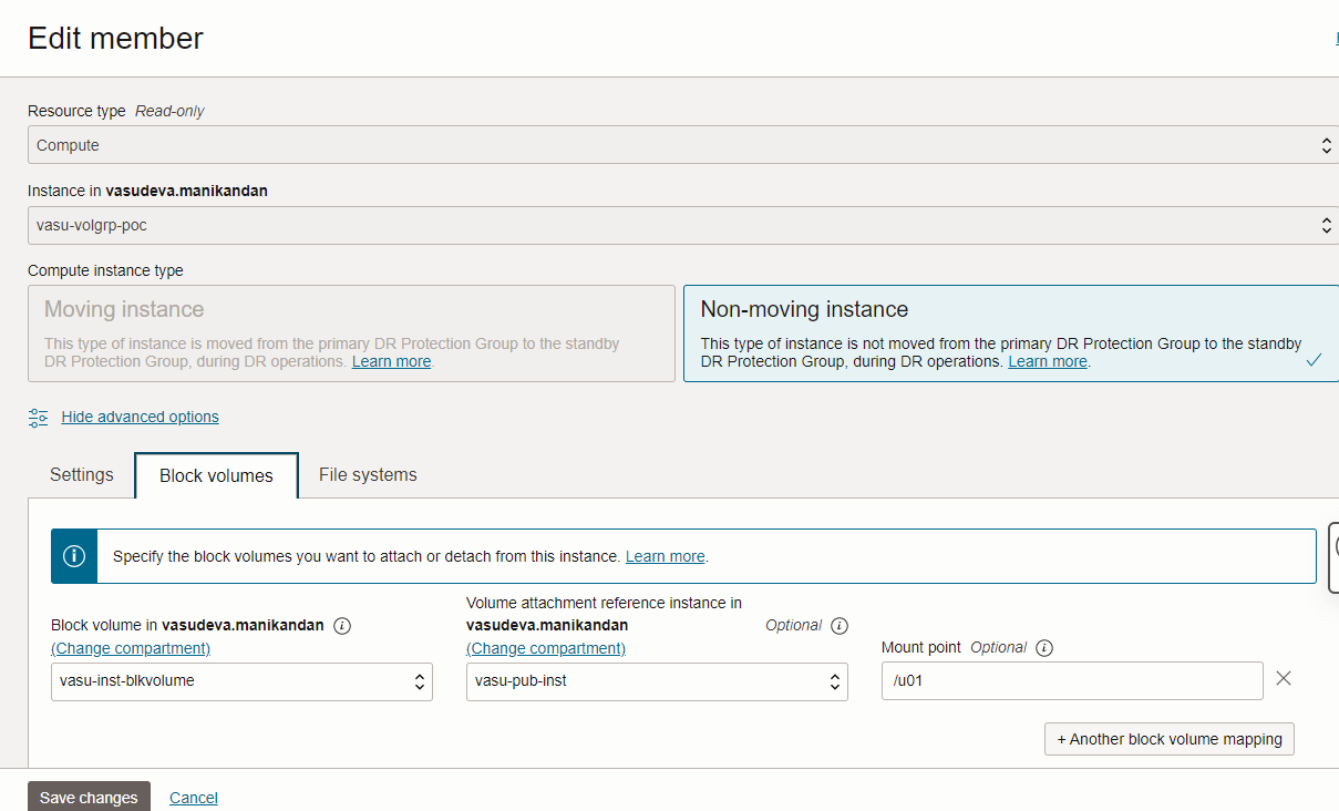

Under Members, click ellipsis icon of compute instance
vasu-volgrp-pocand click Edit. -
Click Show Advanced Options, select Block Volume and enter the following information, and then click Save changes.
- Block volume: Select source block volume that you need to attach it to target VM. In this tutorial, it is
vasu-inst-blkvolume. - Volume attachment reference instance: Volume attachment reference is the source VM in primary which is
vasu-pub-inst. - Mount point: Mount point as created in source VM. In this tutorial, it is
/u01.

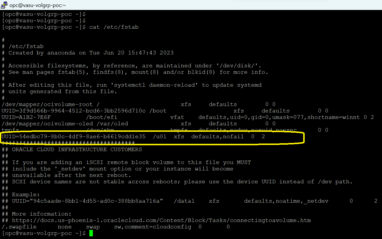

Login to the standby region VM vasu-volgrp-poc and ensure

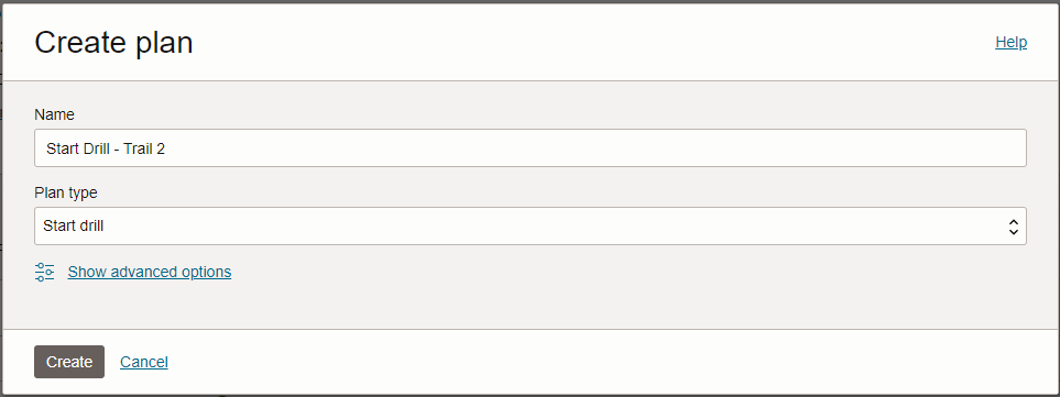

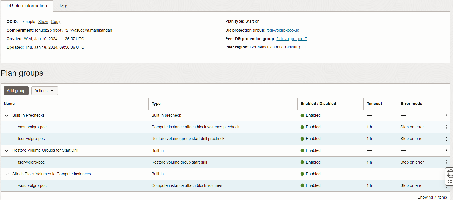

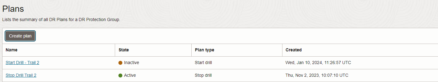

Task 5: Create Start DR Drill Plan in Standby Region
Create DR plan in standby DR Protection Group fsdr-volgrp-poc-uk.
Click Plans, Create plan and enter the following information, and then click Create.
- Name:
Start Drill - Trail 2. - Plan Type:
Start Drill.
Note: Make sure to create the DR drill plan from the standby DR Protection Group (London).
- Name:

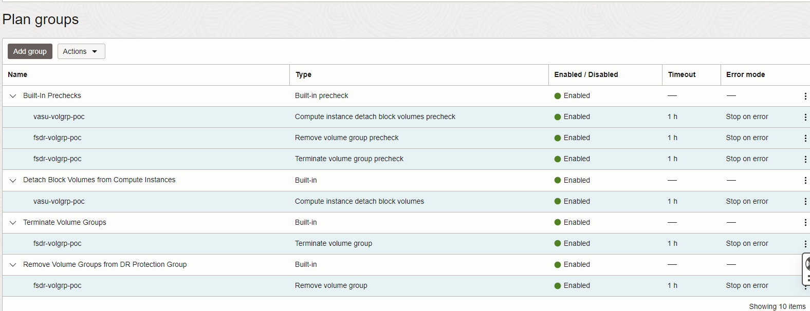

Click the plan and ensure built-in plans have been generated as shown in the following image.

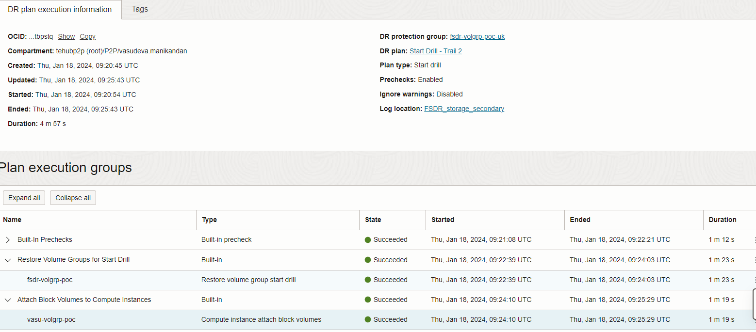

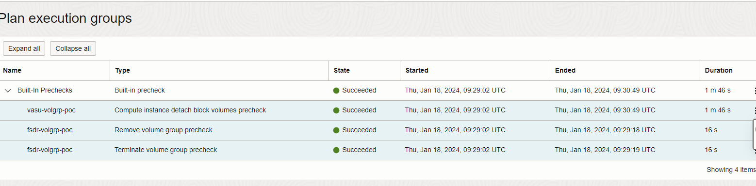

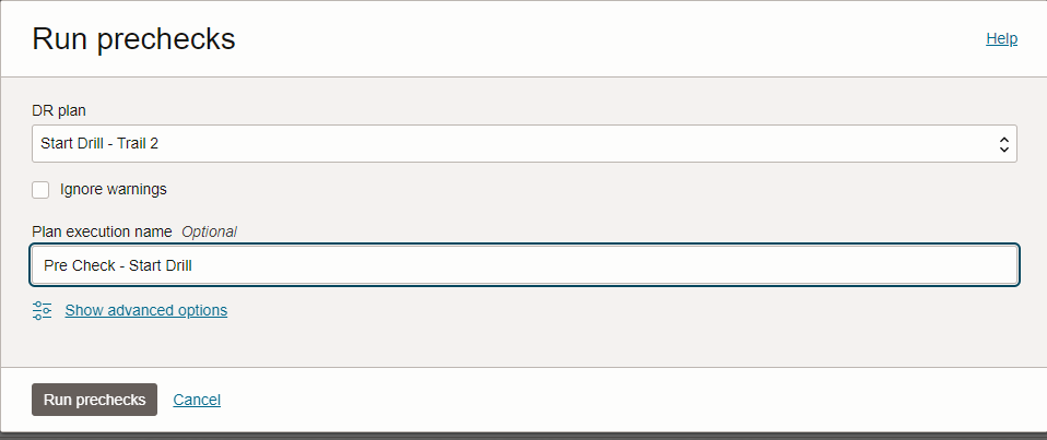

Task 6: Execute Prechecks and Run Start Drill Plan
The Run prechecks option performs a quick validation of all steps in a DR plan.

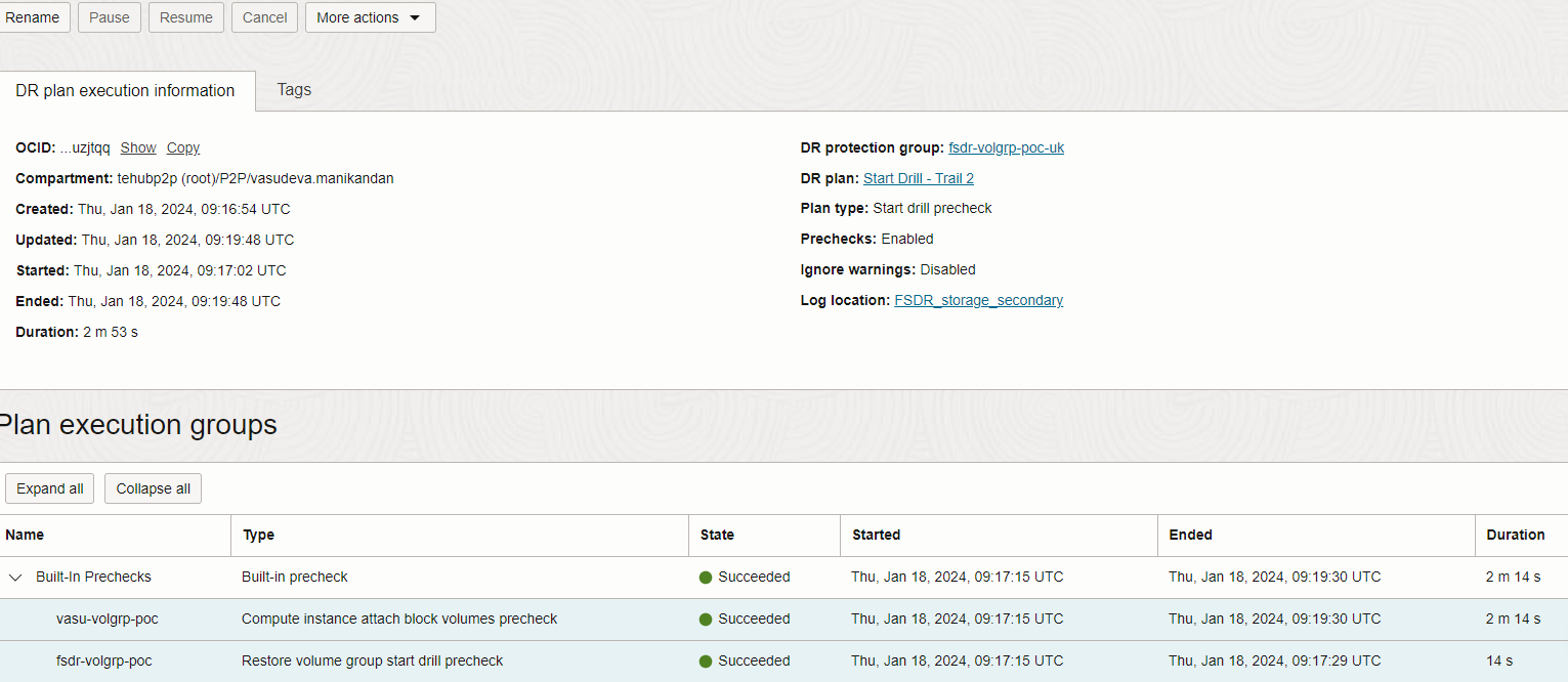

Select Start Drill - Trail 2 plan, click Run prechecks to launch the run prechecks dialog and verify for the successful completion.

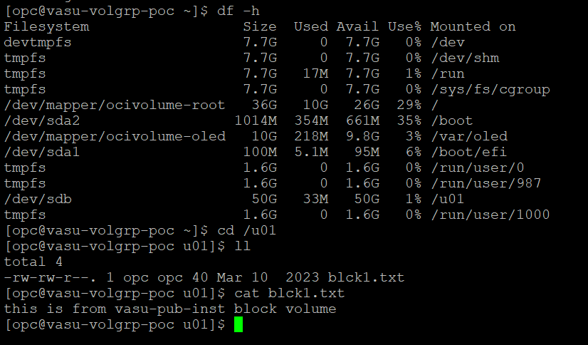

Select Start Drill - Trail 2 plan, click Execute Disaster Recovery Plan to execute the plan.
Check the status of the plan and ensure all the steps in the plan succeed.
After the successful DR plan execution, log in to the instance in London and verify the mount points have been attached.
Once you start the drill, DR Protection Group on both primary and standby region will turn to
Inactivestate (Drill in Progress). During this stage, changes to the DR Protection Group on both primary and standby are restricted. When the primary and standby DR Protection Group states are DrillInProgress, you can execute only the Stop drill plans.

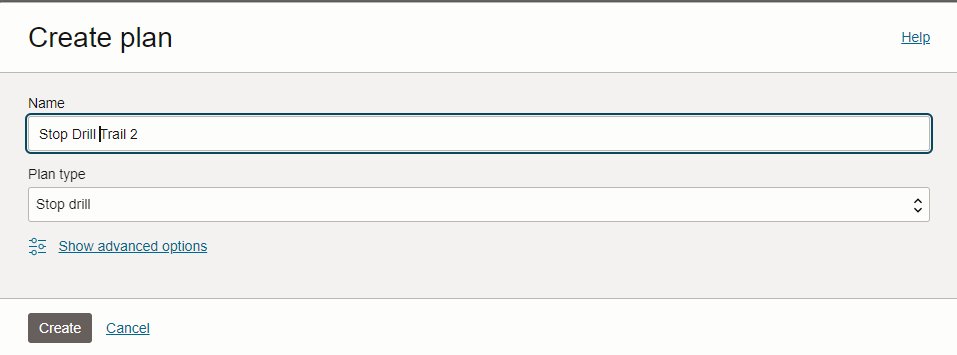

Task 7: Create Stop Drill Plan in Standby Region
- Name:
Stop Drill - Trail 2. - Plan Type:
Stop Drill.
Note: Note that Start DR drill plan will be in active state since we can only run Stop drill plan from the standby DR Protection Group (London).
- Name:

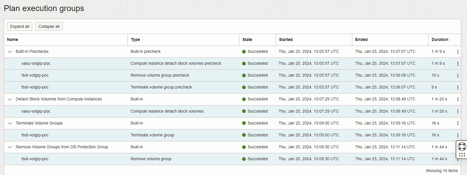

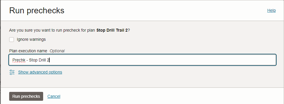

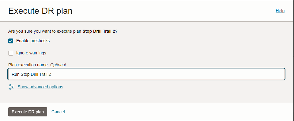

Task 8: Execute Prechecks and Run Stop Drill Plan
Select Stop Drill - Trail 2 plan, click Run prechecks to launch the run prechecks dialog and verify for the successful completion.

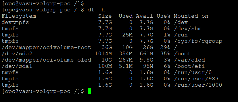

From the DR drill plan Stop Drill - Trail 2, click Execute Disaster Recovery Plan to execute the plan.
Check the status of the plan and ensure all steps in the plan succeed.
After the successful DR plan execution, log in to the instance in London and verify if the mount points have been detached.
