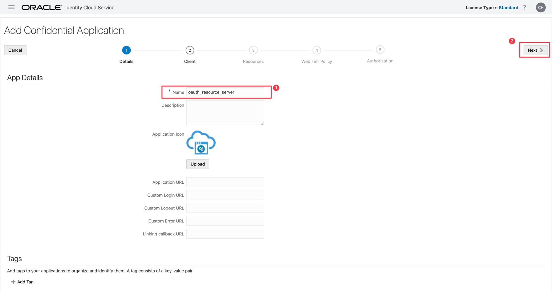

We will configure the first application. Enter a Name in your resource server application and click Next.
Click Skip for later. We need to configure the resource only.

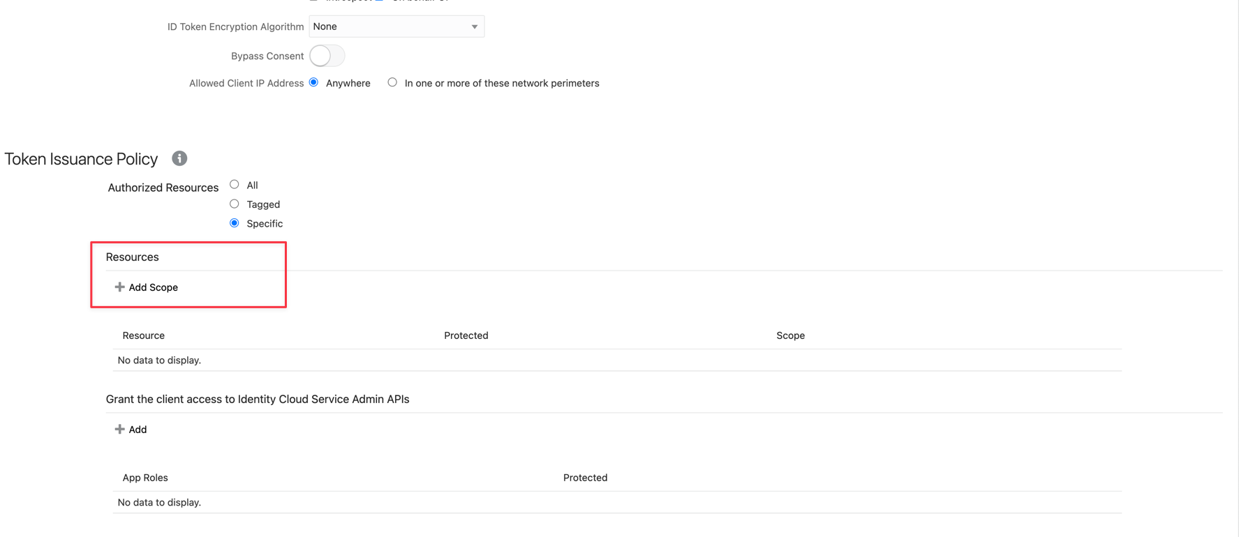

Select Configure the application as a client now to enable the configurations for your client application. Select Client Credentials, JWT Assertion and On behalf of.
Note: If you want to validate OAuth2 in your function code, you MUST set the Introspect flag. This will enable the
/oauth2/v1/introspectOracle Identity Cloud Service REST API service.
Scroll down and click Add Scope.
Find your resource application created before (
oauth_resource_server) and click Add.
You can see your scope added to your application. Click Next.
