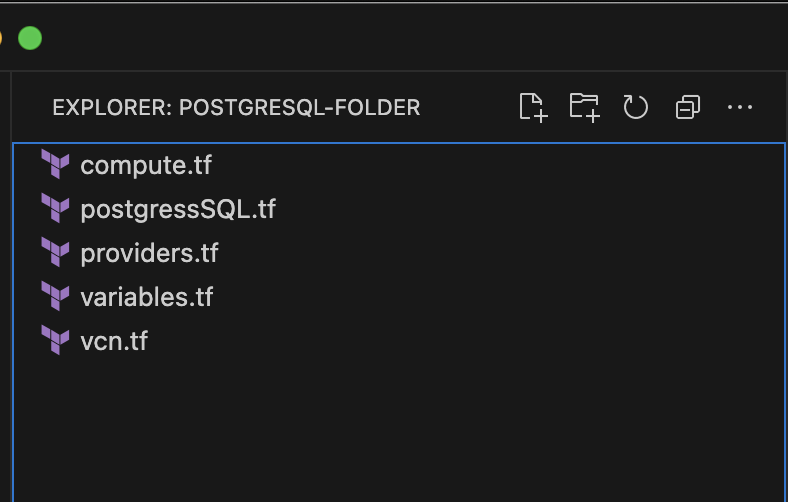

After creating the required files and adjust the
variables.tf
file with the necessary values, your folder structure will reflect the set up displayed in the following screenshot.
