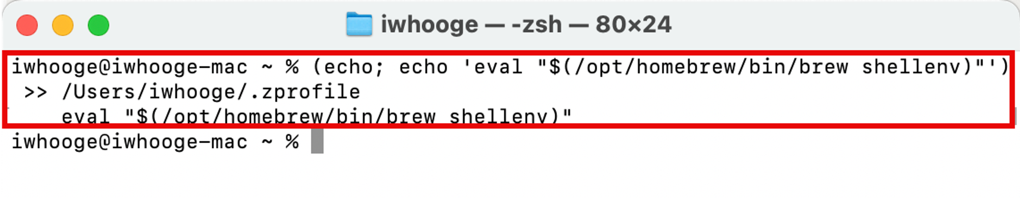

Run the following command to add Homebrew to your path variable.
iwhooge@iwhooge-mac ~ % (echo; echo 'eval "$(/opt/homebrew/bin/brew shellenv)"') >> /Users/iwhooge/.zprofile eval "$(/opt/homebrew/bin/brew shellenv)"

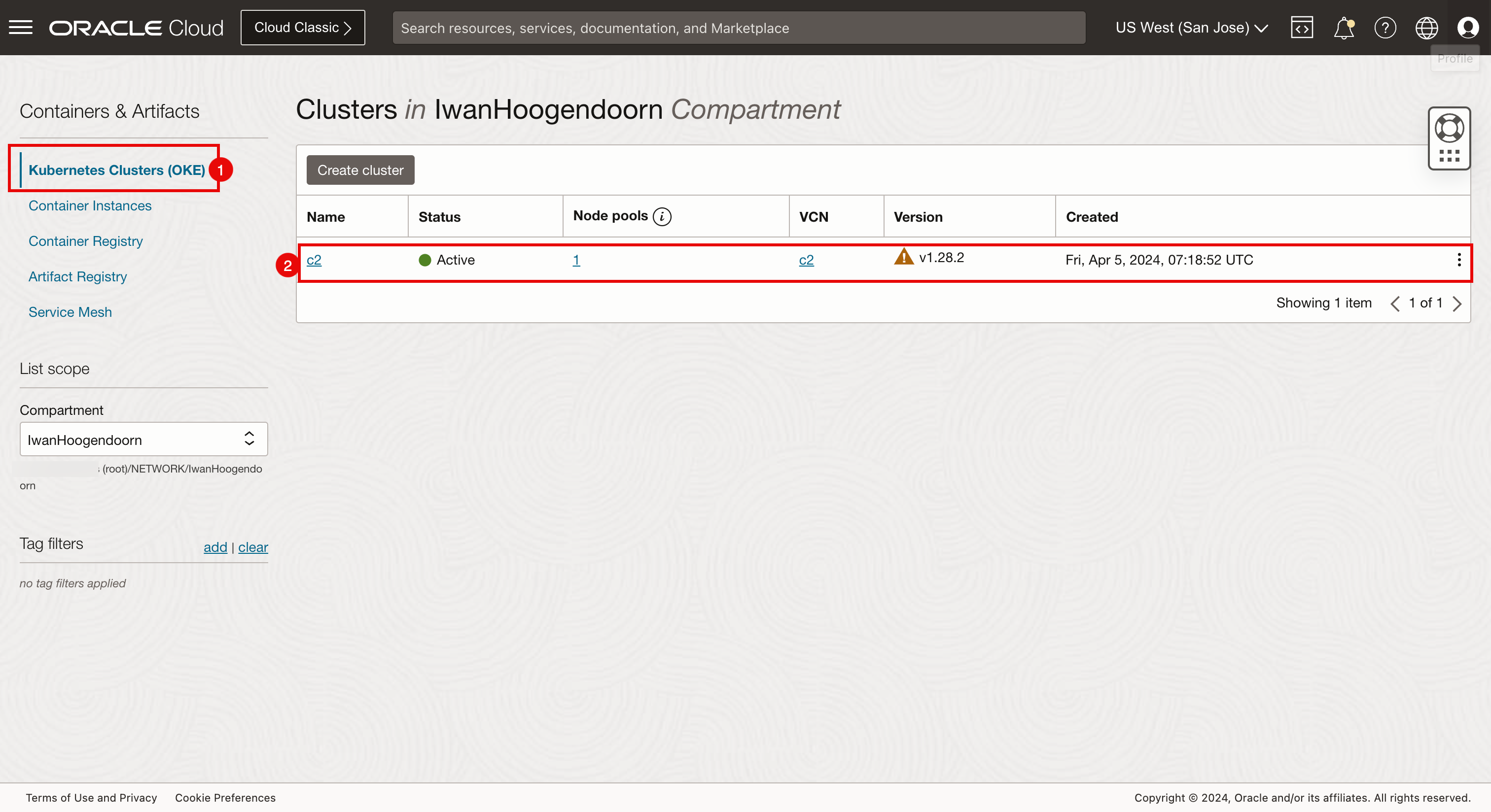

- Navigate to Developer Services and Kubernetes Clusters (OKE).
- Review that the c2 Kubernetes cluster is created here.
