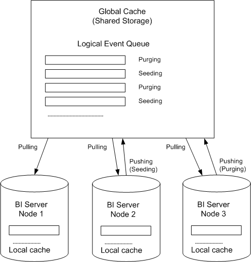

About the Global Cache
In a clustered environment, Presentation Services can be configured to access a shared cache called the global cache.
This global cache resides on a shared file system storage device and stores purging events, seeding events (often generated by agents), and result sets that are associated with seeding events. The seeding and purging events are sorted by time and stored on the shared storage as a logical event queue. Individual Presentation Services nodes push to and pull from the logical event queue. Each Presentation Services still maintains its own local query cache for regular queries.
The figure below depicts global caching in a clustered environment. It shows three Presentation Services nodes sharing a global cache. The global cache stores seeding or purging events held in a logical event queue. The arrows from Node 2 and Node 3 to the shared cache show Presentation Services Node 2 pushing a seeding event to the queue and Presentation Services Node 3 pushing a purging event to the queue. The arrows from the shared storage to each Presentation Services node show each node pulling from the common location. This occurs on a periodic basis and enables participating Presentation Services nodes to obtain updates to the logical event queue made by other Presentation Services.
The Presentation Services node processes a seeding or purging event locally first in its caching system. It then pushes the event to the global cache on the shared storage. During the push event, the active Presentation Services node locks the logical event queue on the shared storage and then pushes in the seeding or purging event. If there's a conflict between seeding and purging (for example, one node wants to seed a query and another node wants to purge the same query), then the event that comes in last wins.
The logical event queue in the global cache on the shared storage is composed of seeding and purging events from individual Presentation Services nodes. The queue is sorted according to the timestamp of the events. Hence, clocks on all Presentation Services nodes participating in cluster must be synchronized.
Each Presentation Services node polls the global cache on a periodic basis for new cache entries. This polling frequency is configurable. A snapshot of the queued logical events on the shared storage is pulled back to the node and a local logical event queue is constructed and then processed.
The process of populating or purging seeded caches across all Presentation Services nodes that participate in the cluster doesn't occur in real time, and the elapse of the process is affected by multiple factors, such as the predefined polling interval, network bandwidth, and CPU loads.
