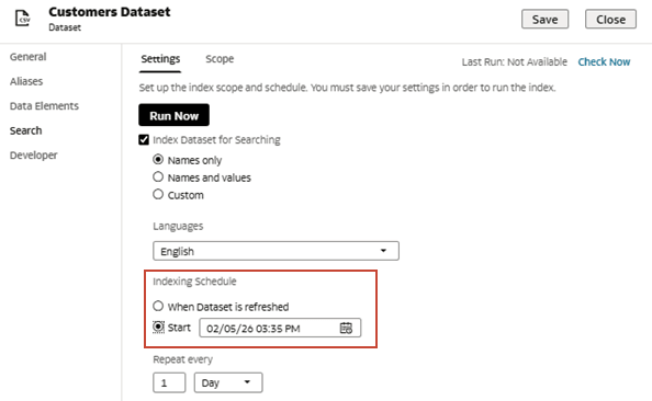

  4. Click the Search tab.
  5. In the Indexing Schedule section, click Start and then click the Select Date Time button.
  6. In the dropdown calendar, select the first date you want to refresh the dataset. At the bottom of the dropdown calendar, click the time stamp and specify what time you want indexing to run.
  7. Use the Repeat every field and frequency dropdown to select how often you want the schedule to run.
  8. Click Save.
