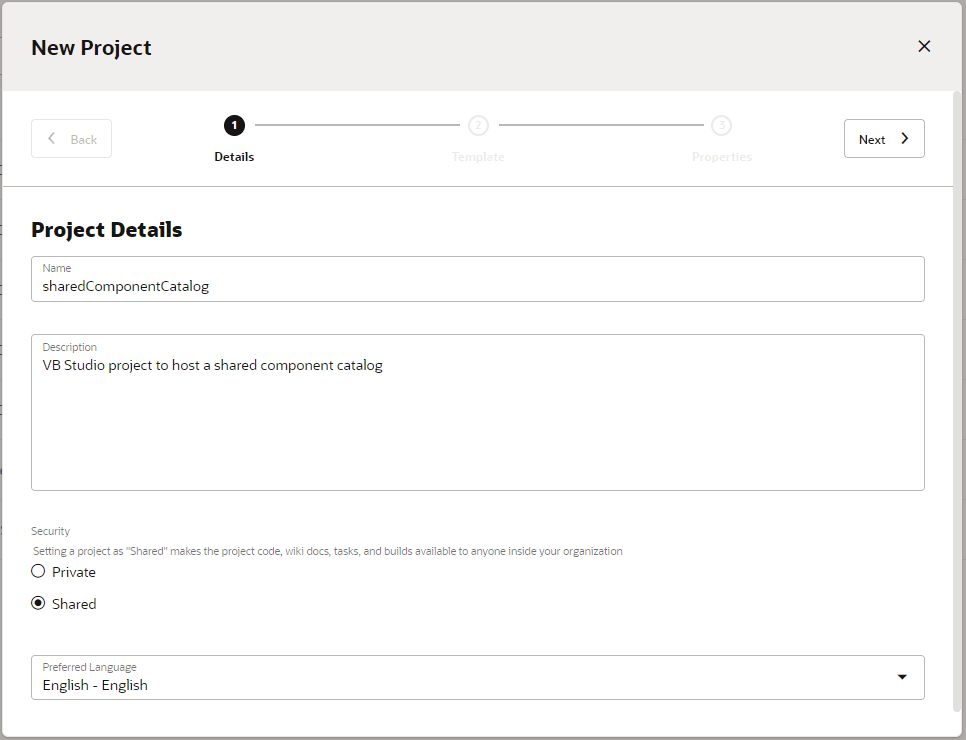

  1. Create a new project in Oracle Visual Builder Studio.
    Image shows the New Project page of the Oracle Visual Builder Studio.

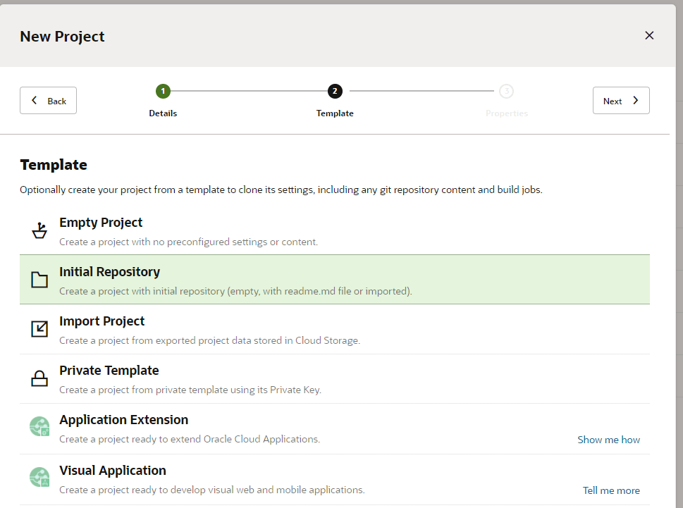

  2. Select the Initial Repository template for the new project.
    Image shows the New Project Templates page of the Oracle Visual Builder Studio.

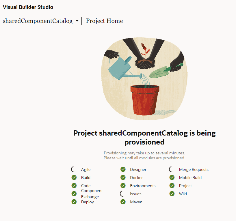

  4. In the project provisioning screen, verify that Component Exchange is one of the services being created.
    Image shows the Shared Component Catalog home page hosted by the Oracle Visual Builder Studio.
