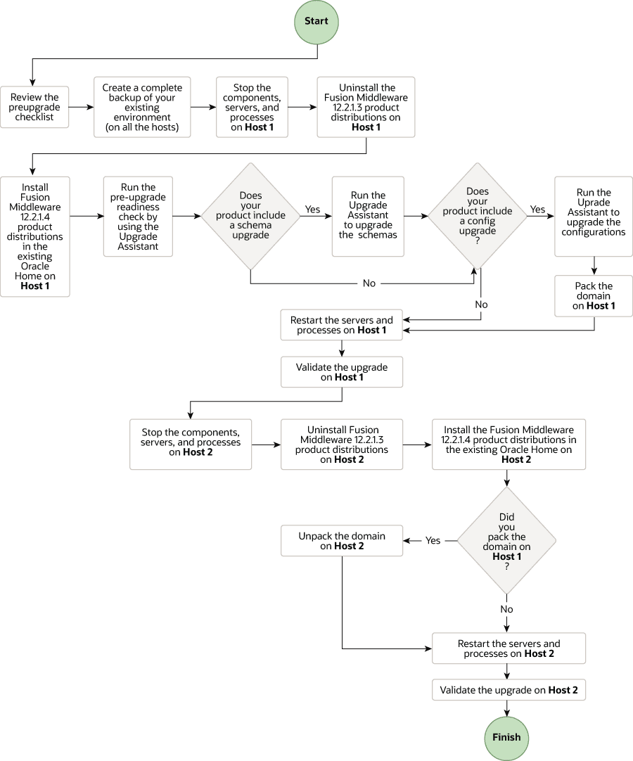

Figure C-1 Process Flowchart for a Reduced Downtime Upgrade
Description of Figure C-1 follows
Description of "Figure C-1 Process Flowchart for a Reduced Downtime Upgrade "
Table C-1 lists the high-level steps that you need to perform for a reduced downtime upgrade of the Oracle Fusion Middleware 12c (12.2.1.3.0) release. You must repeat these steps for each additional host.
Table C-1 Tasks for Performing a Reduced Downtime Upgrade of Oracle Fusion Middleware 12c (12.2.1.3.0) Release

Upgrading Product Schemas and Component Configurations
When upgrading to Fusion Middleware 12 c (12.2.1.4.0), if your product component includes a schema and/or a config upgrade, you have to upgrade the supported product schemas and component configurations on Host 1, by using the Upgrade Assistant.
For the list of schemas and component configuration that you can upgrade to 12c (12.2.1.4.0), see the following sections of Upgrading with the Upgrade Assistant
Packing the Domain on Host 1
After you have performed a config upgrade for your product component, you must pack the domain on Host 1 by using the pack command.
See Packing the Domain on the Primary Node.
For information about the pack command, see The Pack Command in Creating Templates and Domains Using the Pack and Unpack Commands.
Restarting Node Manager, Administration Server, Managed Servers and Components on Host 1
After the upgrade, you must restart the components, servers, and processes in the correct order.
The procedures in this section describe how to start servers and processes using the WLST command line or a script. You can also use the Oracle Fusion Middleware Control and the Oracle WebLogic Server Administration Console. See Starting and Starting Administration and Managed Servers and Node Manager in Administering Oracle Fusion Middleware.
The components must be started in the following order:
  • Node Manager
  • Administration Server
  • Managed Server(s)
  • System Components
If you are unable to successfully start any of the following components on Host 1, do not proceed with the upgrade on the remaining Hosts. You must first resolve the issues with the components on Host 1.
Windows Users Only: When restarting the servers on a Windows operating system, the upgraded domain might fail with a parsing exception. To fix this parsing error, add the property "-Doracle.xml.schema/Ignore_Duplicate_components=true" to the server startup script setDomainEnv.cmd.
Starting the Node Manager
To start Node Manager:
  1. Enter the following command:
    (UNIX) DOMAIN_HOME/bin/startNodeManager.sh
    (Windows) DOMAIN_HOME\bin\startNodeManager.cmd
Starting the Administration Server
To start the Administration Server:
    (UNIX) DOMAIN_HOME/bin/startWebLogic.sh
    (Windows) DOMAIN_HOME\bin\startWebLogic.cmd
  2. When prompted, enter your user name, password, and the URL of the Administration Server.
Starting the Managed Servers
To start the Managed Servers:
    (UNIX) DOMAIN_HOME/bin/startManagedWebLogic.sh managed_server_name admin_url
    (Windows) DOMAIN_HOME\bin\startManagedWebLogic.cmd managed_server_name admin_url
  2. When prompted, enter your user name and password.
Starting Component Processes
When you stopped the Administration Server, you also stopped the processes running in the Administration Server, including the WebLogic Server Administration Console and Fusion Middleware ControlAfter the upgrade, you will need to restart all of these processes.
  1. Navigate to the DOMAIN_HOME\bin directory.
  2. Execute the following script for each component :
    /startComponent.sh component_name
Performing the Upgrade on Host 2
After you have completed the upgrade on host 1, perform the following steps on each additional host in your environment. Our standard topology example includes only two hosts, but you may have more.
Stopping the Components, Servers and Processes on Host 2
You must stop the system components, managed servers and node manager running on Host 2.
Stop the system components first, followed by the managed server(s) and then the node manager. Failure to stop the components in the correct order may result in a failed upgrade.
Stopping System Components
To stop system components, Oracle HTTP Server, use the stopComponent script:
Execute the following script for each component:
(UNIX) DOMAIN_HOME/bin/stopComponent.sh component_name
(Windows) DOMAIN_HOME\bin\stopComponent.cmd component_name
Stopping the Managed Servers
To stop a WebLogic Server Managed Server, use the stopManagedWebLogic script:
    (UNIX) DOMAIN_HOME/bin/stopManagedWebLogic.sh managed_server_name admin_url
    (Windows)DOMAIN_HOME\bin\stopManagedWebLogic.cmd managed_server_name admin_url
Stopping the Node Manager
To stop Node Manager, close the command shell/prompt in which it is running.
Alternatively, after having set the nodemanager.properties attribute QuitEnabled to true (the default is false), you can use WLST to connect to Node Manager and shut it down.
Uninstalling the Software
When performing a rolling upgrade, an empty directory is required for installing the new binaries prior to upgrading.
You must deinstall the upperstack components first, then deinstall JRF. After deinstalling the JRF, back up any remaining files and then delete all files in the directory. The installation directory must be empty.
Follow the instructions in this section to remove the software from the existing ORACLE_HOME. You will reinstall the new software into this same directory.
To start the Oracle Universal Installer in deinstallation mode, execute the following command:
UNIX: ORACLE_HOME/oui/bin/deinstall.sh
Windows: ORACLE_HOME\oui\bin\deinstall.cmd
If you want to uninstall the product in a silent (command-line) mode, see Running the Oracle Universal Installer for Silent Uninstallation in Installing Software with the Oracle Universal Installer.
Installing the Software in the Existing Oracle Home on Host 2
After you have uninstalled the software from the 12c (12.2.1.3) Oracle home, install the 12c (12.2.1.4) binaries into the same Oracle home, on Host 2.
You must install the software on each host in your deployment. Follow the same process that you used to install the software on Host 1. Ensure that you begin with an empty directory.
Unpacking the Domain on Host 2
After completing the config upgrade, you had packed your domain on Host 1. You must now unpack the domain on Host 2 by using the unpack command.
See Unpacking the Domain on the Secondary Node.
For information about the unpack command, see The Unpack Command in Creating Templates and Domains Using the Pack and Unpack Commands.
Restarting the Managed Servers and Processes
After the upgrade is complete on Host 2, restart the managed servers.
Validating the Upgrade
After you have completet the upgrade on all hosts, complete the standard upgrade verification tasks to ensure that all components will continue to work as expected.
See .
Only perform those tasks that pertain to your environment, configuration and preferences. These tasks are meant to assist you in verfiying that the upgrade was successful. You may need to perform additional testing based on your configuration.
Recovering from a Failed Upgrade
If your upgrade is unsuccessful, you will need to restore your environment from backup. Make sure that you include your backed up configuration and script files. Restore the backup of the Oracle home (on all of the nodes), the entire domain directory (on all of the nodes) and component schemas. In addition, you will need to restore any UI customizations and the applications directory, in addition to domain directory.
