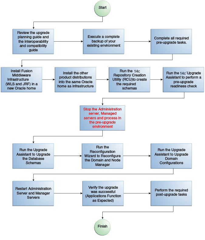

About the Basic 14c Upgrade Process Flow
You should understand the high-level upgrade procedures and tools used to upgrade to the 14c Fusion Middleware Infrastructure.
The flowchart is meant to illustrate a basic upgrade. The tasks you perform to complete your component-specific upgrade may vary from the example shown in this section. The component-specific upgrade documentation provides detailed information about the specific tasks that are required to upgrade the component.About the Basic 14c Upgrade Procedures
Understand the basics of how to upgrade an Oracle Fusion Middleware deployment to 14c (14.1.2.0.0). Consult your component-specific upgrade documentation for the procedures you will perform for your upgrade.
A typical upgrade from the Oracle Fusion Middleware 12c (12.2.1.4.0) release to this Oracle Fusion Middleware 14c (14.1.2.0.0) release is described in this topic. There may be additional steps depending on the components that you are upgrading, but this gives you a general understanding of the upgrade process.
You can find the detailed upgrade procedures in the component-specific upgrade guides.
Table 1-2 Understanding the Basic Upgrade Process
| Task | Tool Used |
Create a complete backup copy of your existing deployment. Complete all of the required pre-upgrade tasks for your environment. |
Pre-Upgrade Checklist in component upgrade guides |

Before you develop a successful upgrade strategy for your Fusion Middleware deployment, it is important to understand the impact of the upgrade on your production environments. Also, the factors that might impact the overall downtime during an upgrade, for example, size of your database and speed of system’s infrastructure
Carefully consider the following when planning your downtime:
The Upgrade Assistant requires that you shut down administration and managed servers for the entire duration of the upgrade.
Run the pre-upgrade readiness check before you begin your actual upgrade to identify potential upgrade issues. If you encounter upgrade issues during the actual upgrade, then you must restart the upgrade process from the beginning. This includes recovering and redeploying from your backup files. You must consider this while planning and calculating the downtime.
After upgrading the component schemas, the Reconfiguration Wizard is used to reconfigure the domain. After the domain is reconfigured, the Upgrade Assistant requires all servers and components to remain shut down during any configuration upgrades. In 12c, servers and components are down during the entire upgrade process.

The upgrade to Oracle Fusion Middleware 14c (14.1.2.0.0) includes upgrading both the midtier and schemas. You cannot perform a midtier-only or schema-only upgrade.
The following list describes how the upgrade is performed on each component:
Oracle Home Binaries - upgraded out of place
You install the Oracle Infrastructure (which includes WebLogic Server and JRF) and other 14c distribution binaries in a new Oracle home. The upgrade of binaries is considered Out-of-Place because the pre-upgrade binaries are not overwritten.
Starting Point (Source) Schemas - upgraded in place
The schemas in your pre-upgrade deployment are upgraded in-place, which means that the Upgrade Assistant updates and overwrites the schemas during the upgrade process. The servers must be down during this process.
Domain Directory Reconfiguration - upgraded in place
The existing domain is upgraded in-place. During the upgrade you identify the location of the existing domain and the domain is reconfigured to point to the new 14c Oracle home directory.
Oracle recommends that you perform your domain upgrades in-place. However, if an Out-of-Place domain upgrade is required, see Performing an Out-of-Place Domain Directory Upgrade. Schemas are still upgraded in-place. -
Domain Component Configuration - upgraded in place
After the reconfiguration of the existing domain, the Upgrade Assistant is used again to upgrade any remaining domain component configurations that require an upgrade in the new 14c Oracle home directory.
