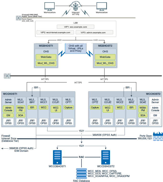

Diagram of the WebCenter Content Enterprise Topology
The below diagram shows the primary Oracle WebCenter Content enterprise deployment topologies.

Although most of the elements of Oracle WebCenter Content topology represent standard features of any enterprise topology, there are some elements that are unique to the WebCenter Content topology.
Most of the elements of Oracle WebCenter Content topologies represent standard features of any enterprise topology that follows the Oracle-recommended best practices. These elements are described detail in Understanding a Typical Enterprise Deployment.

Summary of Oracle WebCenter Content Load Balancer Virtual Server Names
In order to balance the load on servers and to provide high availability, the hardware load balancer is configured to recognize a set of virtual server names.
For information about the purpose of each of these server names, see Summary of the Typical Load Balancer Virtual Server Names.
The following virtual server names are recognized by the hardware load balancer in Oracle WebCenter Content topologies:
wcc.example.com
- This virtual server name is used for all incoming traffic. It acts as the access point for all HTTP traffic to the runtime Oracle WebCenter Content components. The load balancer routes all requests to this virtual server name over SSL. As a result, clients access this service using the following secure address:wcc.example.com:443
wccinternal.example.com
- This virtual server name is for internal communications between the application tier components only and is not exposed to the Internet.The traffic from clients to this URL is not SSL-enabled. Clients access this service using the following address and the requests are forwarded to port 7777 on WEBHOST1 and WEBHOST2:
wccinternal.example.com:80
Note that this URL can also be set as the URL to be used for internal service invocations while modeling composites or at runtime with the appropriate Enterprise Manager MBeans.
This virtual server name also acts as the access point for all internal Remote Intradoc Client (RIDC) TCP traffic to the runtime Oracle WebCenter Content components. Applications like Imaging and Capture access this service using the address
ucminternal.example.com:6300
for RIDC connections, and the requests are forwarded to port 4444 on WCCHOST1 and WCCHOST2. -
admin.example.com
- This virtual server name is for administrators who need to access Oracle Enterprise Manager Fusion Middleware Control and Oracle WebLogic Remote Console. As a result, clients access this service by using the following secure address:admin.example.com:445
To provide an easier mapping between front-end host names and back-end OHS listeners, this guide presents different listeners (
443
,444
, and445
) in the front-end load balancer that map to the443
,444
, and445
listeners in OHS. This allows easier segregation of traffic rules and SLAs for each type of access (LBR listener on443
for apps,444
for internal access and445
for WLS domain administration). Alternatively, the same port (443
) can be used in the front-end load balancer for all the different front-end host names. However, that OHS cannot host more than one SSL virtual host on the same IP address and port so it will still require separate listeners for each virtual host. For more information about the OHS configuration for the different products, see the following sections.

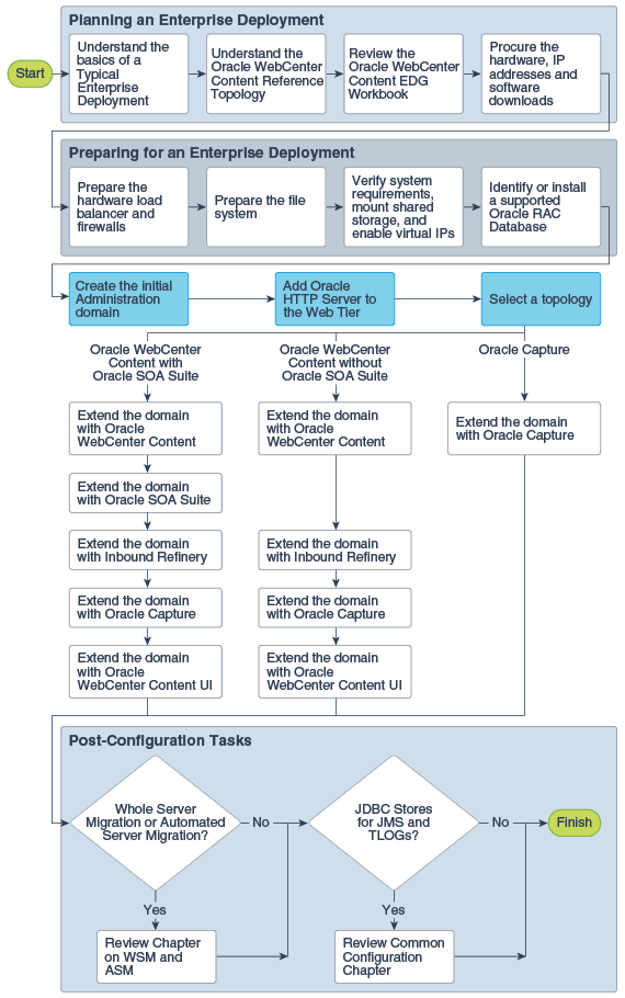

Flow Chart and Roadmap for Implementing the WebCenter Content Enterprise Topology
It is essential to understand the steps that you need to perform to install and configure the WebCenter Content enterprise topology.
Flow Chart of the Steps to Install and Configure the WebCenter Content Enterprise Topology
Figure 3-1 shows a flow chart of the steps required to install and configure the primary enterprise deployment topologies described in this chapter. The sections following the flow chart explain each step in the flow chart.
This guide is designed so you can start with a working WebCenter Content domain and then later extend the domain to add additional capabilities.
This modular approach to building the topology allows you to make strategic decisions, based on your hardware and software resources, as well as the Oracle WebCenter Content features that are most important to your organization.
It also allows you to validate and troubleshoot each individual product or component as they are configured.
This does not imply that configuring multiple products in one Configuration Wizard session is not supported; it is possible to group various extensions like the ones presented in this guide in one Configuration Wizard execution. However, the instructions in this guide focus primarily on the modular approach to building an enterprise deployment.
Figure 3-1 Flow Chart of the Enterprise Topology Configuration Steps
Description of "Figure 3-1 Flow Chart of the Enterprise Topology Configuration Steps"
Roadmap Table for Planning and Preparing for an Enterprise Deployment
The following table describes each of the planning and preparing steps shown in the enterprise topology flow chart.
Flow Chart Step | More Information |
Understand the basics of a Typical Enterprise Deployment |
Understand the specific reference topology for the products that you plan to deploy |
Review the product-specific topologies and the description of the topologies, including the virtual servers required and the summary of clusters and Managed Servers recommended for the product-specific deployment. |
Review the Oracle WebCenter Content EDG Workbook |
Procure the hardware, IP addresses, and software downloads |
Prepare the hardware load balancer and firewalls |
Preparing the Load Balancer and Firewalls for an Enterprise Deployment |
Prepare the file system |
Verify system requirements, mount shared storage, and enable virtual IPs |
Identify or install a supported Oracle RAC Database |
Roadmap Table for Configuring the Oracle WebCenter Content Topology
The following table describes each of the configuration steps required when configuring the topology shown in Diagram of the WebCenter Content Enterprise Deployment Topology.
These steps correspond to the steps shown in the flow chart.
