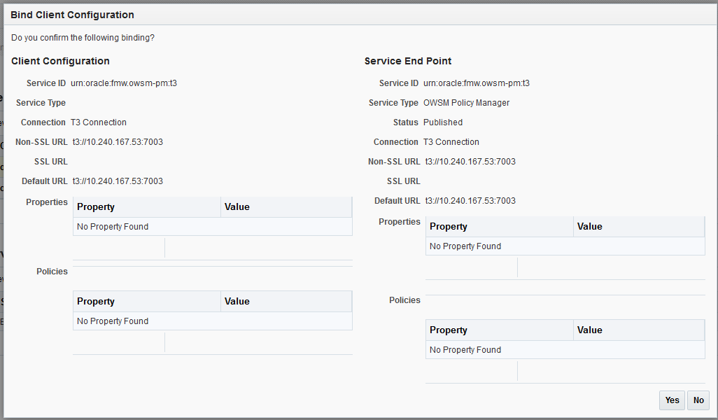

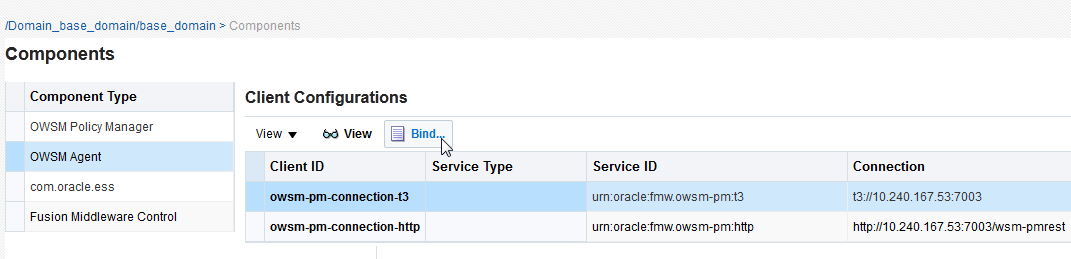

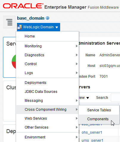

Updating OWSM Cross-Component Wiring
After you have removed OWSM targets from SOA and OSB clusters as described in Removing OWSM Targets from SOA and OSB Clusters, you must rewire the OWSM Policy Manager components as described below:
  1. Start the Administration (admin) server and one OWSM server.

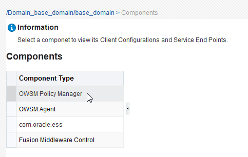

  2. Log in to the Oracle Enterprise Manager Fusion Middleware Control 12c console and navigate to the Cross Components Wiring > Components option.

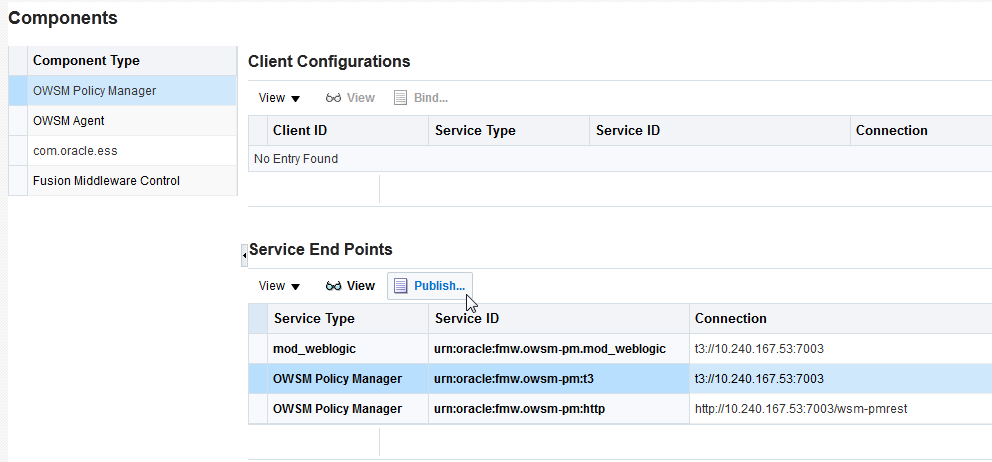

  3. Select OWSM Policy Manager from the list of available components:
  4. From the Service End Points table, select the OWSM Policy Manager t3 connection entry and click Publish. The status will change from Out of Sync to Published.
  5. Select OWSM Agent from the Component Type list. Select the t3 connection entry and click Bind.
  6. Verify that the Service Type for the service end point is OWSM Policy Manager.
  7. Repeat steps 5 and 6 to Bind the remaining component types. In this example, you will select com.oracle.ess and Fusion Middleware Control.
