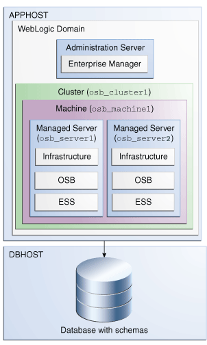

Use this topology to integrate the capabilities of Oracle Enterprise Scheduler with Oracle Service Bus.
The topology is similar to the Oracle Service Bus standard installation topology, described in unresolvable-reference.html; however, in this topology, the Oracle Enterprise Scheduler software is targeted to the Oracle WebLogic Server cluster, in addition to the Oracle Fusion Middleware Infrastructure and Oracle Service Bus software.
Description of inosb_osb_ess_topo.png follows

On the Managed Servers screen (Configuring Managed Servers for Oracle Service Bus), two managed servers, osb_server1 andess_server1, are created. Delete ess_server1 and create osb_server2. Ensure that in the Listen Address drop-down list, you select the IP address of the host on which the Managed Server will reside. Do not use All Local Addresses.
In the Server Groups drop-down list, ensure that osb_server1 and osb_server2are targeted to OSB-MGD-SVRS_COMBINED and ESS_MGD_SVRS.
Assign Servers to Clusters
On this screen (Assigning Oracle Service Bus Managed Servers to the Cluster), assign both osb_server1 and osb_server2 toosb_cluster1.
Assign Servers to Machine
On this screen (Assigning Servers to Oracle Service Bus Machines), assign the AdminServer, osb_server1 andosb_server2 to osb_machine1.
