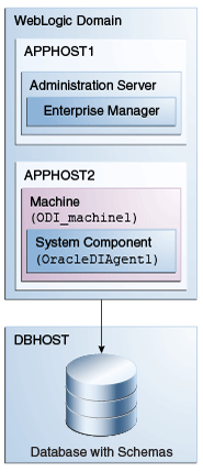

About the Oracle Data Integrator Standalone Collocated Agent Standard Installation Topology
This installation topology represents a standalone agent configured in a WebLogic domain, managed by an Administration Server and Node Manager. The domain is configured on a single host and requires a supported database where the required Fusion Middleware schemas are installed.
Figure 1-1 shows the standard installation topology for the standalone collocated agent.
Figure 1-1 Standard Installation Topology for the Standalone Collocated Agent
Description of "Figure 1-1 Standard Installation Topology for the Standalone Collocated Agent"
For configuration instructions, see Configuring the Domain for a Standalone Collocated Agent.
Table 1-2 describes all elements in this standard installation topology.
Table 1-2 Description of the Elements in the Standalone Collocated Agent Standard Installation Topology
| Element | Description and Links to Additional Documentation |
APPHOST |
Standard term used in Oracle documentation referring to the computer that is hosting the application tier. |
DBHOST |
Standard term used in Oracle documentation referring to the computer that is hosting the database. |
Administration Server |
The central control entity of a domain which maintains the domain's configuration objects and distributes configuration changes to Managed Servers. See What Is the Administration Server? in Understanding Oracle Fusion Middleware. |
Enterprise Manager |
Oracle Enterprise Manager Fusion Middleware Control. See Oracle Enterprise Manager Fusion Middleware Control in Understanding Oracle Fusion Middleware. |
Machine |
Logical representation of the computer that hosts one or more WebLogic Server instances (servers). Machines are also the logical glue between WebLogic Managed Servers and the Node Manager; in order to start or stop a Managed Server with Node Manager, the Managed Server must be associated with a machine. |
System Component |
A standalone process that is managed by the WebLogic Management Framework. A system component corresponds to a standalone agent. See What Is a System Component? in Understanding Oracle Fusion Middleware. |
