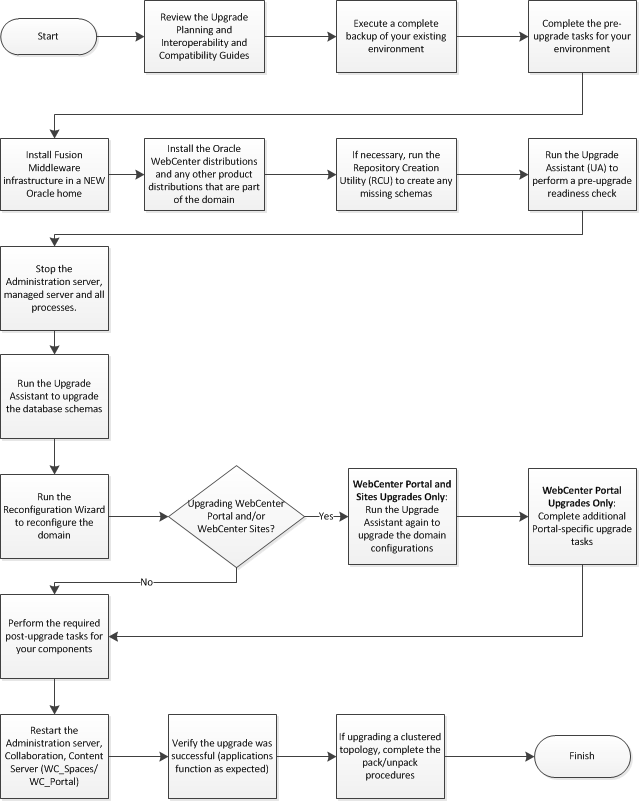

About the Oracle WebCenter Upgrade Process
Review the process flow for upgrading WebCenter products to get a better understanding of the upgrade procedures and when you will perform them.
This process flow shows the high-level procedures for upgrading a WebCenter domain to 14c (14.1.2.0.0). The actual procedures you will perform depends on your pre-upgrade environment and the components you will be upgrading.
Figure 3-1 Upgrading Oracle WebCenter to 14c (14.1.2.0.0)
Description of Figure 3-1 follows
Description of "Figure 3-1 Upgrading Oracle WebCenter to 14c (14.1.2.0.0)"
Task Description
Required
Complete all of the Oracle Fusion Middleware standard pre-upgrade tasks, as well as any additional component-specific tasks you may be required to perform.

Required
Stop the Administration Server, Managed Servers and any other running applications in your existing deployment.
Failure to shut down the existing environment during the upgrade can corrupt your schemas and/or component configurations.
Required
Run the Upgrade Assistant to upgrade individually selected schemas or all schemas used by the domain.
Oracle recommends that you allow the Upgrade Assistant to upgrade all schemas within the selected domain whenever possible.
Required
Run the Reconfiguration Wizard to reconfigure the domain.
Required
Complete all of the required post-upgrade tasks described in your component-specific documentation.
Some components will not work correctly if these tasks are not performed after the upgrade.
Performing Post-Upgrade Configuration Tasks
Required
Restart the administration server and the managed servers.
Required
Verify the upgrade was successful (applications function as expected, etc.)
Verifying the New Applications Work as Expected
Optional
Upgrade WebCenter for a cluster topology, if applicable
Upgrading WebCenter in a Clustered Topology
