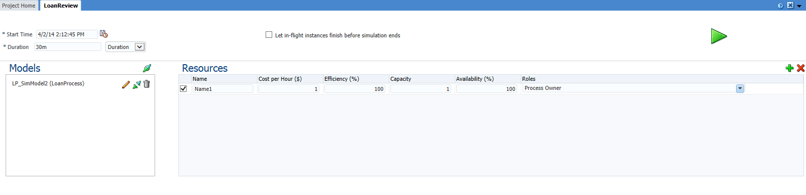

Resource Parameters
Resources define the simulated resources within your organization. Resources are defined in a simulation definition and can be shared between each of the process models that are included. These resources can be associated with a specific role within your project. You can use these parameters together to create a resource profile that determines the expense, time, and efficiency of a person or group.
The following resource parameters are supported:
Name: Defines the name of the resource.
Cost per hour: Specifies the cost of the resource per hour when performing an activity.
Efficiency: Specifies how efficient the resource is when performing an activity.
This parameter is used when selecting the Maximum efficiency policy when defining how organizational resources are allocated.
See Activity Parameters for more information.
Capacity: Specifies how many activities can be performed at one time.
Availability: Specifies the percentage of time this resource is available.
Roles: Specifies the roles associated to this resource.

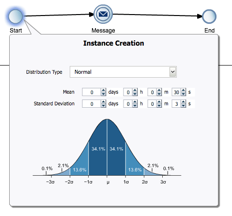

Start Event Parameters
To simulate the behavior and performance of start events, Oracle BPM uses a statistical model that simulates the probability of a certain behavior. You must select the statistical distribution that Oracle BPM uses.
The following distribution types are available:
Constant: Triggers the start event at a specific interval.
For example, if you specify a period of 1 minute and 15 seconds, the event is triggered every 1 minute and 15 seconds. Each time the event is triggered, a new instance of the process is created.
Uniform: Triggers the start event at intervals within a specific margin specified by the mean and delta parameters.
For example, if you define the mean as 30 seconds and the delta as 3 seconds, the start event creates a new instance in intervals between 27 and 33 seconds, with an equal probability.
Exponential: Triggers the start event a specified number of times within a certain interval.
For example, if you define the frequency as 10 and the interval as 1 hour, the event is triggered 10 times per hour. The distribution of events is based on exponential distribution.
Normal: Triggers the start event based on normal, or Gaussian, distribution.
This is a continuous probability distribution that is based on a bell curve. For example, if you define a mean of 10 minutes and a standard deviation of 2 minutes, the event triggers according to the probabilities shown in Figure 8-1.
Figure 8-1 Simulation - Normal Distribution in a Start Event
Description of "Figure 8-1 Simulation - Normal Distribution in a Start Event"In this example, the event has a 62.8 percent probability of triggering in an interval between 8 and 12 minutes.
Real: Triggers the start event based on user-specified intervals: hourly, daily, weekly, or monthly.
You can define the mean and standard deviation for each interval. Using these parameters, the start event creates new process instances using normal distribution.
For example, you can specify a daily distribution with a mean of 5 minutes and a standard deviation of 1 minute for weekdays and a mean of 1 hour and a standard deviation of 10 minutes for weekends.

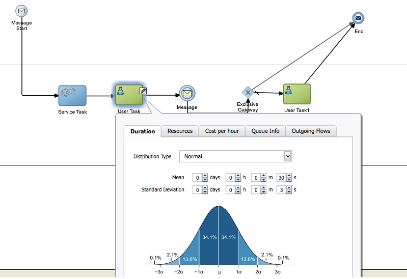

Activity Parameters
In addition to start events, you can define parameters that determine the simulated behavior or interactive and automatic activities within a process. You define these parameters using the tabbed panes of the simulation editor. Figure 8-2 shows an example of the tabbed panes of an interactive activity.
Figure 8-2 Simulation Parameters for an Interactive Activity
Description of "Figure 8-2 Simulation Parameters for an Interactive Activity"
The simulation parameters for activities are:
Duration: Defines the statistical model used to determine the amount of time required to perform an activity.
The statistical models used are similar to those defined for start events except, instead of defining how often an event is triggered, they define how long it takes to perform the work of a specific activity.
See Start Event Parameters for a description of each distribution type.
Resources (interactive activities only): Defines how many interactive activities can be performed simultaneously.
You can define how simulated resources are allocated to this activity.
Organizational resources: Resources shared between all the processes within a simulation definition.
You must specify the policy that determines how the simulated participants are selected to perform the activity.
Minimum cost: Selects less costly resources first.
Maximum efficiency: Selects the most efficient resources first.
Random: Randomly selects between Minimum cost and Maximum efficiency.
See Resource Parameters for information on defining organization resources within a simulation definition.
Fixed resources: explicitly defines the number of resources available to perform the interactive activity.
Threads (available only for automatic activities): Defines the number of simulated threads that are used to perform an automatic activity.
Cost per hour: Defines the cost required to perform the activity.
Use this parameter to create cost-base reports.
Activity Cost Type: Can be defined as a base cost or as a base cost plus the cost of resources assigned to perform the activity.
Activity Fixed Base Cost: Defines the value (specified as a decimal number) of the fixed base cost.
Queue info: Specifies the maximum size of the queue for this activity.
This is the number of instances that are currently waiting at this activity. When this number reaches the maximum size, the simulation issues a warning.
Outgoing flows: Specifies the probability (defined as a decimal number) of a process instance continuing along each of the outgoing sequence flow.
If only one outgoing sequence flow is defined, the probability is specified as 1 and cannot be changed.

What Happens When You Create a Simulation Definition
After creating a new simulation definition and simulation models, the simulation panel appears as shown in Figure 8-5.
Figure 8-5 Project Welcome Page - Simulations: After Creating Simulation Definitions
Description of "Figure 8-5 Project Welcome Page - Simulations: After Creating Simulation Definitions"
This panel displays all the simulation definitions defined in your project.
From this panel you can open a simulation definition and perform the following tasks:
Edit a simulation definition.
See How to Edit a Simulation Definition for more information.
Run a simulation.
See How to Run a Simulation for more information.
Edit a simulation model.
See How to Edit a Simulation Model for more information.

How to Create a New Simulation Model
You can create multiple simulation models for a process. Different models can be included in different simulation definitions to determine performance based on different parameter settings.
You cannot directly create the first simulation model for a process. The first simulation model for a process must be created using the simulation definition wizard. After creating the initial simulation model, you can create additional models using the following procedures.
See How to Create a Simulation Definition for information about creating a simulation model when creating a simulation definition.
To create a new simulation model for a process
The new simulation model is created. You can use this model when creating a new situation definition or editing an existing one. See How to Associate a Simulation Model to a Simulation Definition for more information.
Running Simulations
After defining a simulation model and simulation definitions, you can run the simulation to view the performance of your BPM project.
To run a simulation, you must have created at least one simulation definition and simulation model for each of the processes you want to test.
