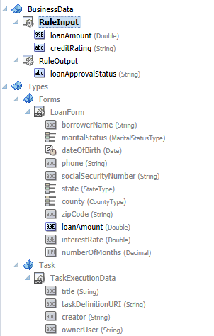

The following example process defines two different complex data types to handle the required data. Figure 14-1 shows how these appear in the business component editor.
Figure 14-1 Complex Data Types Defined in the Example Project
Description of "Figure 14-1 Complex Data Types Defined in the Example Project"

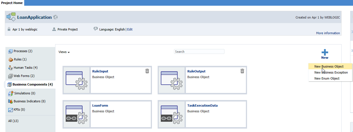

You can create the following new business components from the project components panel located on the Project Welcome page, as shown in Figure 14-2:
Business object
Business exception
Enum object
Figure 14-2 Project Welcome Page - Business Components
Description of "Figure 14-2 Project Welcome Page - Business Components"
Creating a New Business Object
To create a new business object:
From the Project Welcome Page, click Business Components.
Click the New icon, then select New Business Object to open the New Business Object wizard, as shown in Figure 14-3.

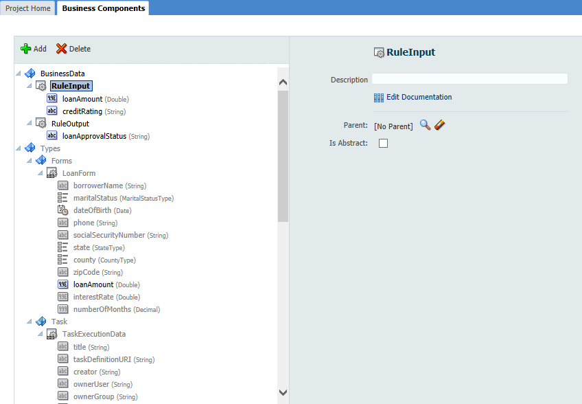

How to Edit a Complex Data Type
After creating a complex data type, you can add or change the type of its attributes and methods, or add documentation. You can also add exceptions, Enum objects and Enum items. The components you can add are based on the component you have highlighted in the hierarchy, as shown in Figure 14-7
Figure 14-7 Add New Business Component Example
Description of "Figure 14-7 Add New Business Component Example"
When you highlight a business component in the hierarchy, its details appear on the right-hand side of the business components editor. You can edit the details or add documentation.
If you right-click on a component in the hierarchy you can select to delete the component, move the component, or collapse a section of the hierarchy.
To add a new module, a new complex data type, or attribute:
Click the complex data type you just created.
The business components editor opens, as shown in Figure 14-8.
