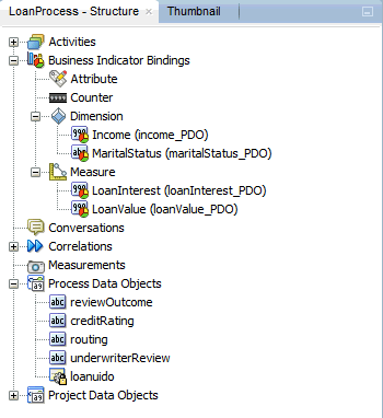

The Structure window shows the different data structures in your project: data objects, project data objects, and business indicators. For callable process it also shows arguments.
Figure 5-1 Shows the Structure window for a process that defines business indicators and process data objects.

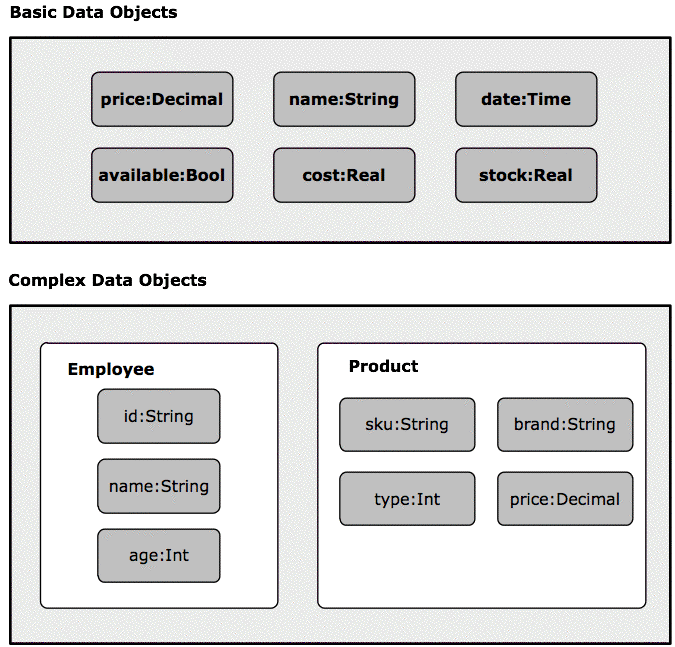

Basic Data Objects versus Complex Data Objects
Basic data objects are defined using basic data types such as int, boolean or string.
Complex data objects are defined using business objects and can group data. See Modeling Business Objects for more information on how to define business objects.
Business objects include data structures based on basic data objects. For example, you can create a complex data object called employee that contains different data types for employee name, ID, and salary.
The structure of complex data objects is the same for all the process instances of a process. However the data values they contain are specific to each instance of a process.
Figure 5-2 shows the relationship between basic data objects and complex data objects.
Figure 5-2 Basic Data Objects versus Complex Data Objects
Description of "Figure 5-2 Basic Data Objects versus Complex Data Objects"

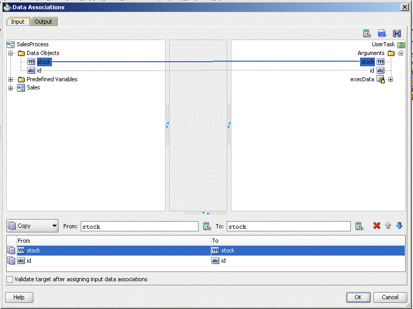

You can also add process data object from the Data Object tree in the Simple Expression Builder, XPath Expression Builder, and Data Association Dialog.

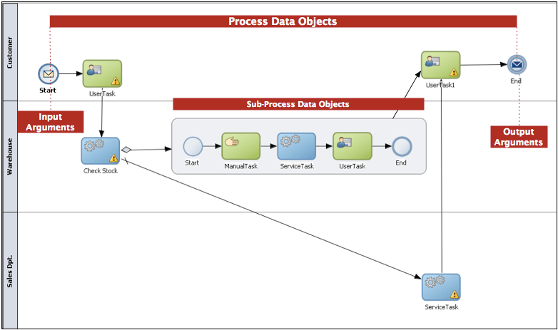

Introduction to Subprocess Data Objects
You can define data objects for a certain subprocess. These data objects are available only when the subprocess is running. When the instance leaves the subprocess the value of subprocess data objects is lost.
Using subprocess data objects is a good practice because:
It reduces the number of unnecessary data objects in the main process, making it simpler and easier to read.
By reducing the number of process data objects, it reduces the amount of memory each process instance occupies.
It makes the subprocess easier to understand.

From within a subprocess you can access process data objects and subprocess data objects. If the name of a subprocess data object matches the name of a process data object, then when you access the data object you obtain the value of the subprocess data object.

Use arguments to pass data between the different components in a process.
A component may require you to provide certain data when you invoke it. To pass this data you use input arguments. When you run a component, it provides results through its output arguments.

Scope and Access
The scope and access to process data objects, subprocess data objects, project data objects, and arguments varies according to the structure used to store information.
Process Data Objects: You can access them from any task within the process. The Process Engine creates them when it creates an instance in the process. Generally the process data objects have different values for each instance in the process. After the instance arrives to the end event, you cannot access process data objects anymore.
Subprocess Data Objects: You can access them from any task within a subprocess. The Process Engine creates them when the subprocess is triggered. After the instance leaves the subprocess, these data objects are no longer available.
Project Data Objects: You can define project data objects at a project level. However, the scope of project data objects is a process. Project data objects are predefined for all the processes in a BPM project. The value of a project data object may vary between processes. Generally project data objects have different values for each instance in the process. You can access project data objects from any process in a project, however the value assigned to it during a process is lost when the process finishes running. Figure 7-12 shows the difference between the scope and the life span of project data objects.
Arguments: You can only access arguments from within data associations. You use arguments to pass information between processes or process components. When the Process Engine runs a process or a process element that contains a data association, it maps the value of the arguments to the data objects defined in the data association.
Figure 5-3 shows the scope of input arguments, process data objects, subprocess data objects and output arguments. The image shows a BPMN process and the red bars with the variables name show the scope where those variables are available.
Figure 5-3 Scope of the Data Structures in a Process
Description of "Figure 5-3 Scope of the Data Structures in a Process"

Introduction to the Data Association Editor
The data associations editor enables you to configure the input and output values passed between a flow object and a its implementation.
Figure 5-5 shows the data association for the Enter Quote user task in the Sales Quote example.
Table 5-4 describes the different areas of the data association editor.
Table 5-4 The Data Association Editor User Interface
| UI Area | Description |
                                     Input Tab  |
                                     Contains text boxes that display the data objects assigned as inputs to the service or process implemented in the flow object. Next to each text box is an icon that launches the expression editor  |
                                     Output Tab  |
                                     Contains text boxes that display the data objects assigned as outputs from the service or process implemented in the flow object.  |
                                     Flow Object Tree  |
                                     Contains an Arguments node that lists all the expected argument. According to the tab you selected it lists input or output arguments. You can expand complex data objects to map to specific basic data objects within a complex data object.  |
                                     Data Objects Tree  |
                                     Displays all the data objects. This tree contains process data objects, predefined data objects and project data objects.You can expand complex data objects to map to specific basic data objects within a complex data object.  |
