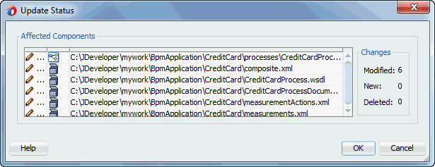

Updating locally stored BPM projects

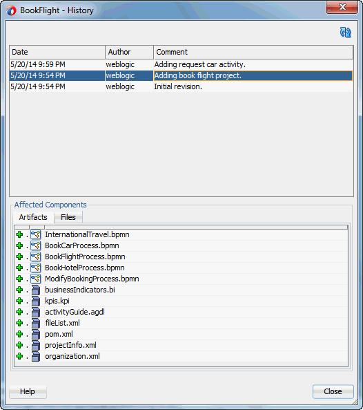

Viewing the change history

How to Update Local BPM Projects
You can update your local BPM project with the changes made to the BPM Project in the Process Asset Manager.
To update local BPM projects:
