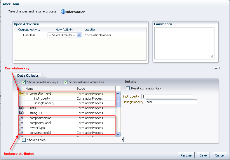

How to Alter the Flow of Running Process Instances in Process Workspace
To alter the flow of a running process instance:
If you have opened the Alter Flow dialog box and the session times out before you have taken any action, then the process instance is suspended.
If an activity has more than one running token associated with it, you cannot alter the flow to select and move just one of the tokens to another valid target activity. If you alter the flow for that open activity, then all the tokens move.
The process instance state may not update to show the new state. Click Refresh in the table toolbar to see the updated state.

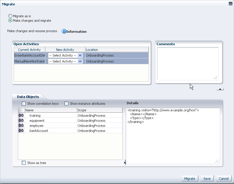

How to Migrate a Process Instance in Process Workspace
You can migrate a process instance in either of two ways:
Migrate as is: Migrate the instance without moving the token or updating the payload
Make changes and migrate: Move the token to the new activity you specify, and update the payload as you specify, then migrate the instance
To migrate process instances:

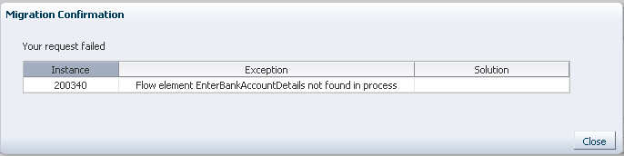

If for some reason the migration fails, then the Migration Confirmation dialog box tells you why, as shown in Figure 11-3.
Figure 11-3 Migration Confirmation: Failure Message
Description of "Figure 11-3 Migration Confirmation: Failure Message"

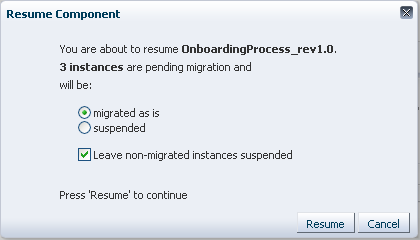

How to Resume a Suspended Component

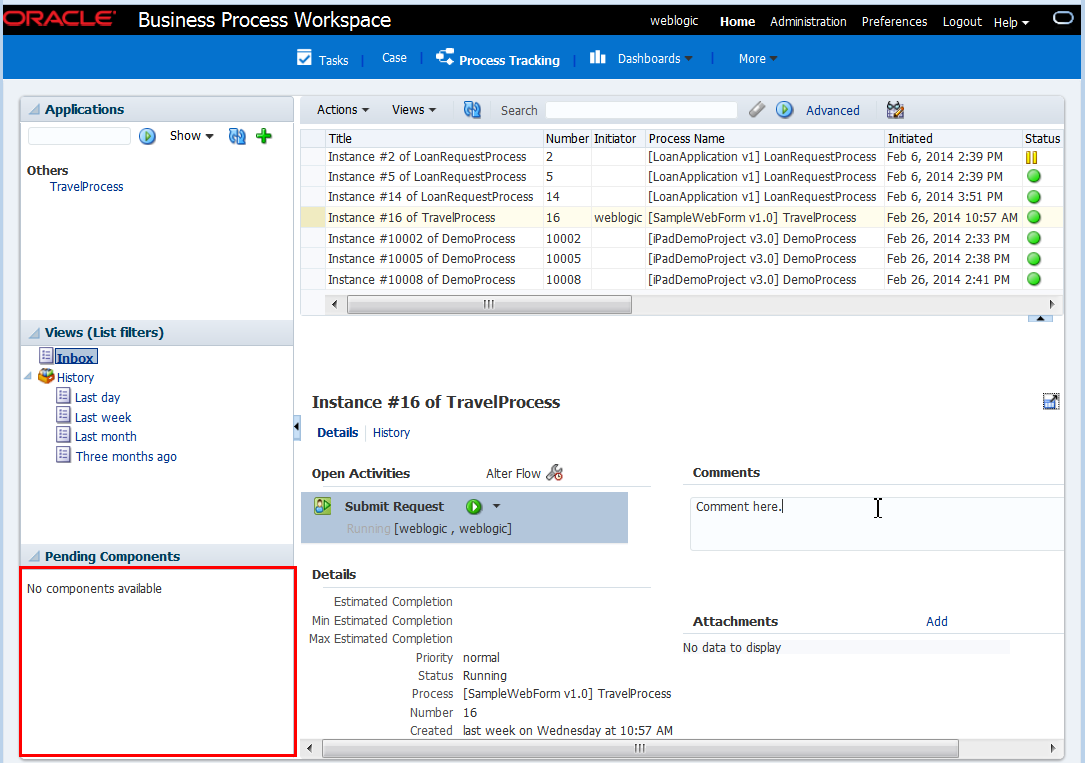

All suspended components are listed in the Pending Components panel, as shown in the example in Figure 11-4.
Figure 11-4 Pending Components Panel in the Process Tracking Tab Page
Description of "Figure 11-4 Pending Components Panel in the Process Tracking Tab Page "
To resume a suspended component:

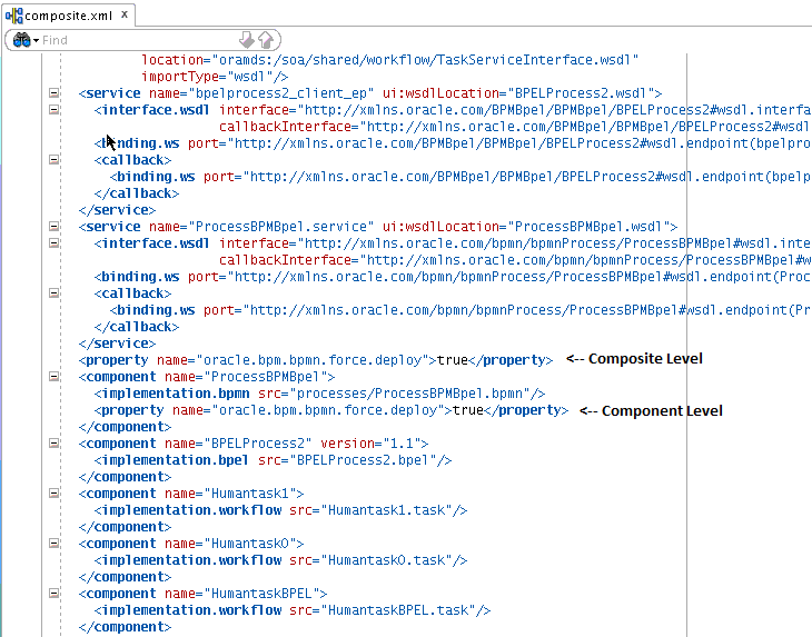

To avoid failure of process redeployment in these scenarios, set the force.deploy flag manually by editing the composite.xml file in Oracle JDeveloper.
Ensure that the change to the workflow is compatible with the process, before you set the force.deploy flag. If the change to the workflow is not compatible with the process, the deployment process fails and the component is suspended. Resume the suspended component.
To set force.deploy at the component level, enter the following:
<component name="T4"> <property name="oracle.bpm.bpmn.force.deploy">true</property> <implementation.bpmn src="processes/T4.bpmn"/> </component>
To set the force.deploy at the composite level, you can use the same .xml element as a child of the composite element as shown in the example in Figure 11-6.
Figure 11-6 Setting the force.deploy Property in Oracle JDeveloper
Description of "Figure 11-6 Setting the force.deploy Property in Oracle JDeveloper"

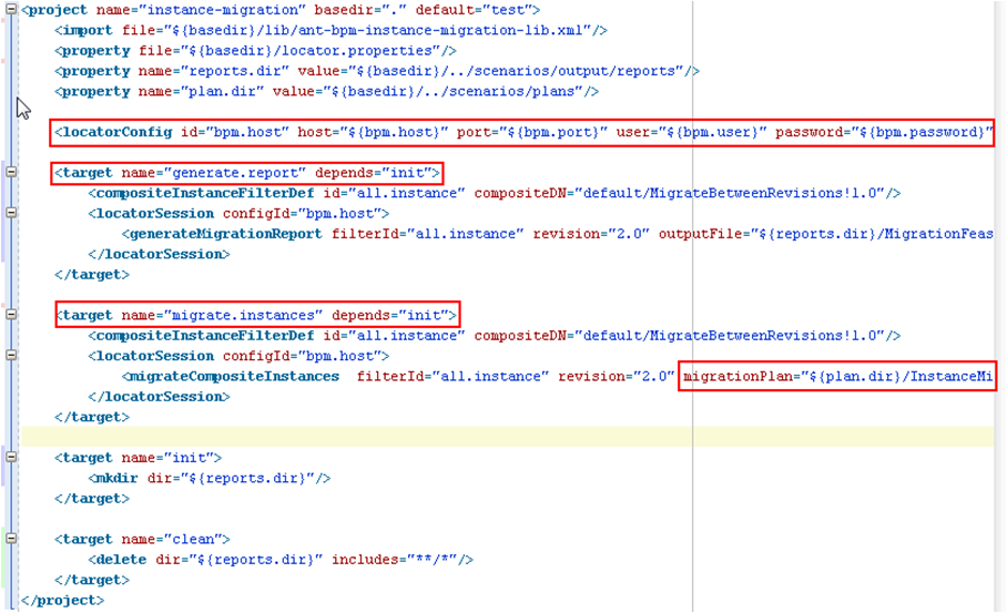

This feature is implemented by using Ant commands.
These commands require the following artifact that is part of your installation:
/AS11gR1SOA/bin/ant-composite-instance-migration.xml.Note that this artifact requires
wlfullclient.jarin the following directory:$FMW_HOME/wlserver_10.3/server/libTo generate the Oracle WebLogic Server client library:
cd $fmw.home/wlserver_10.3/server/lib java -jar wljarbuilder.jar
