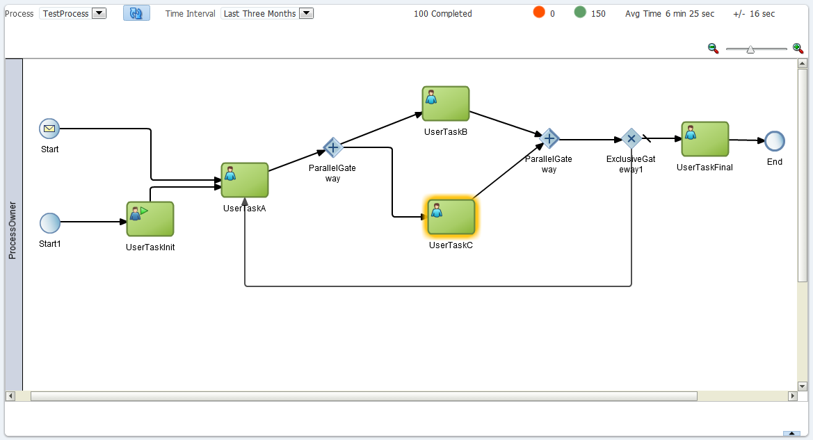

Using the Process Monitor Dashboard
Use the Process Monitor dashboard to monitor process execution performance and identify problems with processes and activities.
Use the process monitor dashboard to select the process to monitor, the time interval over which to view statistics, and to view information and see alerts that enable you to identify process issues that are affecting performance.
In addition, other activity performance statistics related to the activities in the processes are generated and accessible for inspection.
The process monitor dashboard, as shown in Figure 6-1 includes the following controls:

Process diagram - interactive diagram of the process, including swimlanes showing roles.
Restore Pane - displays the performance graphs
Identifying and Viewing Alerts and Other Activity Metrics
Activities that have processing issues such as bottlenecks, appear with a yellow or red halo around them, as shown in Figure 6-1.

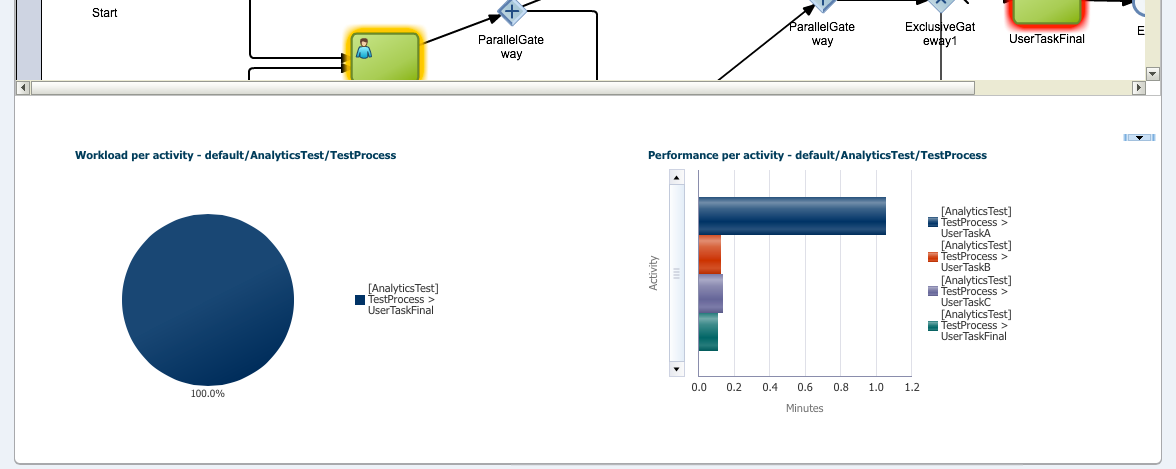

Viewing Performance Graphs
To view performance graphs, click Restore Pane in the lower right corner of the process monitor dashboard. This opens the performance graphs pane as shown in Figure 6-2
Figure 6-2 Process Monitor Dashboard Performance Graphs
Description of "Figure 6-2 Process Monitor Dashboard Performance Graphs"
Two graphs are provided - Workload per activity, and Performance per activity. Click the graph elements to display more information about them. These are similar to the graphs discussed in Using Standard Dashboards.

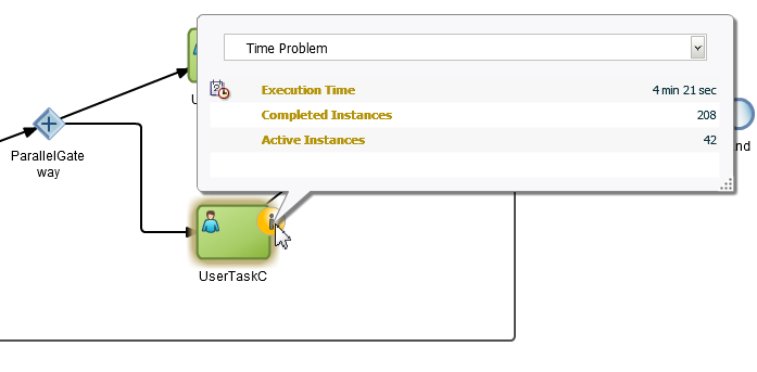

About the Activity Details Dialog
Process monitoring information for activities clicked in the process diagram are displayed in a pop-up Activity Details dialog box.
To see the details for activities with issues, hover over the activity and click the information icon that appears, as shown in Figure 6-3
Figure 6-3 Activity With Processing Alert and Information Icon
Description of "Figure 6-3 Activity With Processing Alert and Information Icon"
Activity details are displayed in the Activity Details dialog. Select a different type of detail by selecting it from the drop-down list.

Time Problem
A time problem is generated when the time an activity takes to execute a single instance is long enough to impact the overall execution time of the process.
For each process, both the elapsed time and estimated time to completion are calculated (as well as their average, maximum, minimum and variance). These are based on previously completed process instances that have followed the same execution paths as the in-progress processes.
Fields displayed include:

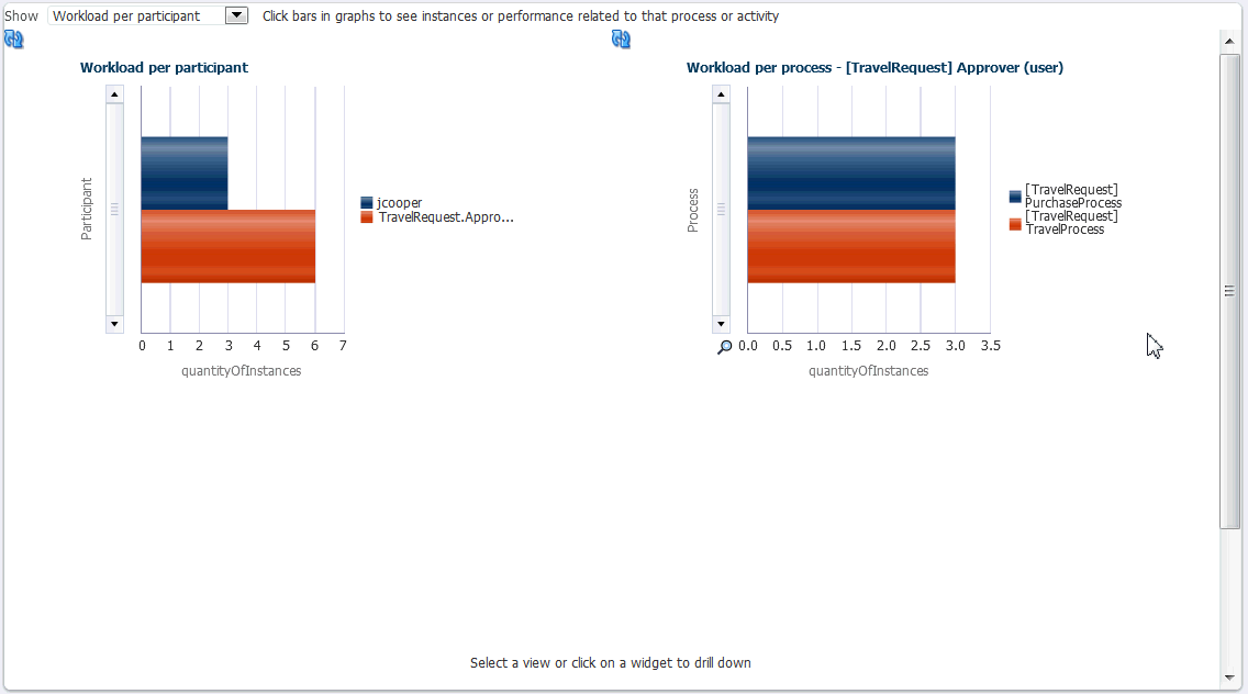

Participant Workload Dashboard
Figure 6-5 shows an example of a participant workload dashboard.
The left panel of a participant workload dashboard displays the total number of active instances waiting for completion for each participant across all processes. When you navigate into the chart for a specific participant, the right panel displays the total number of active instances waiting for completion by process for either the selected participant or the selected role. The last drill-down displays the active instances waiting for completion for either the selected participant or the selected role and process.

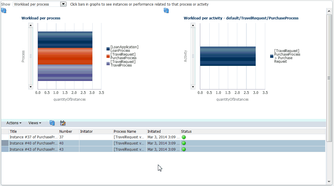

Process Workload Dashboard
Figure 6-6 shows a process workload dashboard.
The left panel in the process workload dashboard displays the total number of active instances waiting for completion per process. When you navigate into a specific process, the right panel displays the total number of active instances waiting for completion for activities in the selected process. The last drill-down displays the active instances waiting for completion for the selected activity and process.
