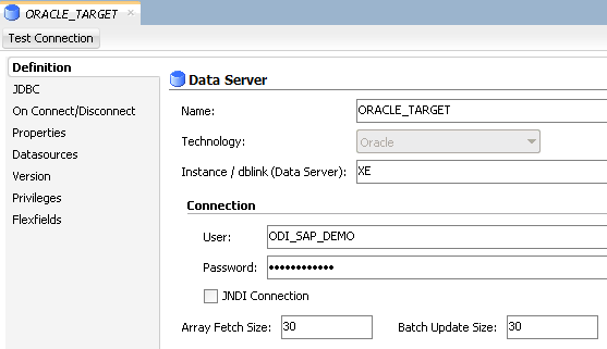

Right-click and select New Data Server.
Enter the data server Definition as shown below:

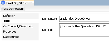

Select the JDBC tab, and enter the JDBC connection information to your data server as shown below:
Make sure to change the URL to match your Oracle instance configuration.
Click Test Connection to test the connection to this data server.
From File menu, click Save.

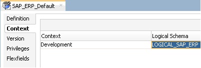

Go to the Context tab.
Click Add and enter in the Logical Schema field the value
ODI_SAP_DEMO. -
From the File menu, click Save.
