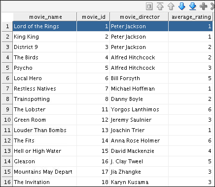

The populated Hive table appears as shown in the figure below.
Figure 9-2 Populated Hive Table
Description of Figure 9-2 follows
Description of "Figure 9-2 Populated Hive Table"

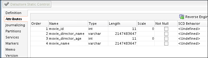

On reverse-engineering the movierating2 table in ODI, it appears as shown in the figure below.
Figure 9-3 Reverse-engineered movierating2 table
Description of Figure 9-3 follows
Description of "Figure 9-3 Reverse-engineered movierating2 table"

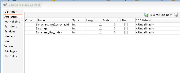

This table does not contain the ratings attribute. However, the JDBC driver exposes a virtual table called movierating2_ratings.
On reverse-engineering this virtual table in ODI, it appears as shown in the figure below.
Figure 9-4 Reverse-engineered movierating2_ratings table
Description of Figure 9-4 follows
Description of "Figure 9-4 Reverse-engineered movierating2_ratings table"

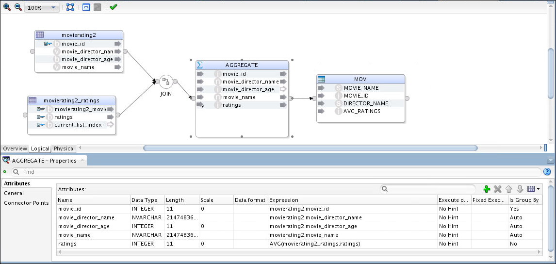

In this example, the target HDFS file requires that the name is extracted from the movie_director UDT along with the average of the values from the ratings list.
To accomplish this, a mapping is required which joins the movierating2 and movierating2_ratings tables, and averages the ratings for each movie.
The mapping is as shown in the figure below:
Figure 9-5 Mapping to join movierating2 and movierating2_ratings tables
Description of Figure 9-5 follows
Description of "Figure 9-5 Mapping to join movierating2 and movierating2_ratings tables"
The key point here is that for Cassandra Complex Types, the Flatten component is not required to access the complex fields in the mapping. You'll notice that the similar Hive mapping in Using Flatten for Complex Types in Hive Mappings is designed differently.
