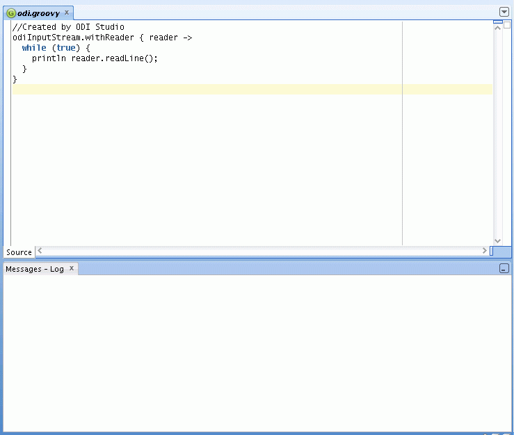

Read Input with odiInputStream Variable
Oracle Data Integrator provides the odiInputStream variable to read input streams. This variable is used as follows:
odiInputStream.withReader { println (it.readLine())}
When this feature is used an Input text field is displayed on the bottom of the Log tab. Enter a string text and press ENTER to pass this value to the script. The script is exited once the value is passed to the script.
Example 16-1 shows another example of how to use an input stream. In this example you can provide input until you click Stop <script_name>.
Example 16-1 InputStream
odiInputStream.withReader { reader ->
while (true) {
println reader.readLine();
