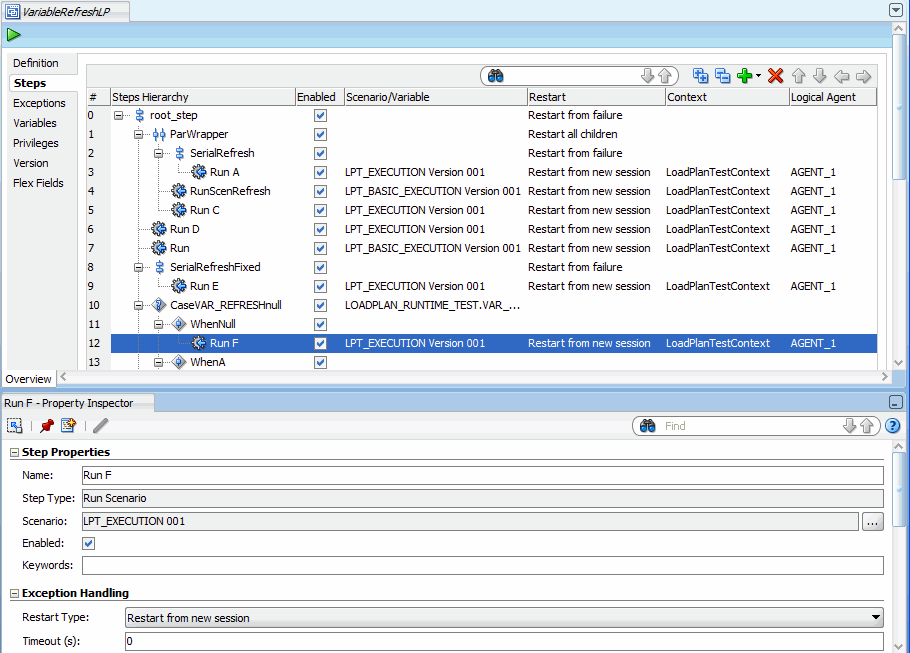

13.1.4 Introduction to the Load Plan Editor
The Load Plan Editor provides a single environment for designing Load Plans. The figure below gives an overview of the Load Plan Editor.
Figure 13-2 Steps Tab of the Load Pan Editor
Description of "Figure 13-2 Steps Tab of the Load Pan Editor"
The Load Plan steps are added, edited and organized in the Steps tab of the Load Plan Editor. The Steps Hierarchy table defines the organization of the steps in the Load Plan. Each row in this table represents a step and displays its main properties.
You can drag components such as packages, integration mappings, variables, procedures, or scenarios from the Designer Navigator into the Steps Hierarchy table for creating Run Scenario steps for these components.
You can also use the Add Step Wizard or the Quick Step tool to add Run Scenario steps and other types of steps into this Load Plan. See Adding Load Plan Stepsfor more information.
The Load Plan Editor toolbar, located on top of the Steps Hierarchy table, provides tools for creating, organizing, and sequencing the steps in the Load Plan. The figure below details the different toolbar components.

The Properties Panel, located under the Steps Hierarchy table, displays the properties for the object that is selected in the Steps Hierarchy table.

13.2.2.2 Editing Load Plan Steps
To edit a Load Plan step:
Open the Load Plan editor and go to the Steps tab.
In the Steps Hierarchy table, select the Load Plan step you want modify. The Property Inspector displays the step properties.
Edit the Load Plan step properties according to your needs.

To view and edit the linked object of Run Scenario steps:
In the Steps Hierarchy table of the Steps or Exceptions tab, select the Run Scenario step.
Right-click and select Open the Linked Object.
The Object Editor of the linked object is displayed.

Define the Exception and Restart Behavior
Exception and Restart behavior can be set on the steps in the Steps Hierarchy table. See Handling Load Plan Exceptions and Restartability for more information.

The Restart Type option defines how a step in error restarts when the Load Plan is restarted. You can define the Restart Type parameter in the Exception Handling section of the Properties Inspector.
Depending on the step type, the Restart Type parameter can take the values listed in the table below.
Table 13-5 Restart Type Values
