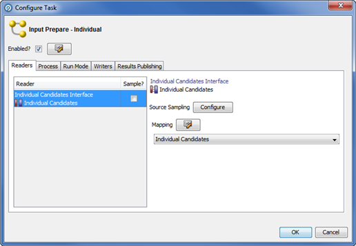

Create the Input mappings as follows:

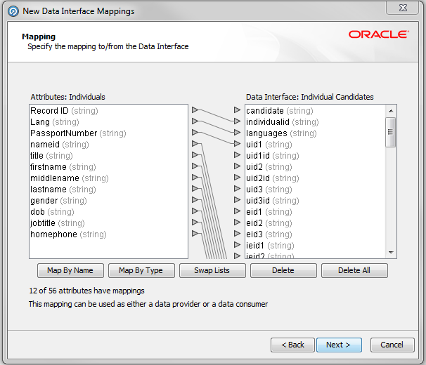

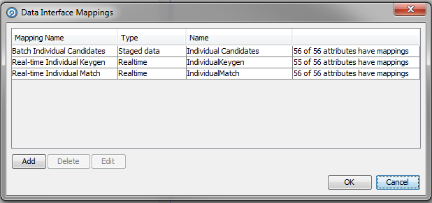

Right-click the Individual Candidates and select Mappings... to open the Mappings dialog.
Click Add to open the New Mappings dialog.
Select the Individuals snapshot as the source and click Next. The Staged data default type is used.
Map the Customer Data Attributes on the left of the dialog to the Attributes on the right as follows:
In some instances, it may be necessary to construct a process that reads from the snapshot and reshapes the data to match the , see Converting Data to the Interface Format.
Click Next.
Name the mapping Individual Candidates and click Finish to save.
Click OK.

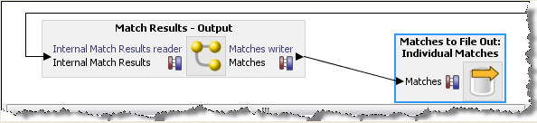

Create a new server-side delimited text data store called File Out: Individual Matches to use as a target for the match results. Alternatively, the data can be written to a database if required.
Create a new export called Matches to File Out: Individual Matches that uses the Matches as the source to export from, and the File Out: Individual Matches as the target for the export.

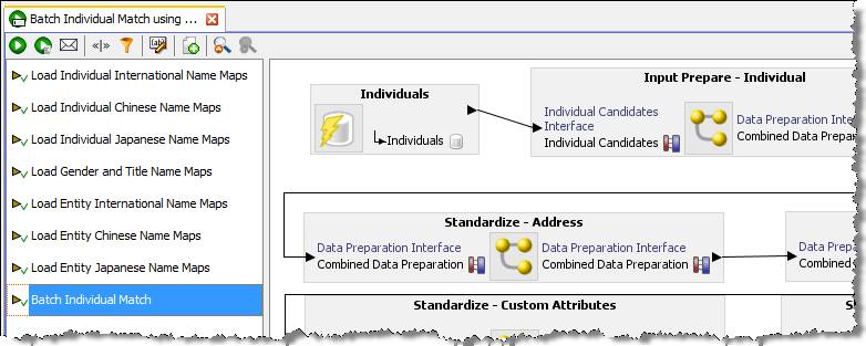

Create and configure a job to run matching as follows:
Create a copy of the Batch Individual Match job, rename it Batch Individual Match using Text File, and then open it.
Open the Individual Match job phase, change the source of the input data by double-clicking on the Individual Candidates and selecting the Individual Candidates mapping.
Click OK to apply the changes. The job configuration is modified accordingly and the old snapshot and staged data items are disconnected.
Delete the Individual Candidates snapshot task.
Drag the Individuals snapshot from the Snapshot in the Tool Palette into the open job phase and make sure it is connected to the Individual Candidates mapping.
Drag the Matches to File Out: Individual Matches export task from the Export in the Tool Palette into the open job phase and connect it to Match Results - Output.
Delete the Batch Matches export task.
Close the job and save the configuration changes.

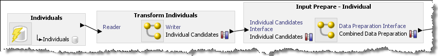

It may not always be possible to directly map the input source to the candidates interface if:
fields are of the wrong data type (for example, "Date of Birth" in a date field); or
fields need transforming to a compatible format/structure (for example, Individual names in a full name field).
If this is the case, then the input data should be run through a custom EDQ process to convert the data as appropriate as in the following example steps:
Ensure that no jobs are currently running.
Create a data store and snapshot for the input data as in steps and Step 2 and Step 3 from Using Stand-Alone Batch Matching.
In the EDQ-CDS project, right-click the Processes node in the Project Browser and select New Process... to open the New Process wizard.
Select the snapshot created in step Step 2 as the data source.
Click Next.
On the last page of the wizard, rename the process Transform Individuals, then click Finish button to create the process.

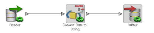

On the Process canvas, add the necessary processors to transform the data to the interface format. For example, use a Convert Date to String processor to convert a date of birth in date format to the required format for the Candidates interface (for example, either yyyyMMdd, MM/dd/yyyy, yyyy-MM-dd or dd-MMM-yy).
Add a Writer processor to the process canvas and connect it to the process data stream:
In the Writer Configuration dialog, select the Individual Candidates and map the attributes accordingly.
Create and configure a new job as follows:
Make a copy of Batch Individual Match job, renaming it Batch Transformed Individual Match.
Open the new job.
Double-click on the Individual Match job phase.
Use steps Step 9d- Step 10 of Using Stand-Alone Batch Macthing from step 9d onwards, adding in the new Transform Individuals process between the Individuals snapshot and the process Input - Prepare - Individual. The resulting job should look like the following:

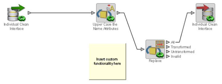

Using Cleaning Services
The cleaning processes provided with EDQ-CDS are provided as templates only, with the exception of the Address Cleaning process which is fully functional and uses EDQ-AV for address verification and standardization. The Individual and Entity cleaning processes are intended to be customized to meet the data standardization requirements of the implementation.
Customizing the Cleaning Services
The examples in the following sections demonstrate modifying the cleaning services provided with EDQ-CDS.

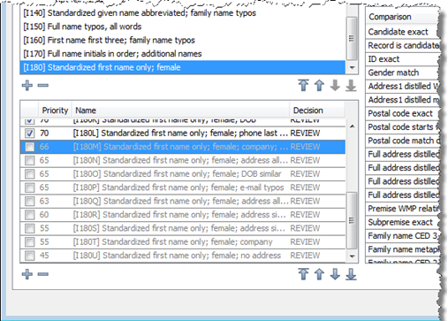

Disabling Rules with Lower Scores
The matchthreshold setting has been configured to have a value of 70, so all Match rules with a lower priority score will be disabled.
The following example steps show you how to disable Match rules for any Match process (for example, Match - Individual, Match - Entity or Match - Address):
In the EDQ-CDS project, open the Match process.
Double-click the Match processor to open the Match Configuration tab.
Double click the Match sub-processor icon to open the Match Configuration dialog.
Select the Match Rules tab and select the last Match group.
Clear the check box beside each Match rule with a Match Priority score lower than
70to disable it. -
Repeat for each Match group until all rules with a score less than
70have been disabled. -
Click OK to close the dialog.
Close the process and save the configuration changes.

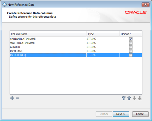

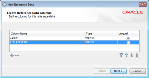

Stripping Words/Phrases from Name Fields
It is possible to customize the system to strip certain words and phrases from names that are deemed to be noise and/or add little information, and therefore may lead to potential missed matches.
Removing Noise from Individual Names
Name fields in customer data systems are often overfilled with additional (non-name) information, either because there are no other suitable fields available or due to errors made by Data Entry users. Common examples include "Fred SMITH (DO NOT CALL)" and "John DOE (DECEASED)". This extraneous information can be removed during name standardization when a "distilled" name is created for use in matching.
Use the following example steps to remove noise from individual names:
The Real-Time services will use the modified Reference Data sets the next time the full Real-time START ALL job (which re-snapshots the prepared Reference Data from files) is run.
To remove words and phrases from individual names in non-Latin scripts use the reference data Strip List – Individual Script Strip List Reference Data . This Reference Data set is used as a replacement map and should have a blank value in the second column.
Removing Noise from Entity Names
Noise words and phrases or common business words (including suffixes) in Entity names that add little value in matching can be removed during name standardization when a "distilled" name is created. An example of such a noise word is "International", which is often found in organization name fields.
Due to the high frequency of occurrence of this term it is often omitted or shortened when entering the name, which may lead to potential matches being missed. Therefore it may be more appropriate to remove the term and all known variants for the purposes of matching.
Use the following example steps to remove noise from entity names:
To remove words and phrases from entity names in non-Latin scripts use the Strip List – Entity Script Suffixes Reference Data.

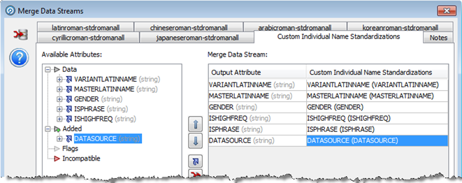

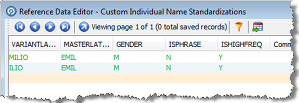

Changing Name Standardization
EDQ-CDS uses a name standardization technique in order to match name variants. It is supplied with a large collection of common name variants for various language domains. It is possible to customize these lists.
If a name standardization is changed or added, the subsequent results may be eliminated during Conflict Resolution. For further details, see Resolving Conflicts.

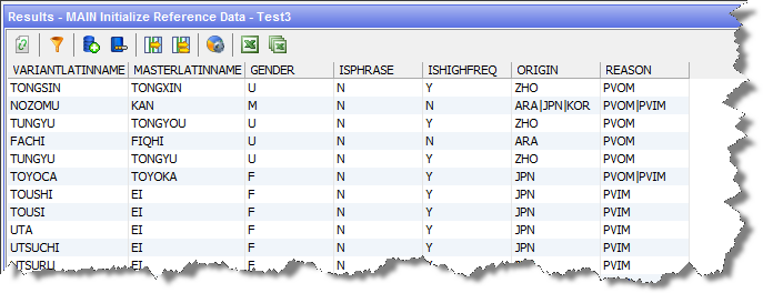

The Reason Codes are as follows:
PIV: The Primary record of a cluster of records (for example, the best Master identified for a set of equivalences) is also present as a variant to other Masters. All the instances where this Primary name is a variant are removed.
PVOM: The records that are variants of the current Primary are also variants of other Masters. All the records for these variants pointing to other Masters are removed.
PVIM: The records that are variants of the current Primary are also Masters to other variants. All the records where this variant is a Master are removed.
PIVCUTOFF: Whereas the other removals take place after identification of Primary clusters, there comes a time where it is not efficient to continue to identify the Primaries, and the remaining records where the Master name also exists as a variant have all the variant versions removed in a final cull of records that violate integrity.

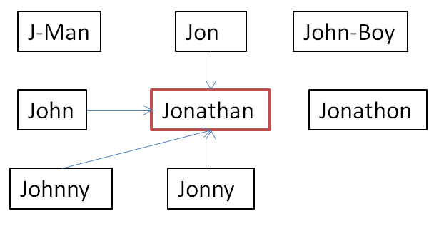

Expanding on the simple example given at the beginning of this section, let us assume that there are the following name standardization rules:
| Master | Primary |
J-MAN |
JON |
JOHN |
JONATHAN |
JOHNNY |
JONNY |
JON |
JOHN |
JON |
JONATHAN |
JON |
JOHN-BOY |
JONNY |
JONATHAN |
JONATHAN |
JONATHON |
JOHNNY |
JONATHAN |

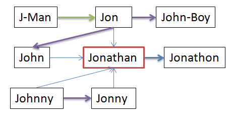

These rules contain a number of inherent conflicts. This is illustrated in the following diagram in which JONATHAN is identified as the Primary:
The arrows indicate the following:
| Arrow Type | Reason for Conflict |
N/A (No conflict exists) |
PIV |
PVIM |
PVOM |
The conflict resolution rules will discard the mappings that cause conflicts, as follows:
Resulting in the following mappings being created:
| Name | Primary |
JOHN |
JONATHAN |
JON |
JONATHAN |
JONNY |
JONATHAN |
JOHNNY |
JONATHAN |
