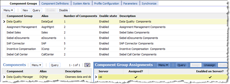

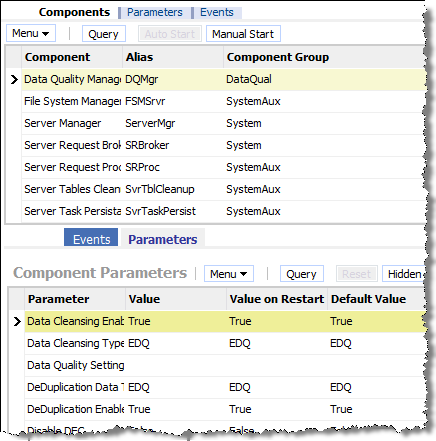

Data Quality Administration
To set the Data Quality Administration options, use the following procedure:

This completes the Siebel configuration. Restart the Siebel server to ensure that all the configuration changes have taken effect.

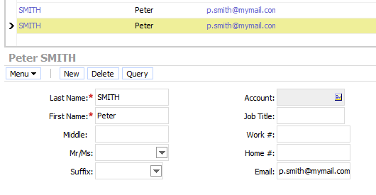

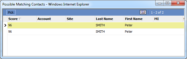

Testing Real-Time Contact Matching
To test the real-time matching service for Contact records:
- Check that real-time deduplication is enabled for the current user profile by checking that Tools > User Preferences > Data Quality > Enable DeDuplication is set to Yes.
- Set Administration - Data Quality > Data Quality Settings > Force User DeDupe - Contact to Yes.
- Enter a new Contact record with the same details as in Testing the Batch Matching Service.
- Save the record.
- Verify that the Possible Matching Contacts dialog is displayed showing matches against the two contact records created previously.
An exact name and email match, as in this example, will only match if is being used for key generation (for Siebel 8.1.1.10 or later), or if the Query and Token expressions used for key generation have been adjusted to use only name, or name and email, attributes.
