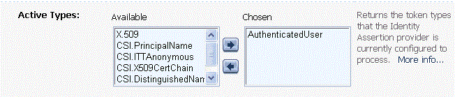

How to Make New Token Types Available for Identity Assertion Provider Configurations
When you or an administrator configure a custom identity assertion provider (see Configure the Custom Identity Assertion Provider), the Supported Types field displays a list of the token types that the identity assertion provider supports. You enter one of the supported types in the Active Types field, as shown in Figure 4-1.
Figure 4-1 Configuring the Sample Identity Assertion Provider
Description of "Figure 4-1 Configuring the Sample Identity Assertion Provider"
The content for the Supported Types field is obtained from the SupportedTypes attribute of the MBean Definition File (MDF), which you use to generate your custom identity assertion provider's MBean type. An example from the sample identity assertion provider is shown in Example 4-2. (See Generate an MBean Type Using the WebLogic MBeanMaker.)
Example 4-2 SampleIdentityAsserter MDF: SupportedTypes Attribute
<MBeanType> ... <MBeanAttribute Name = "SupportedTypes" Type = "java.lang.String[]" Writeable = "false" Default = "new String[] {"SamplePerimeterAtnToken"}" /> ... </MBeanType>
Similarly, the content for the Active Types field is obtained from the ActiveTypes attribute of the MBean Definition File (MDF). You or an administrator can default the ActiveTypes attribute in the MDF so that it does not have to be set manually with the WebLogic Remote Console. An example from the sample identity assertion provider is shown in Example 4-3.
Example 4-3 SampleIdentityAsserter MDF: ActiveTypes Attribute with Default
<MBeanAttribute Name= "ActiveTypes" Type= "java.lang.String[]" Default = "new String[] { "SamplePerimeterAtnToken" }" />
While defaulting the ActiveTypes attribute is convenient, you should only do this if no other identity assertion provider will ever validate that token type. Otherwise, it would be easy to configure an invalid security realm (where more than one identity assertion provider attempts to validate the same token type). Best practice dictates that all MDFs for identity assertion providers turn off the token type by default; then an administrator can manually make the token type active by configuring the identity assertion provider that validates it.
If an identity assertion provider is not developed and configured to validate and accept a token type, the authentication process will fail. For more information about configuring an identity assertion provider, see Configure the Custom Identity Assertion Provider.

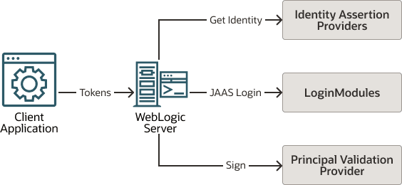

The Identity Assertion Process
In perimeter authentication, a system outside of WebLogic Server establishes trust via tokens (as opposed to the type of authentication described in The Authentication Process, where WebLogic Server establishes trust via usernames and passwords). Identity assertion providers are used as part of perimeter authentication process, which works as follows (see Figure 4-2):
                        A token from outside of WebLogic Server is passed to an identity assertion provider that is responsible for validating tokens of that type and that is configured as active.
                        If the token is successfully validated, the identity assertion provider maps the token to a WebLogic Server username, and sends that username back to WebLogic Server, which then continues the authentication process as described in The Authentication Process. Specifically, the username is sent via a Java Authentication and Authorization Service (JAAS) CallbackHandlerand passed to each configured authentication provider's LoginModule, so that the LoginModule can populate the subject with the appropriate principals.
As Figure 4-2 also shows, perimeter authentication requires the same components as the authentication process described in The Authentication Process, but also adds an identity assertion provider.
