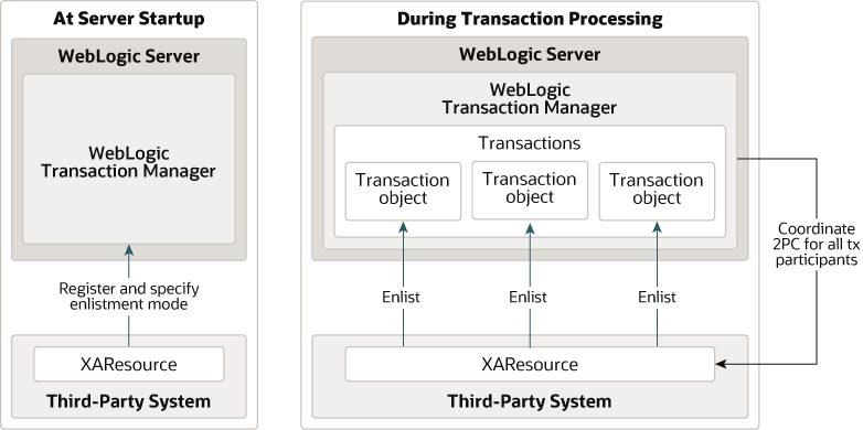

During transaction processing, you must enlist the XAResource object of the third-party system with each applicable transaction object.
Figure 13-1 shows the process for third-party systems to participate in transactions coordinated by the WebLogic Server transaction manager.
Figure 13-1 Distributed Transactions with Third-Party Participants
Description of "Figure 13-1 Distributed Transactions with Third-Party Participants"
Depending on the enlistment mode that you use when you enlist an XAResource object with a transaction, WebLogic Server may automatically delist the XAResource object at the appropriate time. For more information about enlistment and delistment, see Enlisting and Delisting an XAResource in a Transaction. For more information about registering XAResource objects with the WebLogic Server transaction manager, see Registering an XAReosurce to Participate in Transactions.

Additional Documentation about JTA
Additional documentation for a connection-based Resource Usage scenario, which illustrates the JTA interaction between the transaction manager and resource manager is provided in the JTA specification.
Refer to the JTA specification 1.0.1B Section 4.1 for a connection-based Resource Usage scenario, which illustrates the JTA interaction between the transaction manager and resource manager. The JTA specification is available at http://www.oracle.com/technetwork/java/javaee/jta/index.html.
