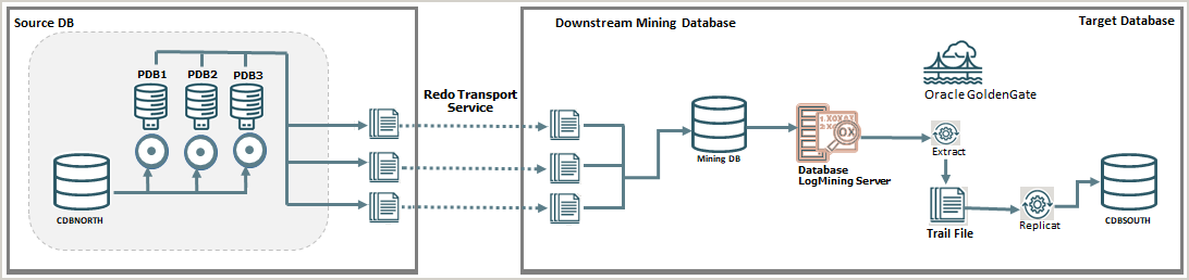

In a typical downstream deployment, the source database, where changes are made to the data, will ship it's redo logs or archive logs to a mining database where the Extract process will mine the redo logs and write out the trail files. In the following diagram, CDBNORTH is the source database and CDBSOUTH is the target database. There is a mining database between the source and target with the database logmining server that transfers redo logs from the downstream Extract to the target.
Workflow between source multitenant container database and a downstream database with logmining server.
