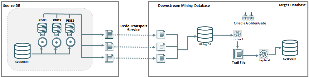

In a typical downstream deployment, the source database, where changes are made to the data, will ship it's redo logs or archive logs to a mining database where the Extract process will mine the redo logs and write out the trail files. Downstream Extract can also be used in situations where Oracle GoldenGate cannot establish a connection with the source database. In the following diagram, CDBNORTH is the source database and CDBSOUTH is the target database. There is a mining database between the source and target with the database logmining server that transfers redo logs from the downstream Extract to the target.
Workflow between source multitenant container database and a downstream database with logmining server.

If a connection to the source database is not possible, GoldenGate can be configured to use an Active Data Guard (ADG) standby database. The standby database is available for read-only connections to perform metadata queries and fetching. In this section, you will learn how to configure a Downstream Extract using ADG and without establishing a connection with the source database.
Enable Downstream Extract to Work with ADG
In a cascaded downstream capture environment, the downstream database does not connect directly to the source database. It uses the Active Data Guard (ADG) for fetching and metadata queries.
Extract must be started using the sourceless option so that it does not connect to the source database and instead connects to ADG using FETCHUSERID or FETCHUSERIDALIAS when it needs to fetch any non-native datatypes. For example, FETCH operations are processed on the ADG database as this instance is open in read-only mode. Other operations that cannot be processed on the ADG instance, such as creating the dictionary build, are redirected from the ADG to the source database.
When registering a downstream Extract, Oracle GoldenGate connects to ADG as source database instead of the database where the redo originates. ADG redirection is supported for the following commands and parameters:

Here are the steps to enable downstream Extract to work with ADG Standby:
  1. Add an additional LOG_ARCHIVE_DESTINATION_N (LAD) on the ADG standby, as shown in the following example:
    ALTER SYSTEM SET LOG_ARCHIVE_DEST_3='service=mining_db_service_name ASYNC NOREGISTER VALID_FOR(STANDBY_LOGFILES,STANDBY_ROLES) DB_UNIQUE_NAME=3rd_db_unique_name' scope=both
    This step transports and generates the standby_logfiles for an ADG standby.
  2. Set the LOG_ARCHIVE_CONFIG on the ADG standby to ship the logs to the mining database, as shown in the following example:
    ALTER SYSTEM SET LOG_ARCHIVE_CONFIG = 'DG_CONFIG' = (CDBNORTH, cdbADG_src, cdbDSC)';
    DB_CONFIG is the database unique name of the first, second, and third databases.
  3. On the mining database, set up the location to store the incoming standby_logfiles on the mining database as shown in the following example:
    ALTER SYSTEM SET LOG_ARCHIVE_DEST_2='location= /home/arc_dest/dstrm VALID_FOR=(STANDBY_LOGFILE,ALL_ROLES)' scope=both
    where /home/arc_dest/dstrm is the location for foreign archive logs. Do not use FRA for storing foreign archive logs.
  4. Run LOG_ARCHIVE_CONFIG on the mining database, so that the Extract process is able to read them on the mining database, as shown in the following example:
    ALTER SYSTEM SET LOG_ARCHIVE_CONFIG ='DG_CONFIG' scope=both
    Here, DB_CONFIG is the database unique name of the first, second, and third databases.
  5. For a downstream Extract, you need to ensure that the database connections are appropriately configured. When registering the Extract, make sure that DBLOGIN connection is made to the ADG Standby, that is open for read-only activity.
  6. To add the Extract and register it, use the following command:
    DBLOGIN USERID ggadmin@cdbADG_src, PASSWORD ggadmin
    MININGDBLOGIN USERID ggadmin@cgg_cdbDSC, password ggadmin
    cdbADG_src is the ADG not primary.
    cgg_cdbDSC is the mining database.
  7. Now, register an Extract that uses the NOUSERID parameter:
    ADD EXTRACT exte, INTEGRATED TRANLOG, BEGIN NOW REGISTER EXTRACT exte DATABASE
  8. After the Extract is registered, you can use this Extract to mine data and start the Extract normally.
