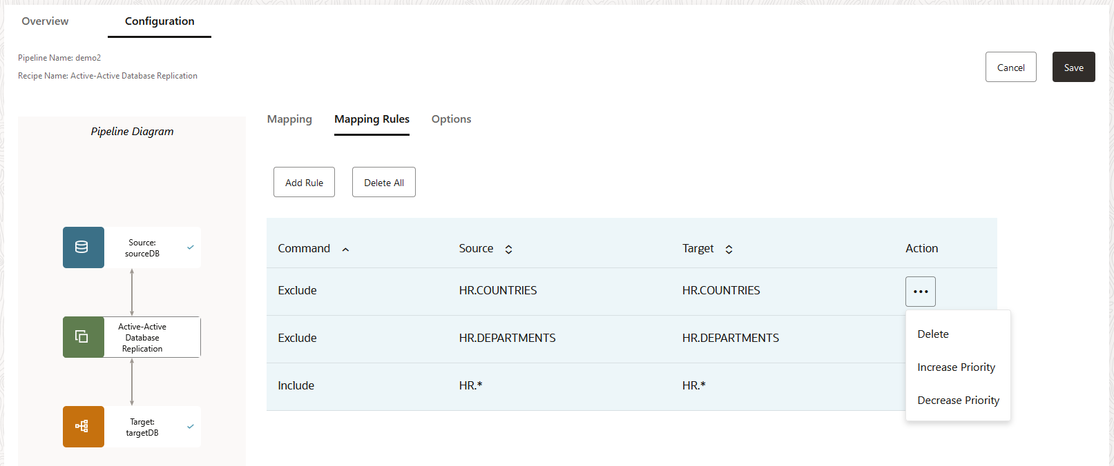

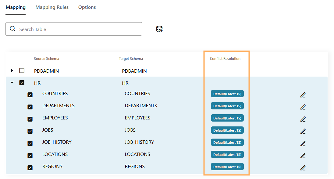

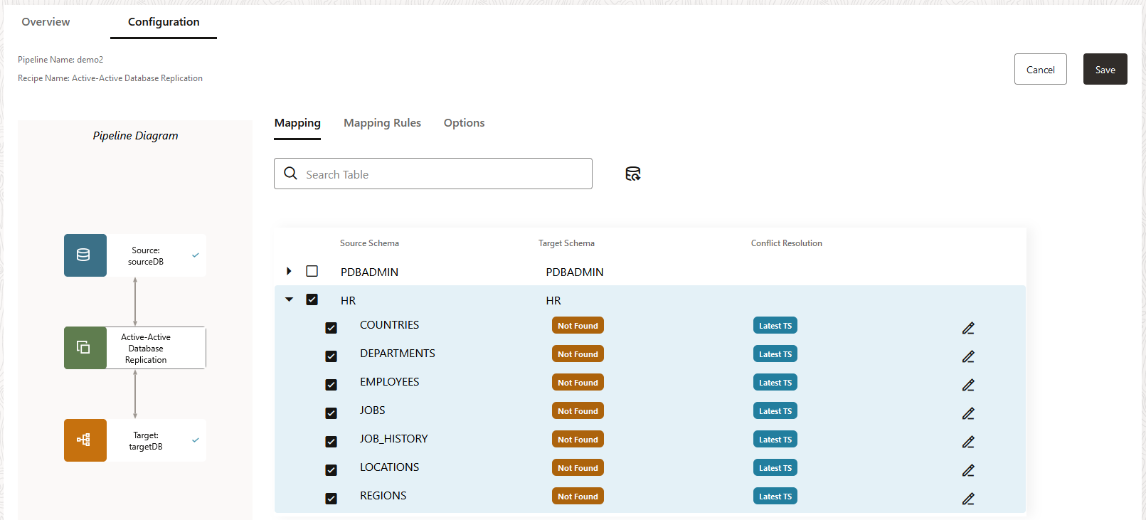

Ensure that you have a source and target connection before creating a pipeline.Configure a pipeline
After you create a pipeline, you're brought to its Configuration screen. If you're revisiting a pipeline after you created it, you can select the pipeline from the Pipelines page to view its details, and then click Configuration to return to the Configuration screen.
