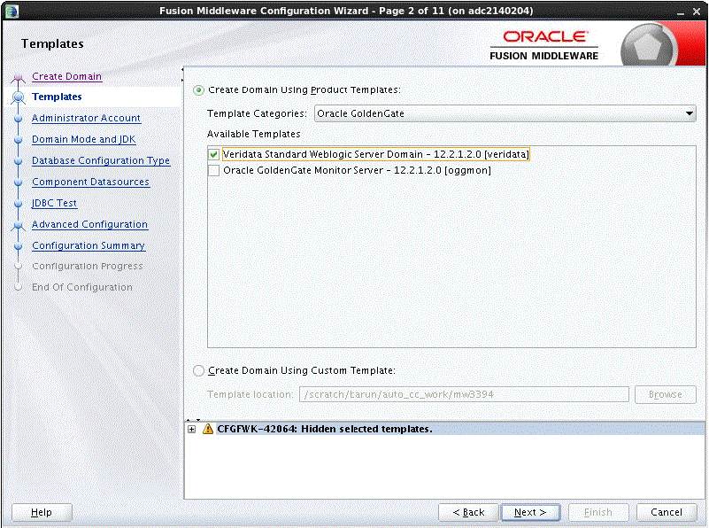

- Task 2 Selecting the Configuration Templates
On the Templates screen, make sure Create Domain Using Product Templates is selected, then select Oracle GoldenGate from the Template Categories. The following templates are selected:
Veridata Standard WebLogic Server Domain - 12.2.1.2.0 [veridata]
Selecting this template automatically selects the following as dependencies:
Oracle JRF - 12.2.1.2.0 [oracle_common]
WebLogic Coherence Cluster Extension - 12.2.1.2.0 [wlserver]
Tip:
More information about the options on this screen can be found in Creating WebLogic Domains Using the Configuration Wizard Templates in the Oracle Fusion Middleware Creating WebLogic Domains Using the Configuration Wizard Guide.

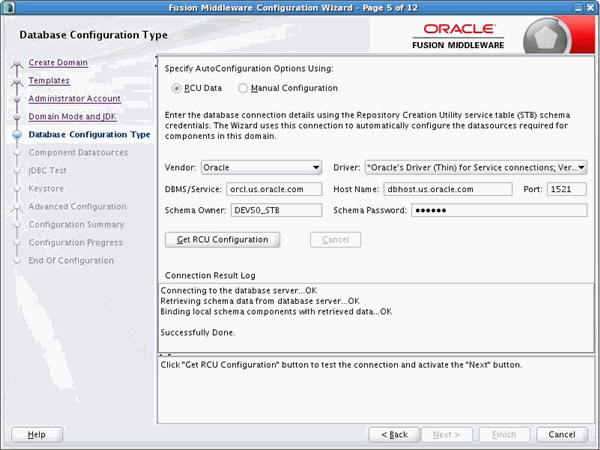

- Task 5 Specifying the Datasource Configuration Type
Select RCU Data to activate the fields on this screen. The RCU Data option instructs the Configuration Wizard to connect to the database and Service Table (STB) schema to automatically retrieve schema information for the schemas needed to configure the domain.
If you choose to select Manual Configuration on this screen, you will have to manually fill in the parameters for your schema on the JDBC Component Schema screen.
After selecting RCU Data, specify the database connection details in the following fields:
Field Description DBMS/Service
Enter the database DBMS name, or service name if you selected a service type driver.
Host Name
Enter the name of the server hosting the database.
Port
Enter the port number on which the database listens.
Schema Owner
Schema Password
Enter the username and password for connecting to the database's Service Table schema. This is the schema username and password that was specified for the Service Table component on the "Schema Passwords" screen in RCU (see Creating the Database Schema).
The default username is
prefix_STB, whereprefixis the custom prefix that you defined in RCU.Click Get RCU Configuration when you are finished specifying the database connection information. The following output in the Connection Result Log indicates that the operation succeeded:
Connecting to the database server...OK Retrieving schema data from database server...OK Binding local schema components with retrieved data...OK Successfully Done.
Tip:
More information about the RCU Data option can be found in About the Service Table Schema in the Oracle Fusion Middleware Creating Schemas with the Repository Creation Utility Guide.
More information about the other options on this screen can be found in Database Configuration Type in the Oracle Fusion Middleware Creating WebLogic Domains Using the Configuration Wizard

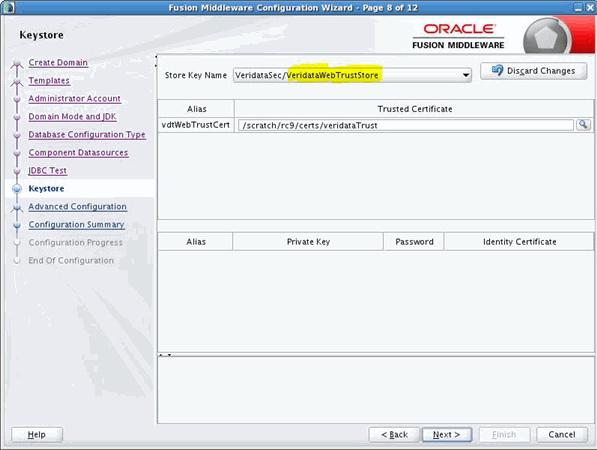

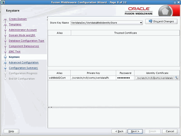

- Task 8 Specifying Keystore Details
Use the Keystore screen to specify the path to the trusted certificate for each keystore. You can also specify the path to each keystore's private key, the password for the private key and the path to the Identity Certificate for the private key.
To select an Identity certificate, select the Identity keystore name from the Store Key Name drop down list and specify the paths to the private key and the identity certificate.
When you select the Trust Store from the Store Key Name drop-down list, the path to the sample certificate provided with the Veridata installation is displayed by default. You can specify the path to your trusted certificate on this page.
