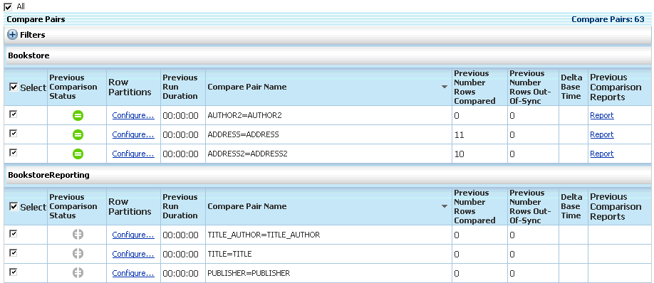

3.3.2 How groups are shown on the Run/Execute Job page
In this example, there are two groups: Bookstore and BookstoreReporting:
