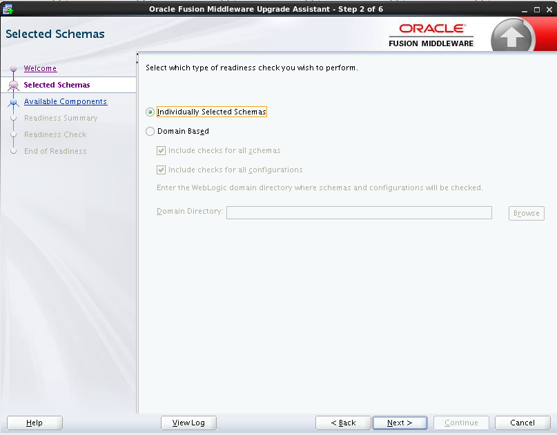

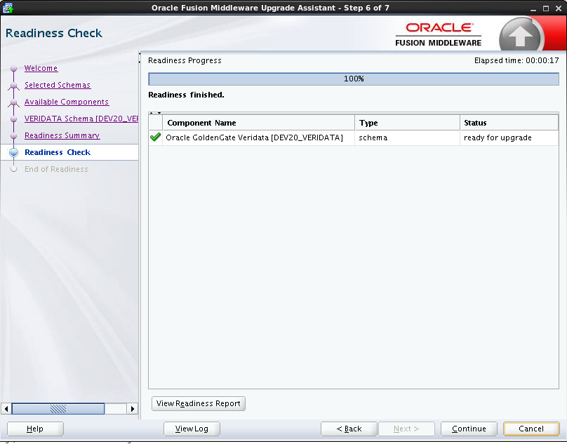

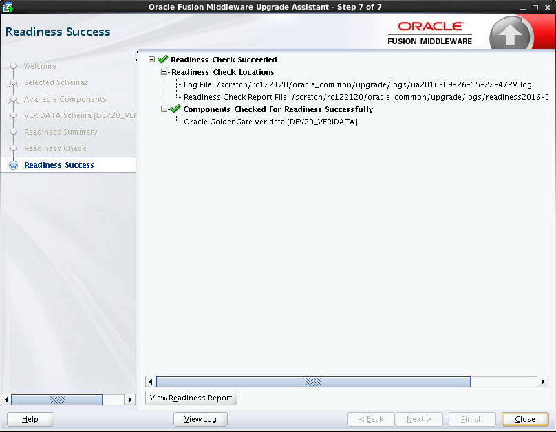

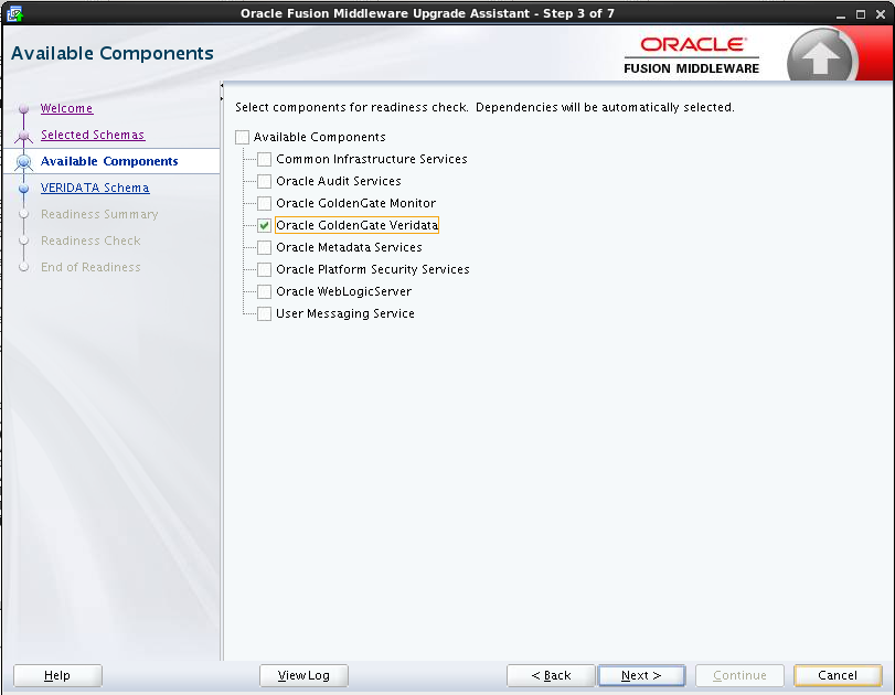

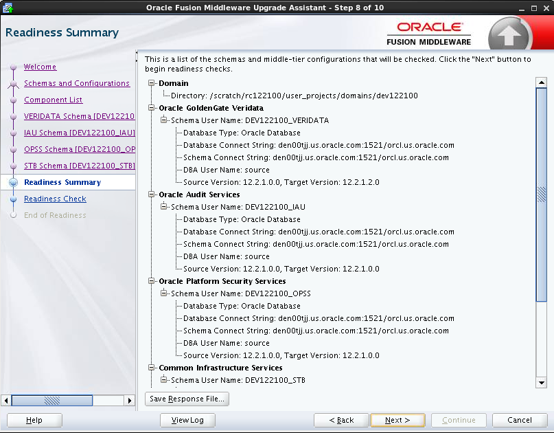

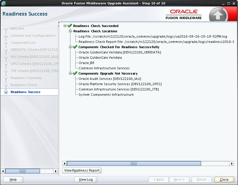

Readiness Check for Veridata
Oracle recommends that you run a readiness check before starting the upgrade process to identify potential issues with the upgrade. The readiness check may not be able to discover all potential issues with your upgrade. It is possible that an upgrade may still fail, even if readiness check reports success.

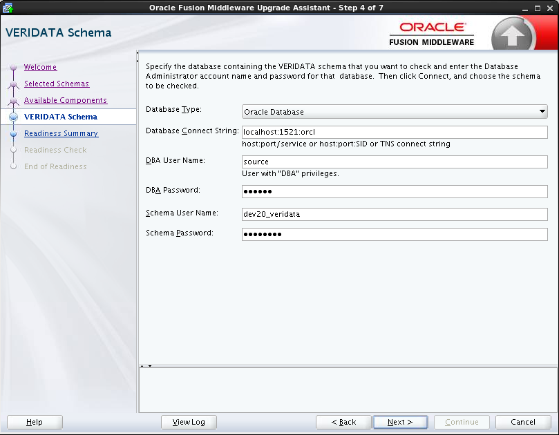

Readiness Check for 11g and 12.1.3 Compact Domain
Schema Readiness is supported for 11g and 12.1.3 compact domain versions.
To run Readiness Check for 11g and 12.1.3 follow the instructions below:
To troubleshoot issues that might occur during Readiness Check, review the logs.

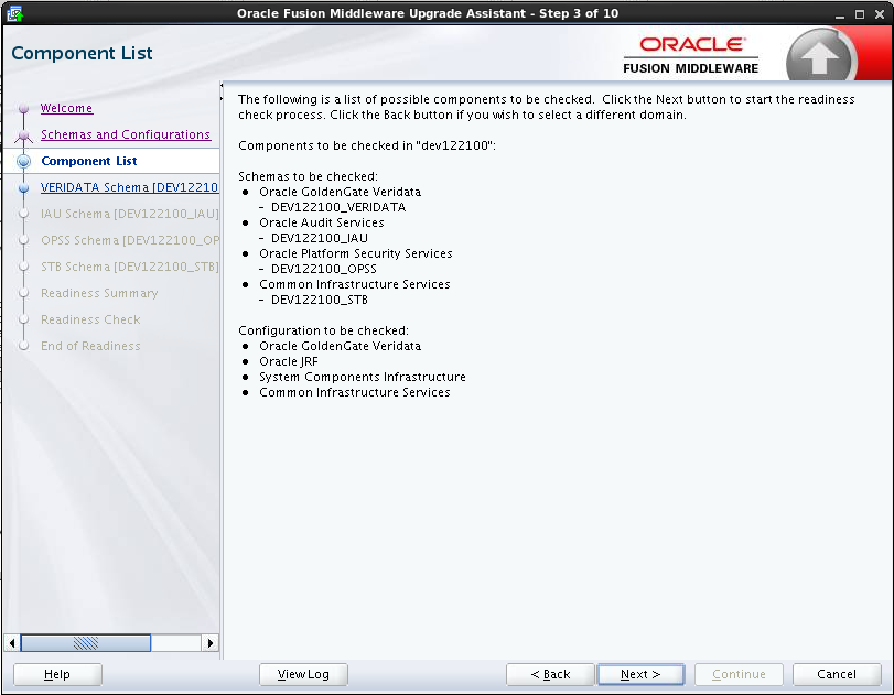

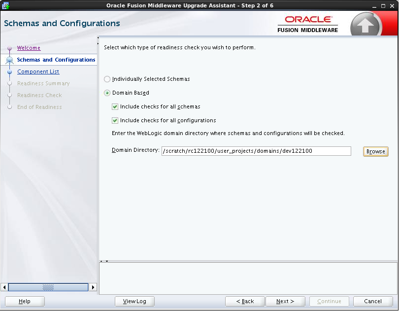

Readiness Check for 12.1.3 expanded domain and 12.2.1.0.0
Schema and configuration Readiness is supported for 12.1.3 expanded domain and 12.2.1.0.0 domain versions.
To run Readiness Check for 12.1.3 expanded domain and 12.2.1.0.0 follow the instructions below:
