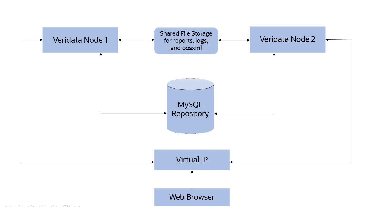

High Availability (HA) refers to the ability of a system, application, or services to remain operational and accessible with minimal downtime. It ensures that an application continues to function even in the event of failures, such as hardware crashes, network issues, or software bugs. You can configure High Availability for the Oracle GoldenGate Veridata Server and Agent in several ways. This article explains one such method.
Figure 7-1 High Availability for Veridata Server
To establish High Availability in Oracle GoldenGate Veridata 23c:
  1. Deploy Veridata Server on the nodes that share a Virtual IP between them.
  2. Connect to Veridata Server using a VIP to establish an Active-Passive setup. In such a set up, even when one Server node goes down, the other node serves the purpose.
Ensure that there is a shared file system for storing the logs, reports, and oosxml files from the active server, so that when the Standby server turns active it can have access to all the files.
For the MySQL repository, ensure that the repository is highly available.
7.1.1 Setting Up the High Availability for Oracle GoldenGate Veridata Server 23c
To set up HA for Veridata Server 23c:
  1. Install Veridata Server on all the nodes which share a common Virtual IP between them.
  2. Ensure that all nodes use the same port for Veridata Server.
  3. Edit the repository.url property in <veridata_home>/config/oggvdt_cainput.properties file, to ensure that both the servers point to the same shared repository.
  4. For more information about Oracle GoldenGate Veridata installation, see Installing and Running Oracle GoldenGate Veridata.

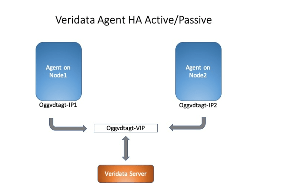

7.1.3 Setting up High Availability for Oracle GoldenGate Veridata Agent
In Oracle GoldenGate Veridata, the agent is deployed as a Java Standalone application. To establish agent HA, deploy the agent on nodes sharing a Virtual IP (VIP) between them and then connect the Veridata Server to agent via VIP.
Ensure that agents running on different nodes are using the same port number. The agent.propreties from node1 must be copied to node2 as well and must be kept in sync for the changes.
