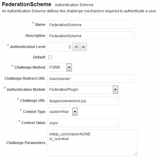

33.2.1 About the FederationScheme Authentication Scheme
FederationScheme is a general-purpose scheme for use with Identity Federation 11g Release 2 (11.1.2.2).
Figure 33-1 shows the Access Console page for FederationScheme:.
Table 33-1 describes the FederationScheme.
Table 33-1 FederationScheme Element Definitions
| Element | Description |
Name |
This is the scheme name. |
Description |
This is a brief description of the scheme. |
Authentication Level |
This is the trust level of the authentication scheme. |
Default |
This is a non-editable box that is checked when the Set as Default button is clicked. |
Challenge Method |
You may select a challenge method from those available in the drop-down box. |
Challenge Redirect URL |
This is the URL of another server to which user requests must be redirected for processing. |
Authentication Module |
This is the authentication module to use with the scheme. |
Challenge URL |
This is the URL to which the credential collector will redirect for credential collection. Not used by the federation plug-in. |
Context Type |
This element is used to build the final URL for the credential collector. |
Context Value |
This element is used to build the final URL for the credential collector. The value depends on the context type. |
Challenge Parameters |
This is the list of parameters, if any, to use with the challenge. |
Table 22-23 lists the specifications for FederationScheme.

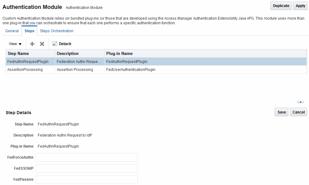

33.2.3 About the FederationPlugin Authentication Module
The FederationPlugin provides a custom authentication module.
Figure 33-2 displays the module's Console page.
Table 33-2 describes the attributes that you need to configure the FederationPlugin.
Table 33-2 FederationPlugin Steps
Step Name |
This is the name of the step within the module. |
Description |
This element contains a brief description of the step. |
Plugin Name |
This element specifies the plugin associated with the step. |
The value of FedSSOIdP is the IDP to be picked up by the authentication plugin.
Orchestration enables you to specify the order of the steps within the plugin, and what to do if each of those steps succeeds or fails.

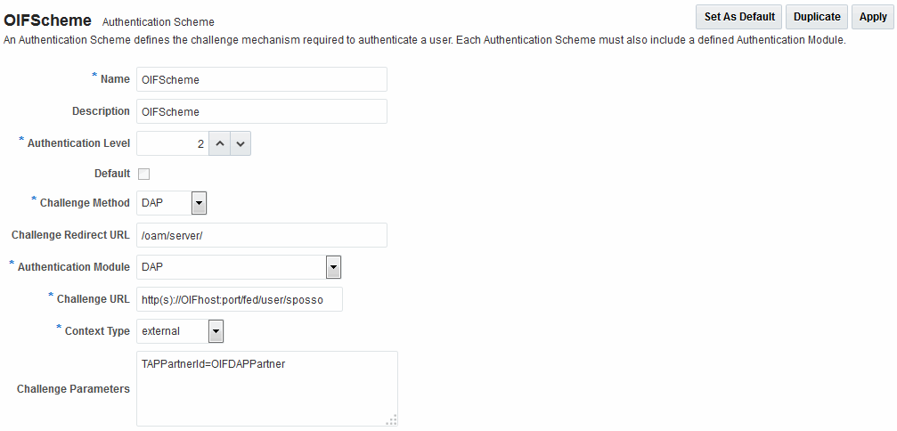

33.3.1 About Scheme OIFScheme
OIFScheme and OIFMTScheme are used for
integration with Oracle Identity Federation.
See Using Authentication Schemes and Modules for Identity Federation for the schemes available with Identity Federation.
Table 33-4 describes the scheme OIFScheme.
Table 33-4 OIFScheme Definition
Name |
Description |
Default |
Challenge Method |
Use to select a challenge method from those available in the drop-down box. |
Challenge URL |
This is the URL the credential collector will redirect to for credential collection. |
Context Type |
Use this element to build the final URL for the credential collector. |
Table 22-23 for OIFScheme specifications.

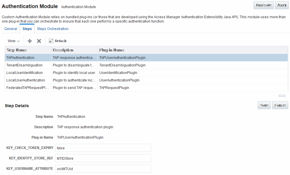

33.3.2 About the OIFMTLDAPPlugin Authentication Module
The OIFMTLDAPPlugin module authenticates federated tenants through Identity Federation and non-federated tenants with the identity store associated with Access Manager.
Table 33-5 lists the steps for OIFMTLDAPPlugin.
Table 33-5 IFMTLDAPPlugin Steps
Step Name |
Description |
This element contains a brief description of this step. |
Plugin Name |
This element specifies the plugin associated with this step. |
Plugin Parameters |
This element lists the parameters, if any, needed for plugin execution. The parameter list varies with the plugin. |

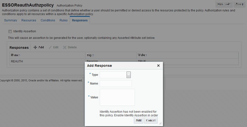

Figure 33-7 shows the Response configuration tab for an authorization policy:
Figure 33-7 Authorization Policy Response Tab
Description of "Figure 33-7 Authorization Policy Response Tab"
Table 33-6 describes the elements for a policy response.
Table 33-6 Policy Response Elements
Name |
This is a unique name to distinguish this response from other responses that use the same mechanism (type). |
Type |
This is the mechanism used to convey the response form of the action to be taken with the value string. Select Assertion Attribute. |
Value |
This is the response expression, set as a variable. To provide the federation data as response attributes in the authentication or authorization policy, the values can reference:

33.4.2.3 Viewing or Configuring Responses with Assertion Attributes
To view or configure responses with assertion attributes:
Figure 33-8 shows an example of federation response attribute configuration.
Figure 33-8 Adding a Federation Response Attribute to an AuthZ Policy
Description of "Figure 33-8 Adding a Federation Response Attribute to an AuthZ Policy"
